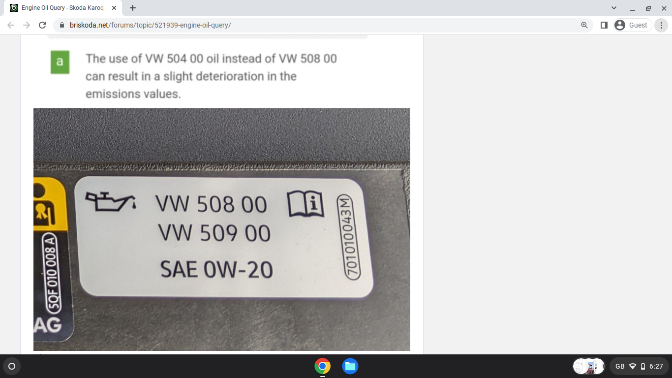

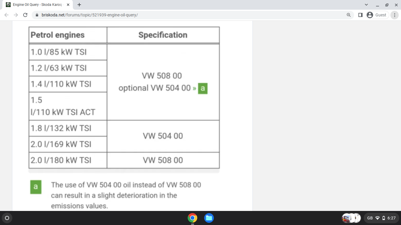

@Grc The Skoda / VW recommended oil for your 1.5TSI ACT is to VW508 00 / 509 00 so 0w 20 FS IV.
The oil recommended earlier than 2018 and pre WLTP testing was to VW504 00 / 507 00 so 0w 30 FS III or 5w 30 FS III.
Other members with a 2017 TDI might have one that was still recommended to use VW507 00 (Long Life) for fixed or Variable services, and still were in 2018 on. Not relevant to your 1.5 TSI ACT.
Not that the 5W 30 FS III will harm your engine. Just it is not what the Manufacturers of the car recommended or filled at the factory.
