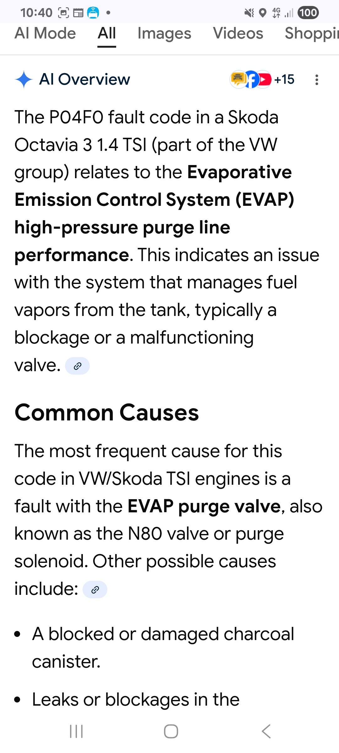

I've missed the F off the end its P040F
Quick Google came up with :
Edited by Brian15
X

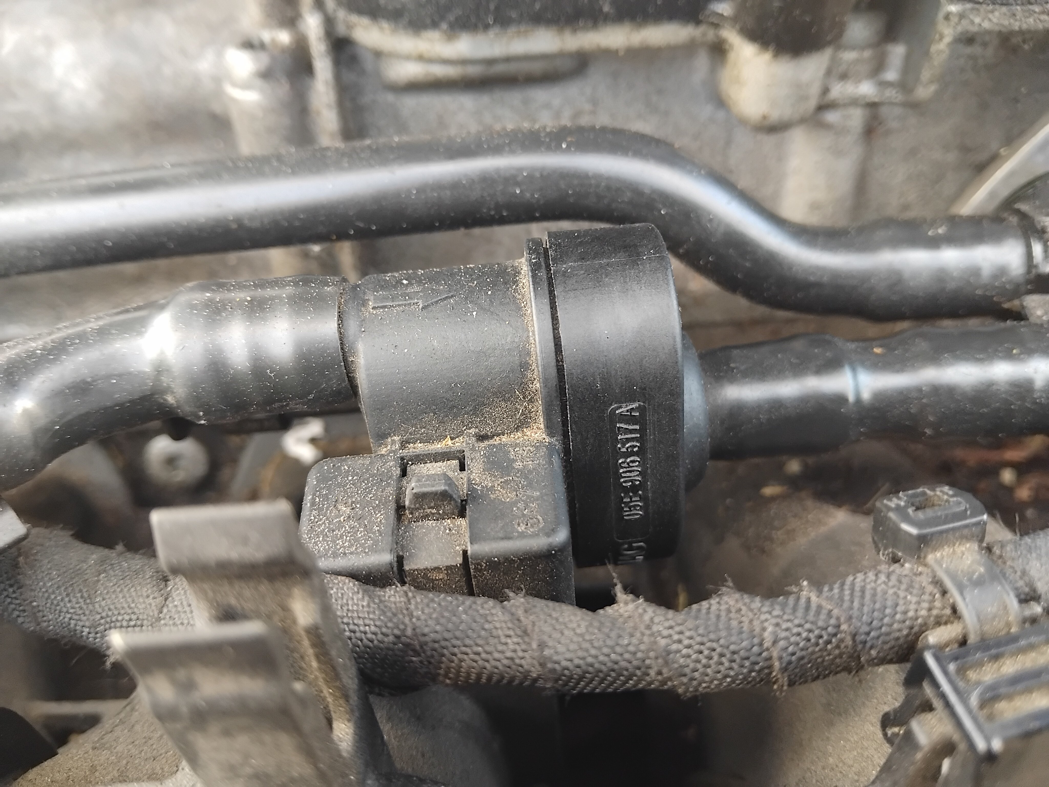

Yep I think so but cant quite read part number. Google part number on it and see what comes up. Check that there are no splits in the pipes first before replacing.
Alasdair
Alasdair
Part number is 05E 906 517 A
But I can't for the life of me find the part anywhere
I cant find any either . Are you sure its 05E not 06E?
Alasdair
Alasdair
Don't think it matters, EML has just gone off !
