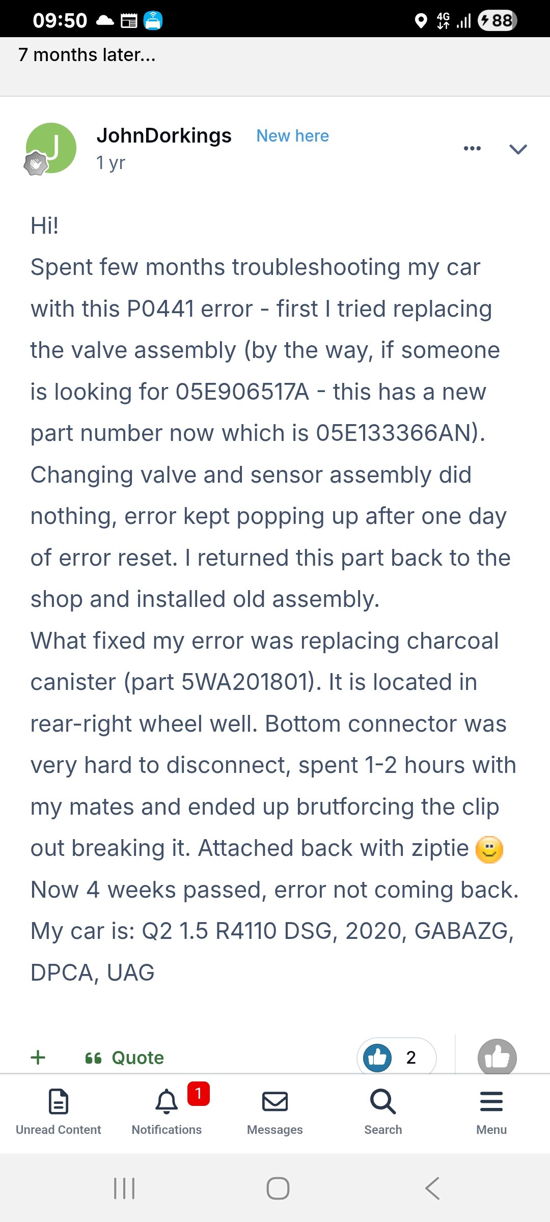

Did find 05E 906 517 B on LLL parts but nothing for 05E906517A Its for a tiguan. Just wondering if someone has replaced it with a different part previously. May have to go to Skoda with vin etc and ask them.

I'd payed £115 for the charcoal box last night as I thought it was likely to be that due to me regularly overfilling 🙄
Probably will still get it changed though
