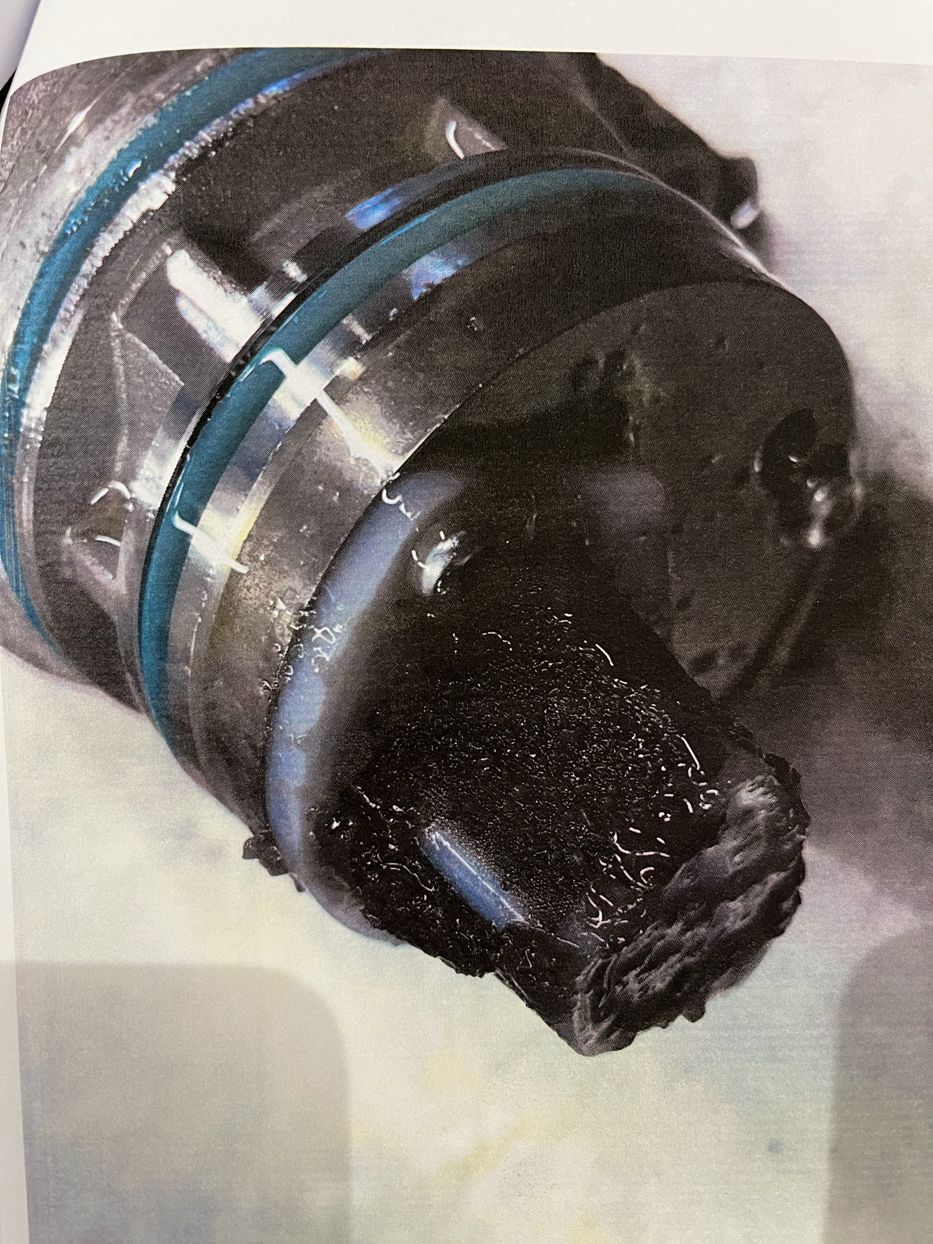

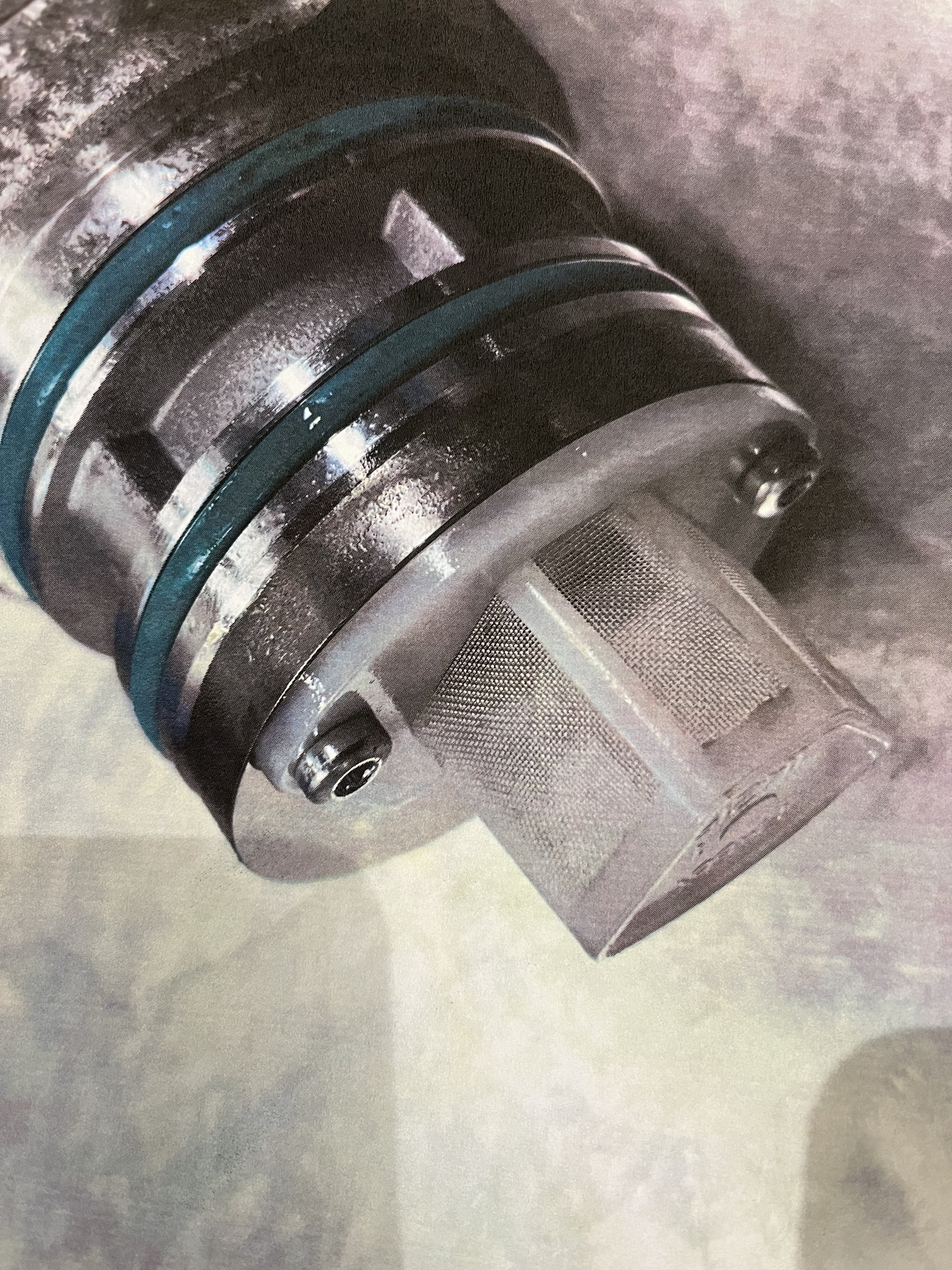

VAQ front diffs are @2 years / 20,000. Changed from @ 3 years / 30,000 or never tell the owner.
Nice if now they service the Haldex Properly and not just more often do half the job.
Makes maintenance / servicing damn expensive.
BUT, stuffs them up. Greedy Barstewards.

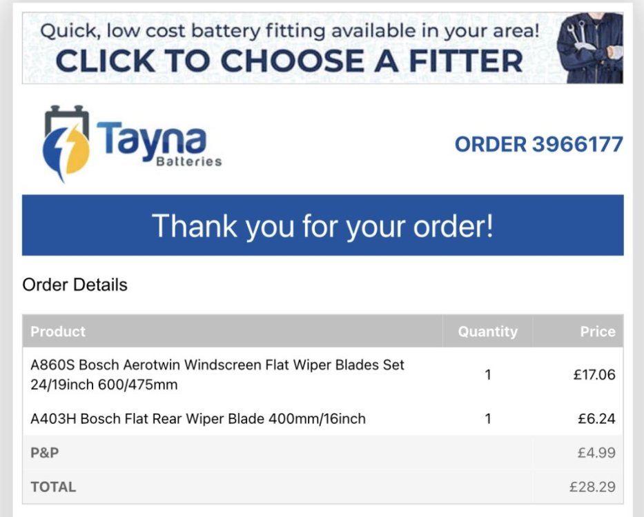

@nicknorman you’re not tied to any dealer. If you’re not happy then have a look around for alternatives.
For wipers ask them how much they’ll charge and compare to Bosch from ECP etc.
But someone had the genius idea of getting the Arteon version which is slightly longer so you clear more of the screen.
This is the part number for front and rear and how much they were from Tayna which was the best price I could find at the time.
I found I had to trim a tiny bit of the clip down but once I realised which bit it was easy.

Thanks for the wiper tip, I might get one. A rear one, because there i nothing wrong with the front ones.

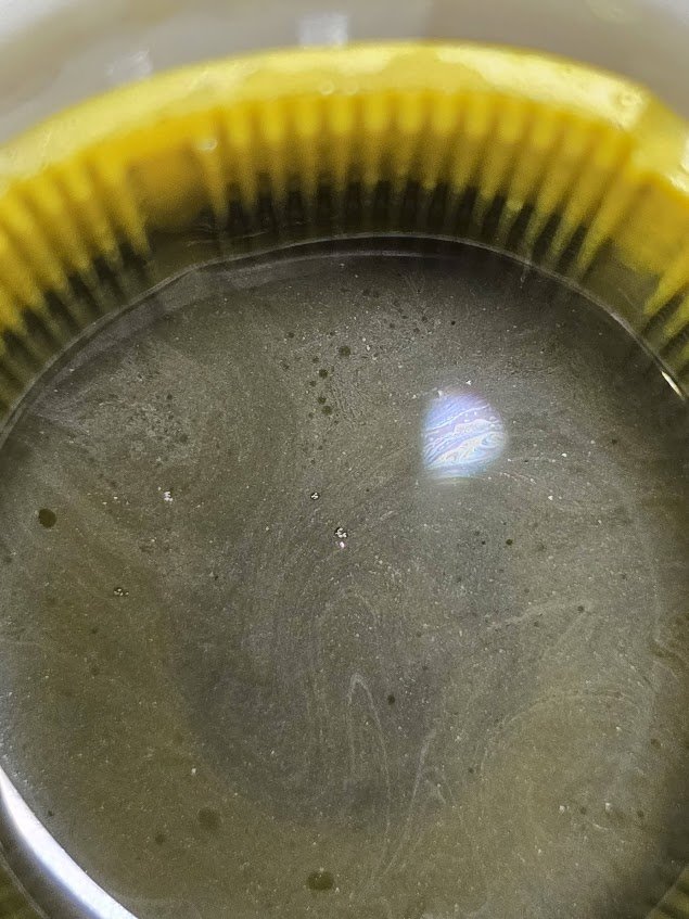

but, nowadays cars are heavier, faster, brake much intensive, fluid is getting hotter, summer temperature in central europe is "normally" +35°C, brake rotors are bigger. there are lot of reasons why properly mantain brake system. its one of most important system and always had to be 100% functional.
changing engine oil is matter of wish but changing rotors, pads, fluid, pipes are the matter of law and security.
look i buyed 5yo karoq and braking fluid was NEVER changed. i posted picture but heres too.
i have hygrometer fow dot oils, and it always shows less than 1% of water in fluid which is acceptable.
but dont wait for that. change it regularly, 2 years no matter of mileage, because this oil is getting old in not opened canister too.
opened canster should be used within 1 year..
do your brakes, think about your safety, and of people behind you and in front of you.
look at this brake fluid. 5yo.
