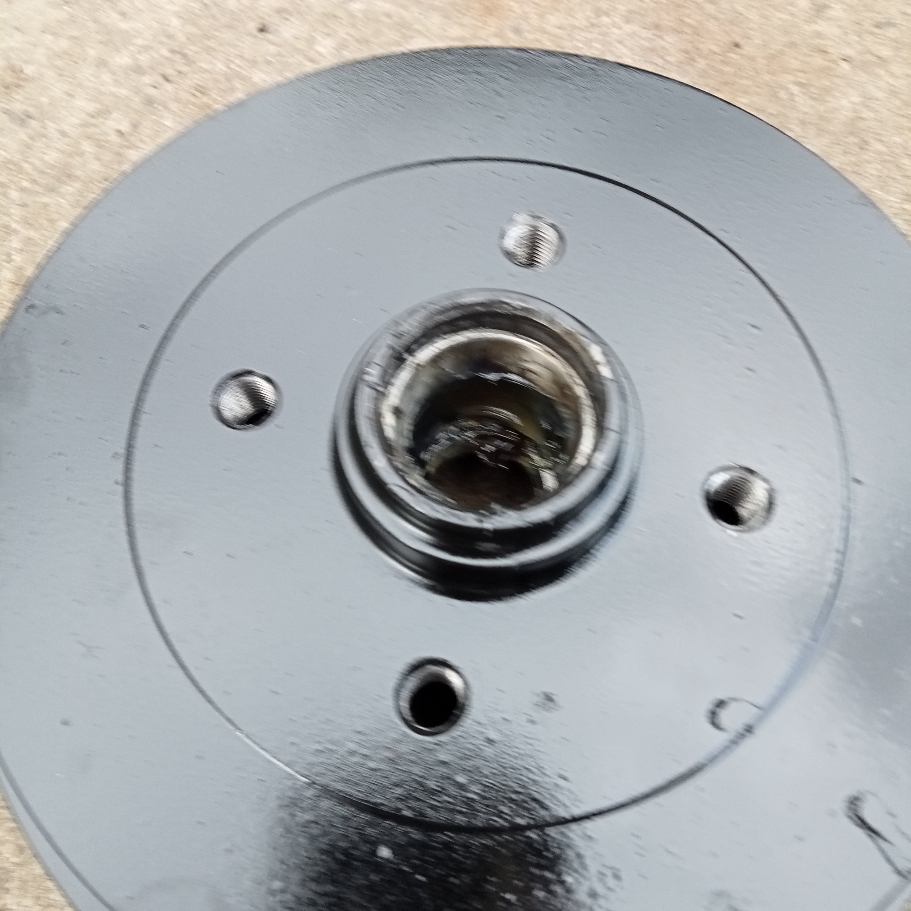

So changed plenty of bearings on the rear of the felicia, and they always have the cavity between the 2 sets of bearings packed with grease. Now I have also always done this aswell because it's how the first set I did were done. (Monkey see monkey do)
But I can't see any real need for it as seen as there are no friction surfaces in there, it seems a waste of grease.
My only thoughts are that it helps cool the bearings, or if they do get hot due to lack of lubrication it would melt into the bearings.
Any thoughts, how does skoda recommend lubricating the bearings?
The bearing cap tends to have the same treatment aswell, although I haven't bothered putting grease in there.

Grease moves about and when it gets hot it will liquify to a degree. Its better to have the internal cavity packed cause if you dont if it flows out it will settle there letting your bearing run dry. You need to pack them as tightly as you can everywhere. In fact some end covers are spring pressurised to always keep positive grease pressure for this exact reason.
