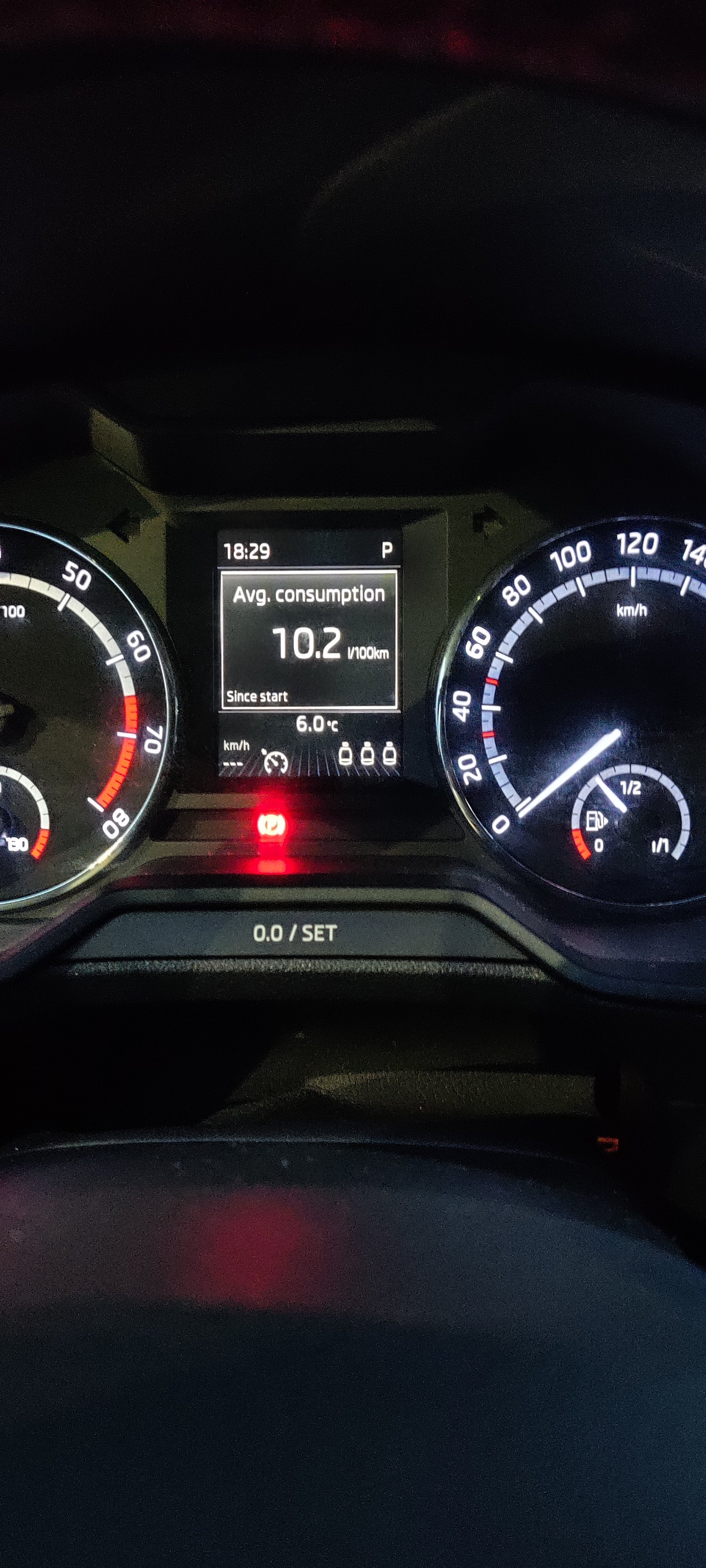

Fuel economy is really really bad, i can barely get under 10L/100km in the city, there must be something seriously wrong with the car
That doesn't sound that bad.
Mine is about 7 on mostly rural roads with very little stop start. That's a 1.4 TSI too.
I doubt it's that serious if no error codes and otherwise driving fine.
