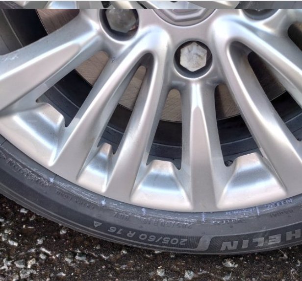

What I did was buy a set of scuffed alloys, got them lightly refurbished and then had those for my winter tyres. It is also worth getting wheel alignment done as well. Remember, winter tyres should not be used above 7C.

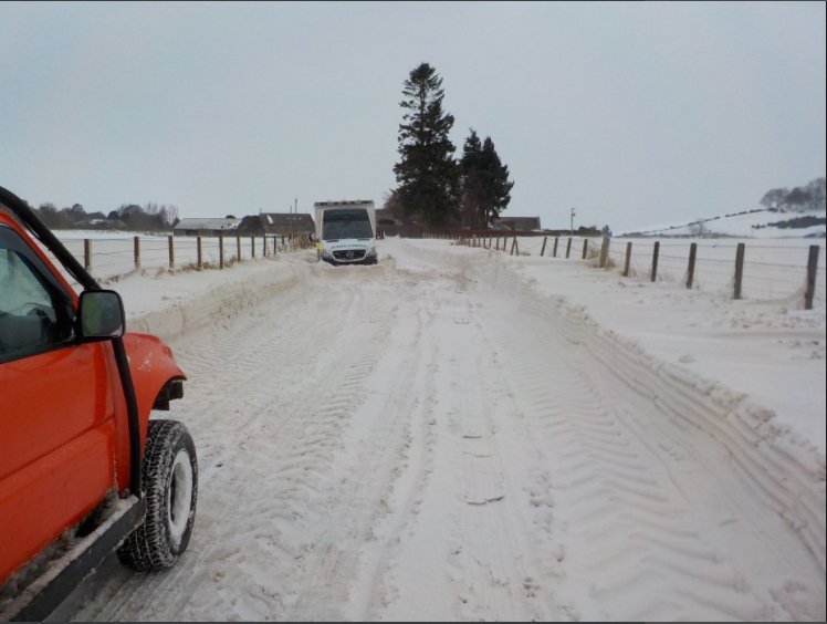

Snow Chains are allowed and not illegal on the Kings Highway.
But,
there needs to be total snow / ice cover and not to be used on Black Top.
Maybe in the most extreme of conditions, in hills and glens and back roads.
Where there are snow gates and snow gates closed and you are in that area within that snow bound area.
Maybe not common, but it happens. When the emergency services are on unsuitable tyres like Police Vehicles, Fire Services, Ambulances etc there is nobody kicking off about you having on Chains or Studded tyres.
If you have chains you can fit them just as you might fit Snow Socks until you do not need them.

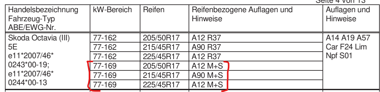

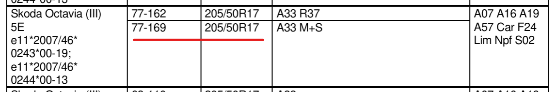

The associated detailed document at page 4 does include my version (169 kw):

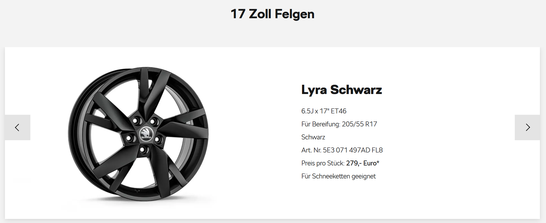

Based on the new Lyra tyres, this may also be a valid size (and allows snow chains):
The tyres on them, I understand both 205/50 and 205/55 are allowed, and the latter would be preferred. Unfortunately, reifendirekt.ch always pairs them with 205/50, even for models that state 205/55 for the Octavia RS, like in this example:

I was considering options on the 7x17 size, but for all of those, the document codes disallow the use of snow chains. I don't need it necessarily, but would be a nice to have, especially when buying new (which I reckon may also impact its resale price).

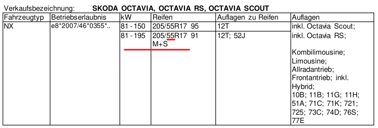

The only 17" wheel sizes shown in the Octavia MK3 RS owner's manual that are suitable for snow chains are 205/50R17 6Jx17 ET45 and 205/50R17 6Jx17 ET48.
The only other 17" wheels that are listed on the Octavia MK3 RS's CoC (Certificate of Conformity) are 225/45R17 7Jx17 ET49 and 225/45R17 7.5Jx17 ET51.
6.5Jx17 ET46 won't be listed on the CoC for any Octavia MK3...it's an Octavia MK4 rim size. The Octavia MK4 uses a 205/55R17 tyre size with this rim.
Aftermarket alloy rims often come in sizes (rim width, offset, etc.) that aren't approved by Skoda...ie. they won't be listed on the car's CoC.
205/55R17 isn't approved by Skoda for any Octavia MK3 (including the RS), except for the Scout when fitted to a 6Jx17 ET48 rim.
NX is a code for the Octavia MK4, not Octavia MK3.

The 205/55R17 tyre size in the below listing only applies to the Octavia MK3 Scout. Other Octavia MK3 models use a smaller outside diameter 205/50R17 tyre size...with this 6Jx17 ET48 rim specification.
6Jx17 ET48 5/112 57.1 alloy rim CRYSTAL 5E0071496A 8Z8 (204.34 Euros is about £177.37)
https://www.skoda-parts.com/spare-part/5e0071496a8z8-aluminium-rim-17-crystal-skoda-43499.html
6.5Jx17 ET46 5/112 57.1 alloy rim LYRA 5E3071497AC 8Z8 (215.38 Euros is about £186.95)
https://www.skoda-parts.com/spare-part/5e3071497ac8z8-aluminium-rim-17-lyra-skoda-41403.html

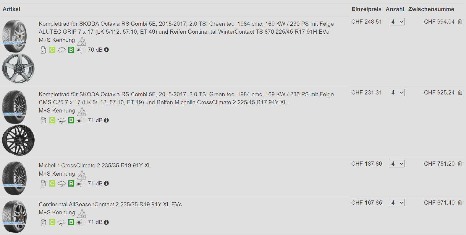

I think I'm letting go of the snow chains, don't think I'll really ever need them. Kerbing damage is also not my biggest fear, I mainly drive to work on the highway and almost always park in the garage, very rarely in the city. Maybe there are other factors I'm not considering or weighing properly, but it doesn't feel like an overly big compromise.

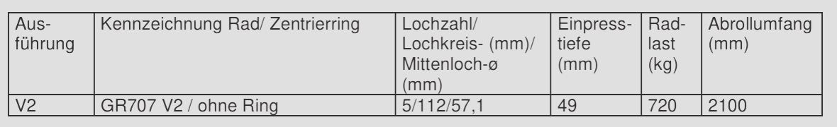

I think I like the ALUTEC Grip 7.0 x 17ET 49 the most for its low price and the looks and it's available in a darker color, that I can imagine could be more practical in slushy, muddy, rainy, dirty times.
These are the specs for it (sorry for the German, I actually don't speak it myself).
It seems like all 3 tyre options are possible, however I don't see RS being mentioned explicitly. This is just based on the kW (169), which leaves me a bit unsure again:
Also after selecting these rims, it does let me choose any of these 3 sizes for the tyres (even though the car model is preselected)
But based on your answer, the COC only lists 225/45, so I should not take the narrower 205/50R17, right?

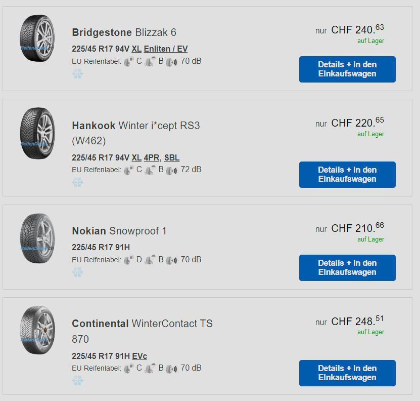

What tyres would you choose:
My mechanic said in general to go with Nokian because of it's great price/perf ratio, though I did read some mixed reviews about them.
I'm not sure here, if I need XL for my model (combi) or it doesn't matter? Also, how significant is D vs C in terms of fuel economy?
Conti TS 870 got the best scores in the famous adac.de tests, so I'm tempted to go with that despite the slightly higher price.
Just slightly below 1000 CHF, I think it's not too bad of a deal.
Thanks for all the great and helpful responses so far. I feel like I'm learning a lot.
Edited by CloneXpert

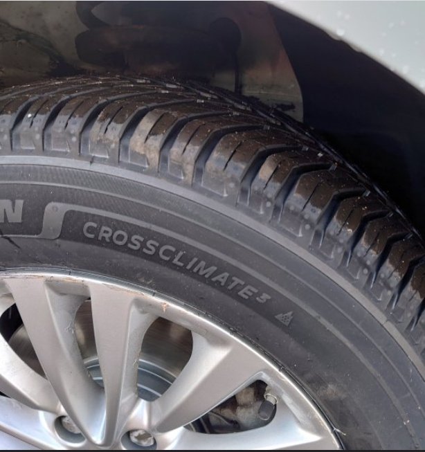

I also added CrossClimate 2 in the mix for comparison.
I read that CC2 is very good, performing as well as winter tyres. I wonder though, about the durability compared to having 2 sets. This could save me some swaps, but don't know what to believe...

I'm also considering ASC2 now, I see you also recommended it in another thread.
I just need to survive icy conditions a few times a year when going snowboarding (but where the roads are almost always cleared) or when it's actively snowing and it's cold. Having winter tyres on when it can get surprisingly hot in March/April, then swing back to wintry conditions again is just ideal for the winter tyres I understand.
