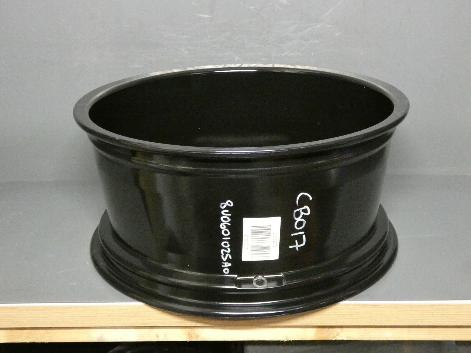

There's an Italian seller listing five new 3V0601025A 8Z8 Triton 6.5Jx17 ET41 rims on ebay who will ship to Switzerland.
Alu kolo TRITON 17" Superb III
https://www.ebay.co.uk/sch/i.html?_from=R40&_trksid=p4432023.m570.l1313&_nkw=3V0601025A+8Z8&_sacat=0https://www.ebay.co.uk/sch/i.html?_from=R40&_trksid=p4432023.m570.l1313&_nkw=3V0601025A+8Z8&_sacat=0
What are the OEM part numbers for the alloy rims?
This will tell you if they are from the accessory parts catalogue or the much more expensive factory part numbers.
From the accessories catalogue the Triton rims should be about 225 CHF each not 365 CHF, ie. almost 40% less.

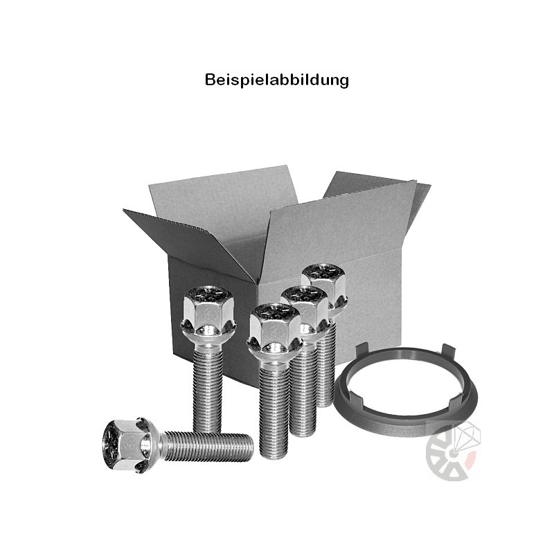

After looking again at the technical datasheets, I am correct that the centerbore is different.
57.1 for the ECE approved V.
72.5 for the ABE approved Y.
The Y needs a mounting kit with a centering-ring like below:
https://wildkrist.com/Anbaukit-5207
So this is the reason it doesn't have the ECE certification as this requires identical centerbore & borbet don't make different versions of the Y for different OEMs rather just a one size fits all.
