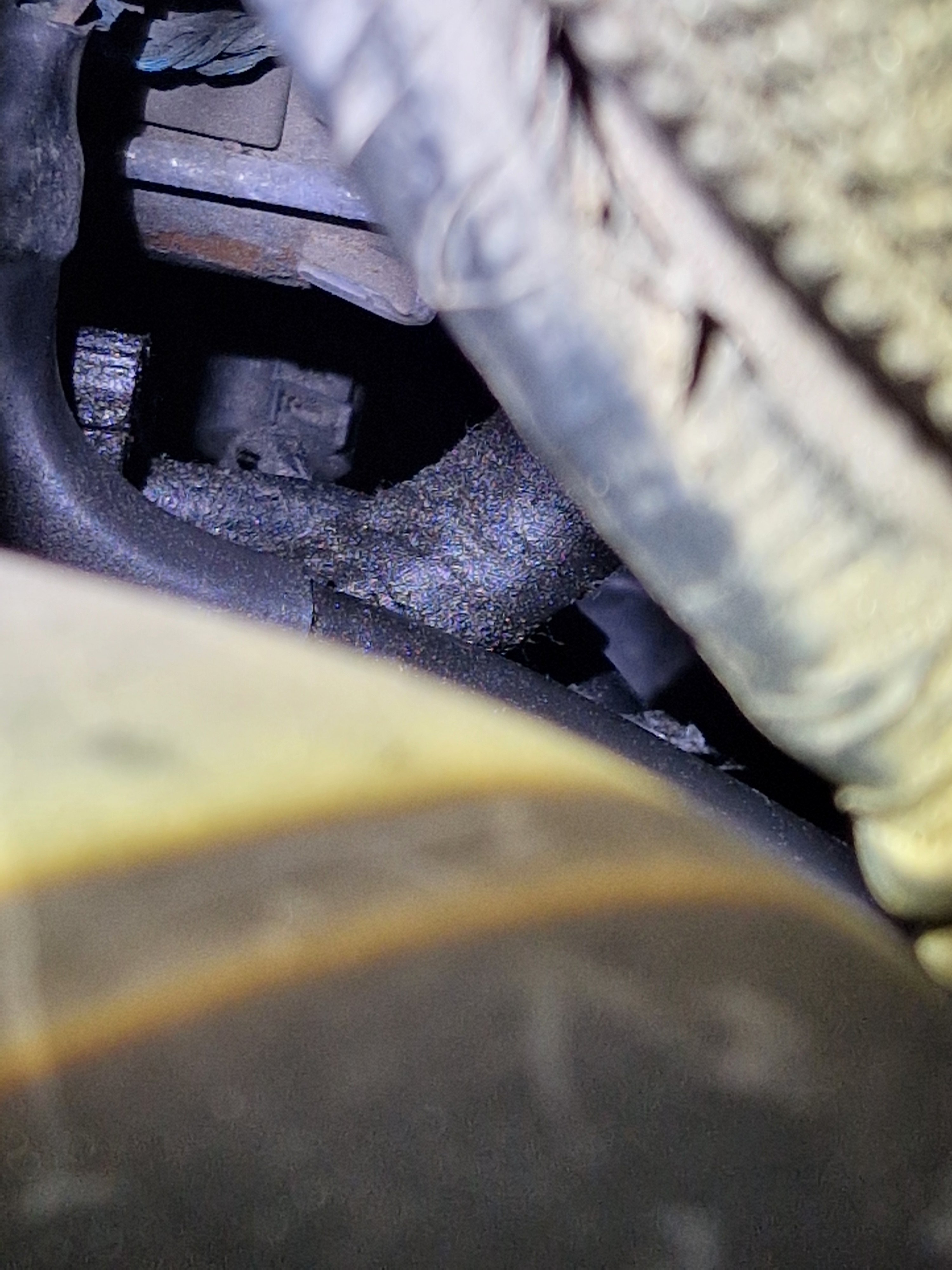

If you remove some of the air ducting between front of car and airbox, you may have enough view downwards to see the reverse light switch on the front face of gearbox, low down, and particularly the wiring exiting from its connector. Not sure. Might have to ease the odd coolant hose aside.
Might be able to spot a broken, dangling wire that way, rather than having to get under the car.

Can only just see the body of the connector, but too much other stuff in the way of seeing wires emerging from back of it, sadly.

This was without removing anything, just looking to the right of the duct that goes from front of car.
Highlighted connector in this copy

I really appreciate this recce, thank you!
This is really helpful, at least I know what I’m looking for now if I can get the angles right.
