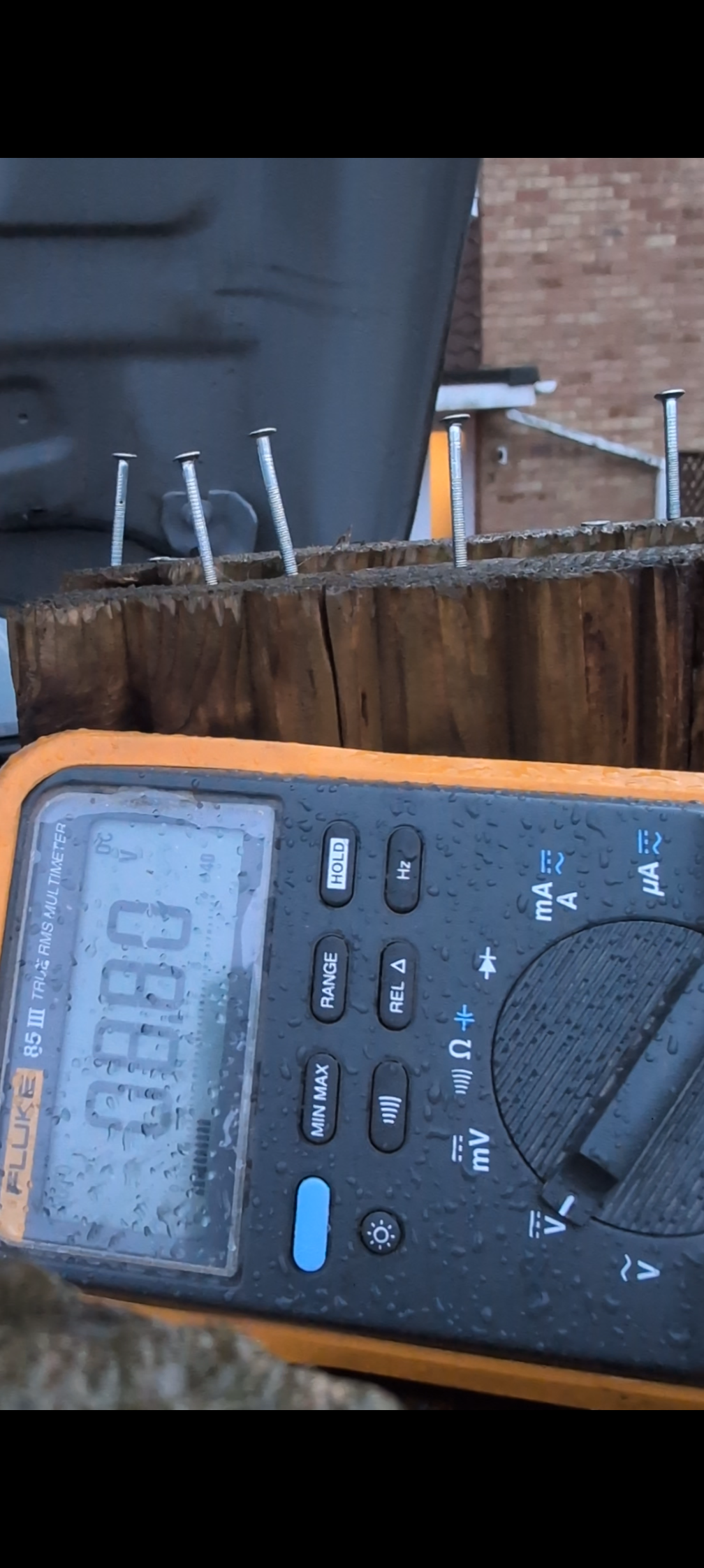

8.8v on start up

8.8v on start up
That is an immediate fail - what is the reading with the engine running?

I've had different readings the few times I've checked it. Last week when I checked it it said 12.1v whilst sitting on the drive running. So I thought maybe the alternator was faulty. Yesterday doing the same check 14.5v which would suggest the alternator was working.

What could possibly be happening is one (or more) cell has developed a high internal resistance, which will display a fairly reasonable voltage under no load conditions - but will severely restrict current when load is applied.
The only way to diagnose this is a proper battery load test - although your cranking voltage test does indicate the battery is either discharged or faulty.
