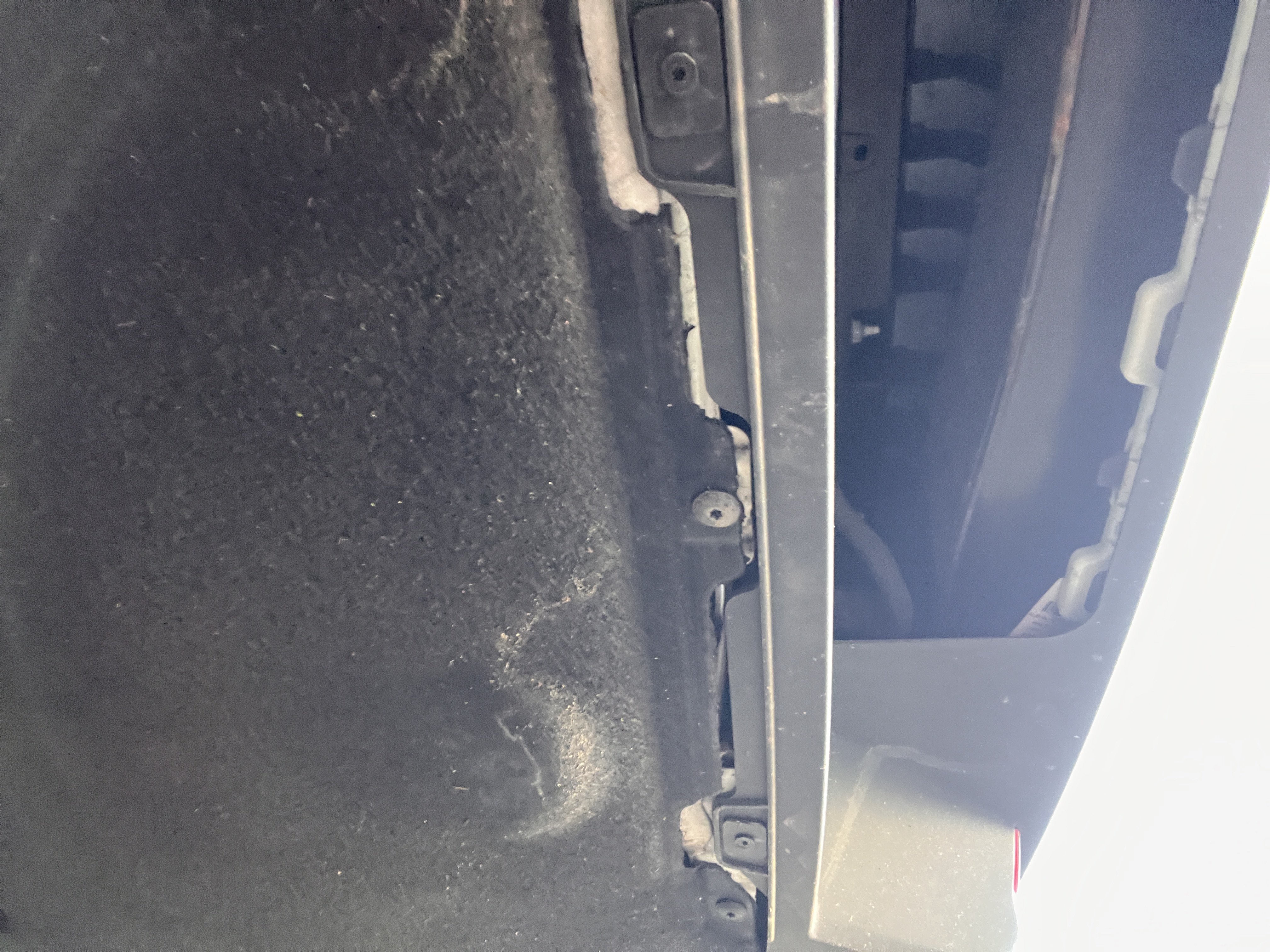

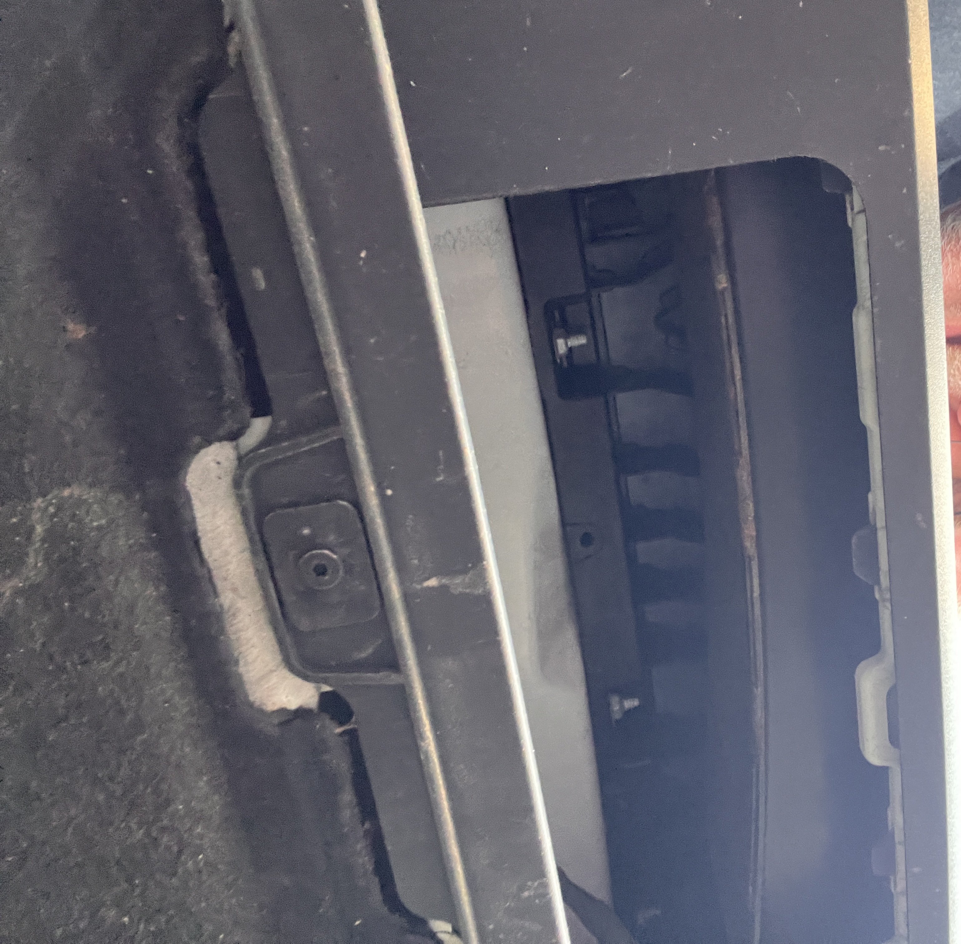

I took photos underneath and to my untrained and somewhat cynical eye, it looks like it just means a panel has been removed.
Is there anything useful there?
Hello, welcome to the forum. It means that the wiring loom required for towbar electrics has been fitted during assembly.

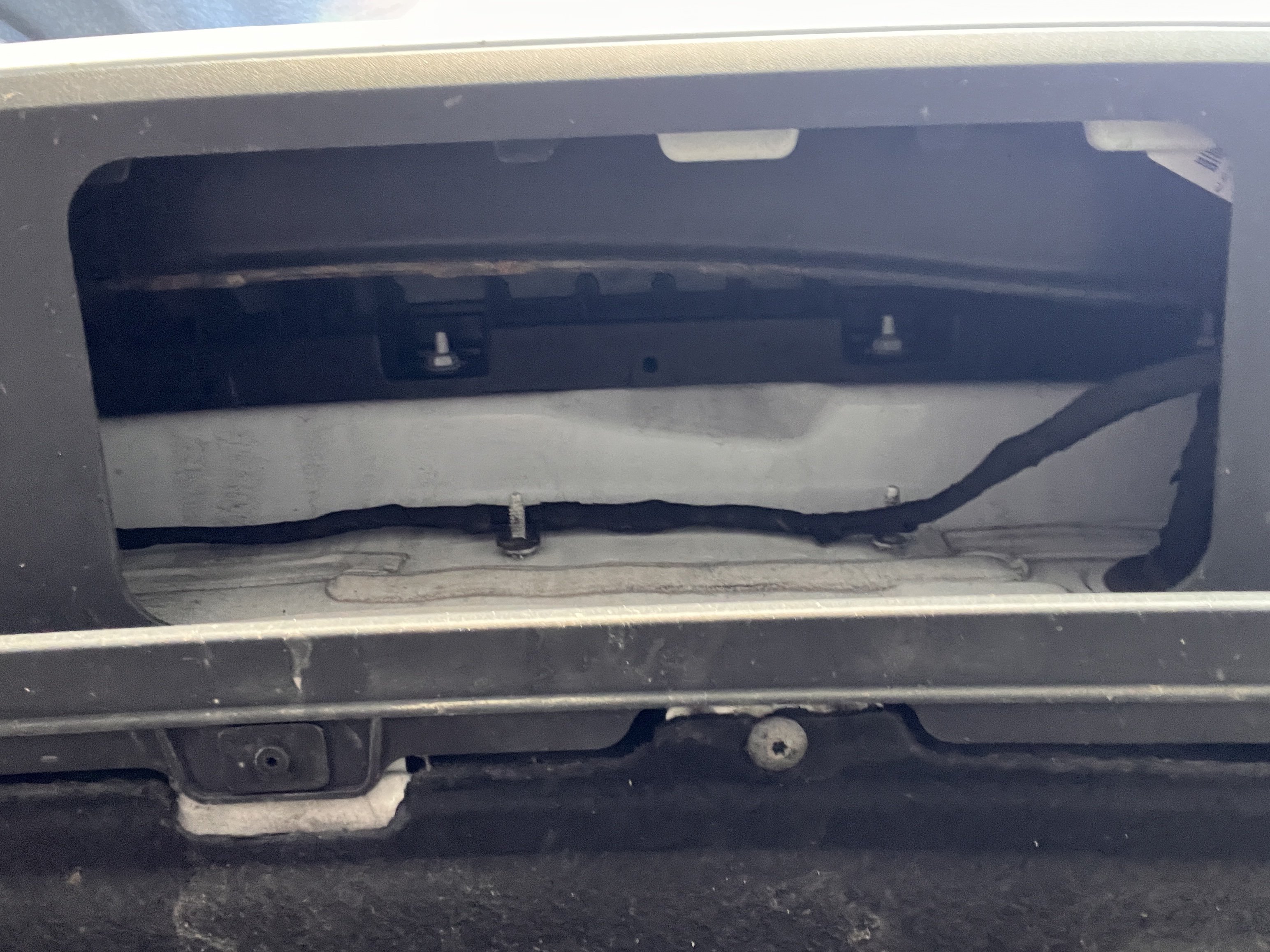

Thanks. Presumably that bit of loom there.
Possibly not that one - I'd expect factory towbar prep to incorporate a multi-pin socket and a Can bus module, that loom is possibly tail light wiring or rear parking sensors.

So do I, it will be behind a side panel in the boot not outside or underneath
