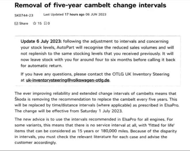

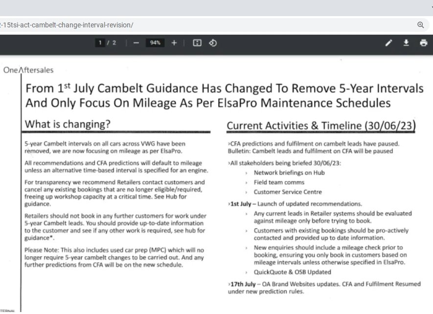

June 2023 Skoda / VW changed the Cambelt schedule for replacement to more like 180,000 miles and however many years, not 5 years / 50,000 miles. Let the Dealership that says a 1.0 TSI is @ 140,000 miles show you in writing. The Service Desk person can maybe go ask the Master Tech if he advises it then. Not the Service Manager, is is not a mechanical engineer. I hope the car had new spark plugs recently and at least once before that. Re Cambelt, be sure who does it knows the 1.0 TSI and has the locking tool. Too many have been messed up. the 1.0 TSI is nothing like as expensive to have done as a 1.5 TSI ACT.
