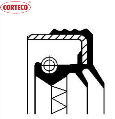

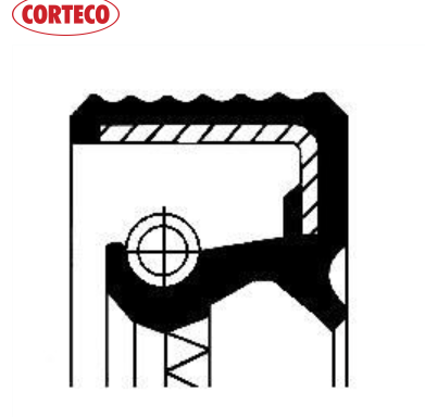

I personally advise for the double lipped 002301227E (https://www.autodoc.gr/corteco/2094579)
vs the single lipped 002301227C (https://www.autodoc.gr/corteco/7770799)

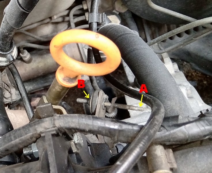

loosen it
2 hours ago, Rsedmonds said:
though the gear lever does have an obvious amount of play. The clutch pedal is close to the floor but again these are both battles for another day.
If there is a Kit is available,i have bought and install it,very good results.
In engine bay there is the clutch cable,use a plier to hold steady the hexagon part (A)
and with the other hand use a 10mm wrench to loosen the bolt (B) few clicks.

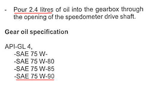

75W-90 GL-4 gear oil, 2.2-2.4 litres
Skoda says change after 60.000 Km but i will do a change after 30-40.000 Km

2.2-2.4 litres
I use 3 liters to aid in heat capacity and to allow some oil loss.
But yeah, official capacity is 2.4L
