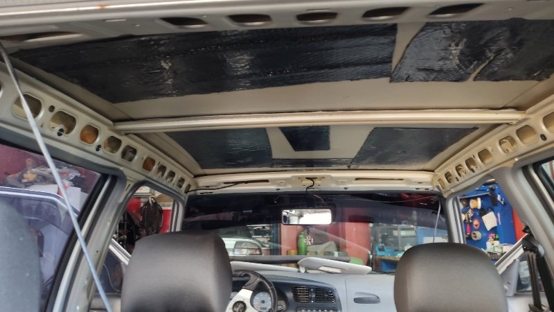

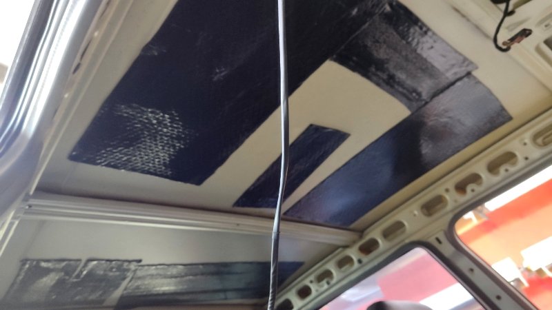

As for the soundproof project first i bought some sheets of STP Black Silver Shop Pack, according to the manufacturer:
It is installed in any area of the car where vibration attenuation is required: external and intermediate door panels, roof, floor, engine compartment, trunk, etc.

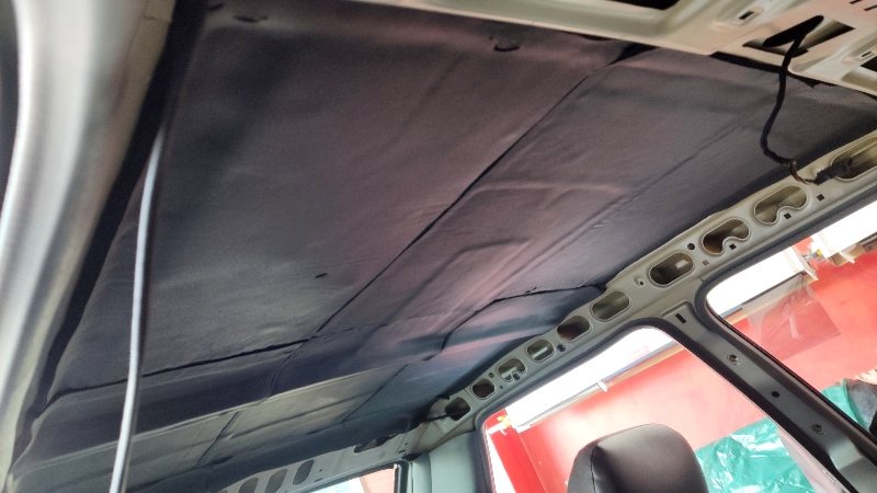

The ceiling was ''naked'' from inside and for sure there were some vibrations because there was to support except one bracket in the middle and second i bought a cheaper material in roll form to absorb the sound.
This is the StP
which made the ceiling more ''steady'' reducing a lot the vibrations while travelling in highway.

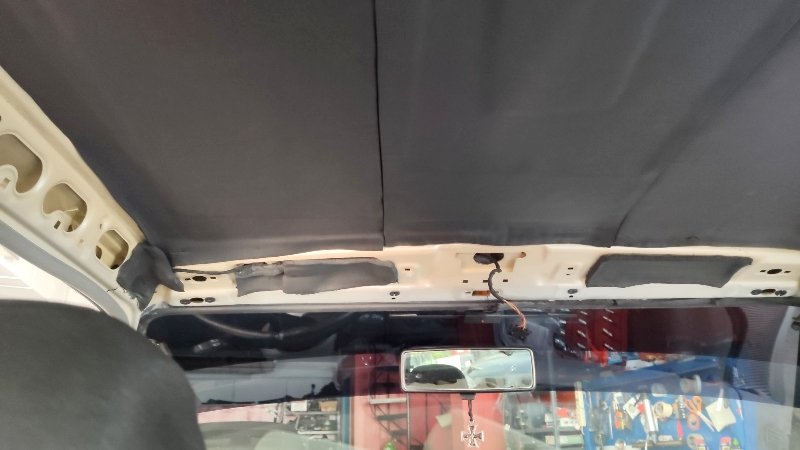

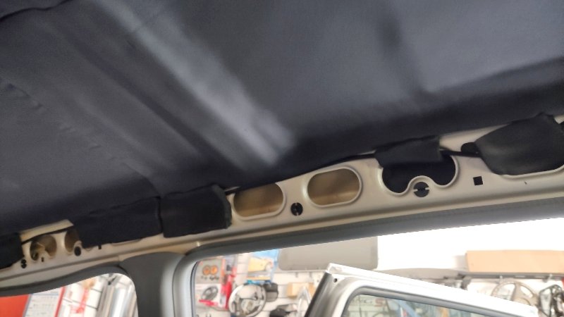

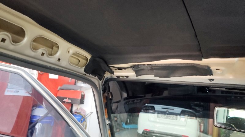

Here are the photos from the second material:

Impressions: the ceiling is more ''robust'', the sound was reduced to minimum while travelling and the noise from the rain drops almost vanished, before the ''doung-doung'' sound was present and the whole results is that the ''tin effect'' that other cars had does not apply to mine.
