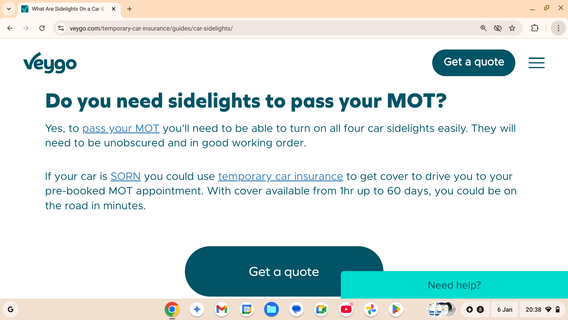

The UK MOT requires the Sidelights front and rear to operate without the headlights being on.
Stewart M,

Where in the tester manual do it say they must be on without the headlmps?
@BeeTee You are right, the manual now has that the Headlights can act as Position Lights / Sidelights.

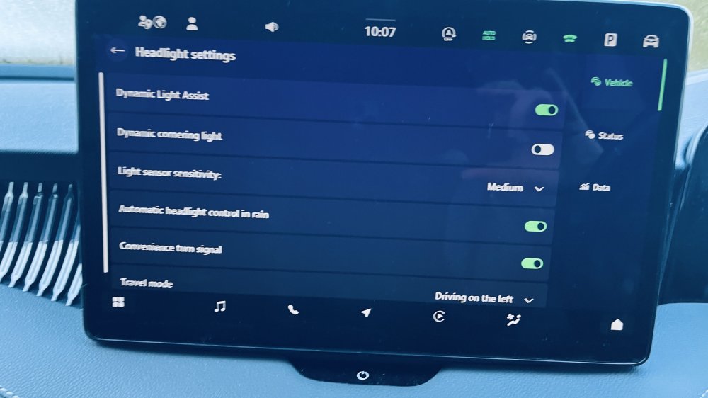

Have you tried adjusting the Light Sensor Sensitivity? (Picture is from a Superb but the system is much the same.)20260110_100741724_iOS.jpg

No i have not tried this but will do so now and let you know
Thanks for the advice
