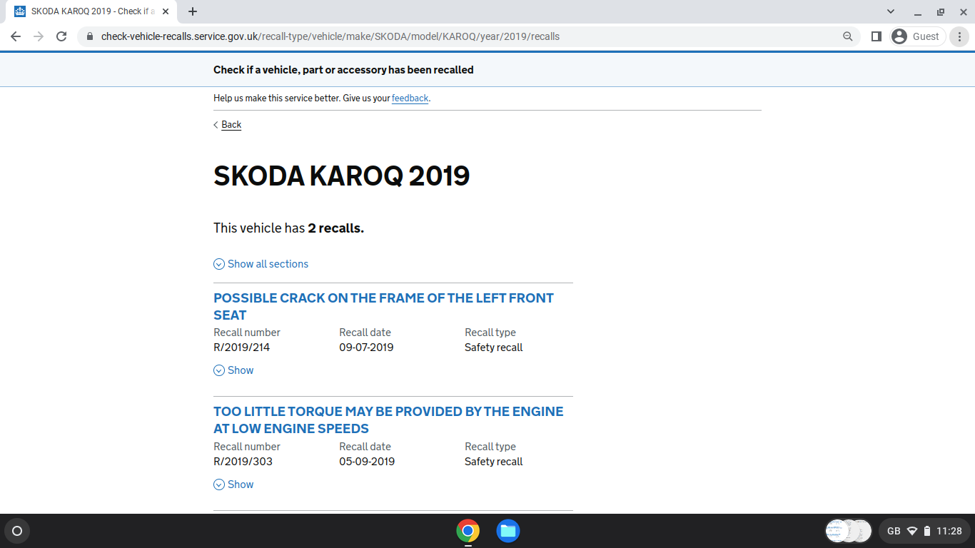

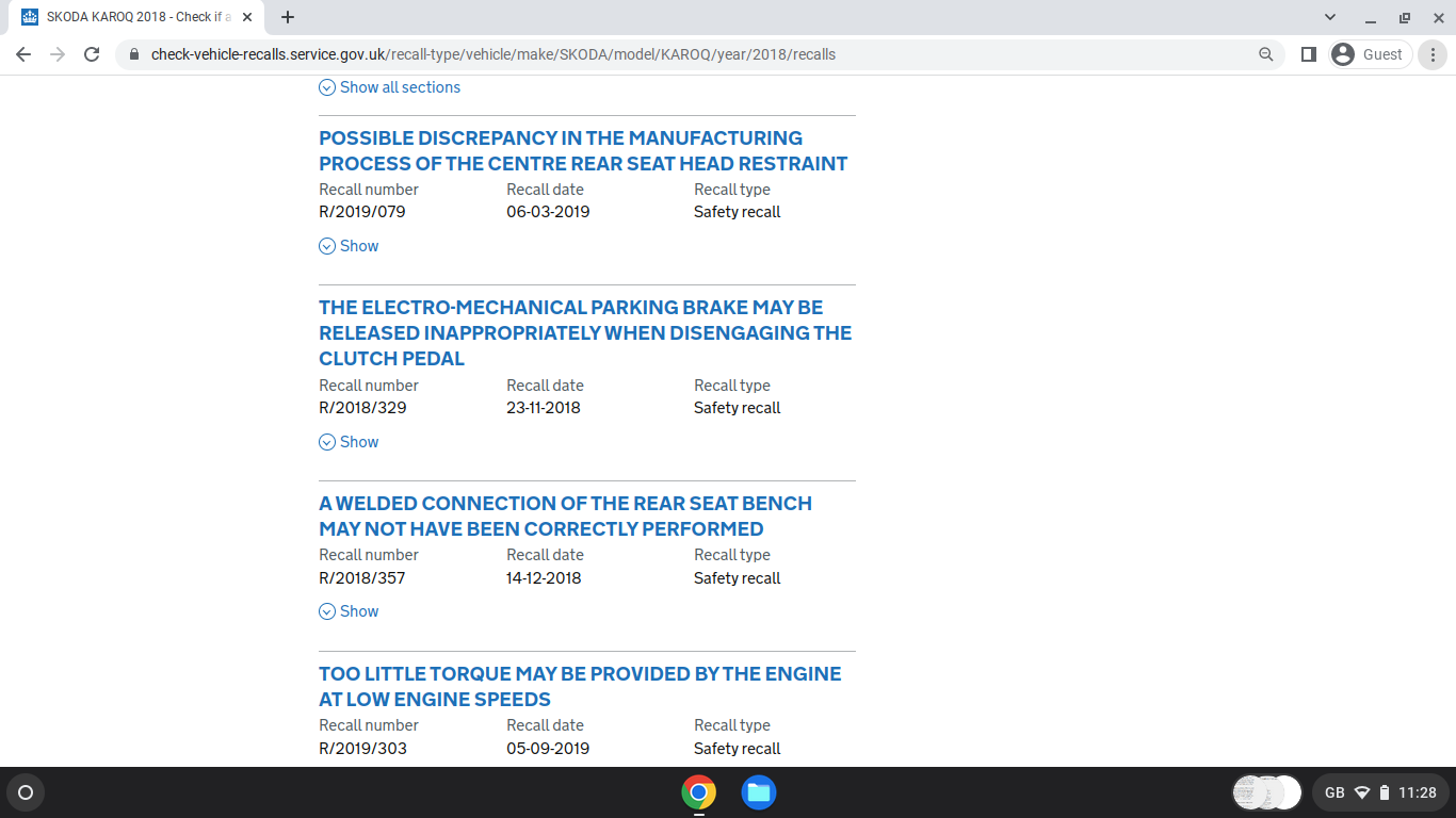

@DSL Some of the early ones including DSG,s were included in the Full DVLA Safety Critical RECALL in the UK & got the software update. Some still had issues after. So was it part of those and was the Recall Action carried out?

Thanks for that. The car is 21 plate, and no recalls showing on the .gov site. Fingers crossed it’s not affected. 🤞
There were no recalls on the ones after the WLTP was first brought in and VW / Skoda messed with Engine Management to get cerification. They messed up, hence kangarooing, just less obviouis with the DSG on a 1.5 TSI ACT. The cutting out thing came after that and some have complained and obviously those that have no issues were lucky and often say there is no issue. Well not for them there is not.
