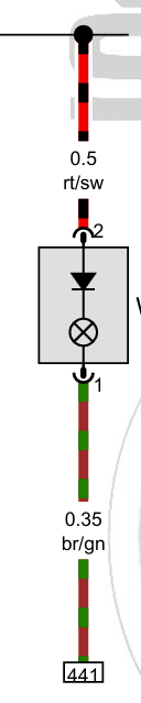

First wiring diagram I've looked at suggests that the feed for the switch is shared with the luggage compartment light. Is that working at present?
Yes - that comes on when I pop the boot using the manual override. So I guess it's not some kind of fuse or relay then...?

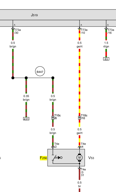

The switch I'm looking at may be the wrong one, it may be a feedback switch within the lock motor unit rather than the release switch. F256 here:
V53 is lock unit motor.
Box with 83 inside it is a feed from fuse 45
Box with 431 in goes here, (box with 441 in), so the earthy side of the luggage compartment light, not the feed.

J519 is BCM

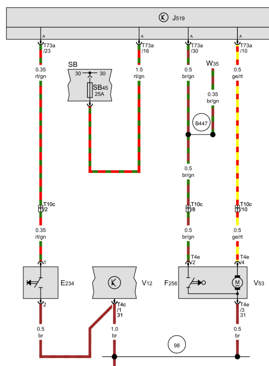

This is where I should have been looking!
E234 is the switch you mean.
V12 is rear wiper motor module. Brown wires are earths, J519 is BCM.

Not sure if you're responding to first set of diagrams or the correct one I just posted?
If the former, look at the latter.
Simple (red/green) wiring between BCM and release switch, via 10-way connector pair that's physically located behind left D-pillar trim, I believe. Earth side of release switch seems to go to rear wiper earth connection.
My money would be firmly on a wire break inside the bellows, double check now that you know to look for the thin red/green, (or the thick earth to rear wiper, brown). Check rear wiper for function/non.
