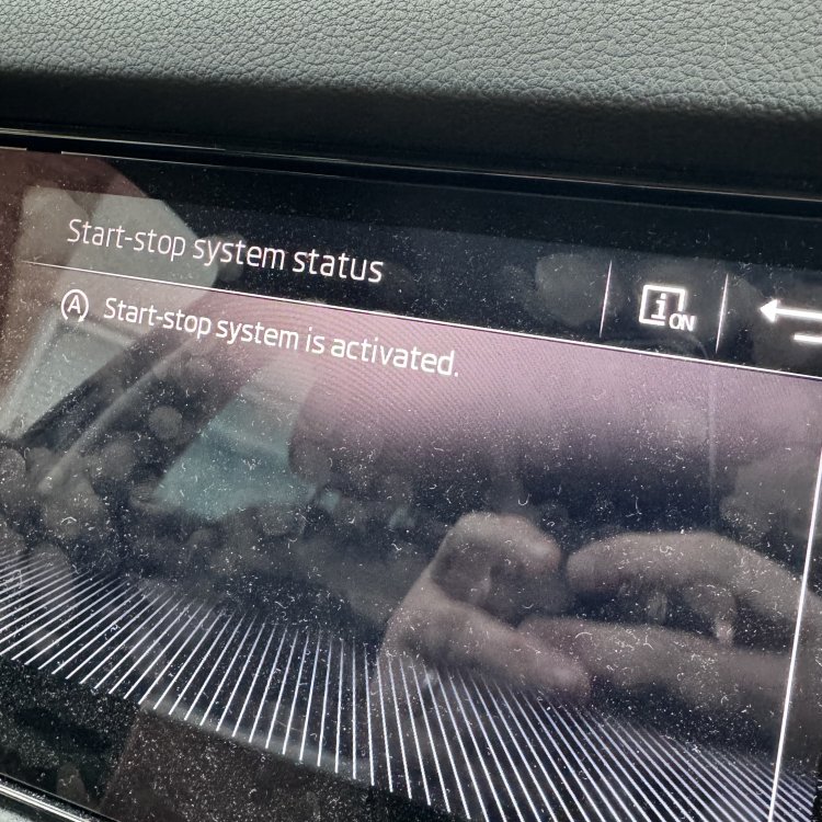

  • Hi, As you can see from the photos there is no extra load. I don’t think I receive over the air updates - how would I know ? Loose battery - what does that mean ? I drove for 40 mins yesterday and
  • I turned the heater off entirely so as to remove as much load as poss. Running lights were on. And they may have been the cause of the radio reset ?
