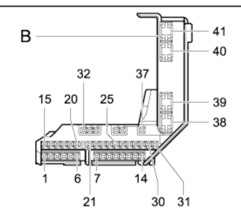

Seems almost like a connector or two is unplugged from the stalks?
Has steering wheel been removed recently?
The steering wheel connector is a one-piece 41-pin plug, so it would be a bigger problem involving the airbag light, no high beam (flash or fixed), etc. I'm not saying that isn't possible, but instead of being unplugged, it could be some broken wires maybe.
(It looks like the picture, it's gray, and it connects behind the stalks)
Edited by Jack25

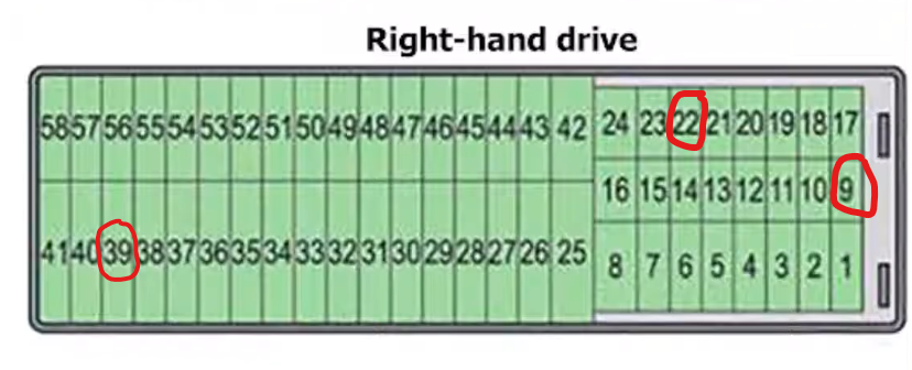

Steering wheel wasn't touched until last week. Still have high beam and fixed lights. Everything works apart from heaters, wipers, indicators and horn. The heating control unit is electric because its the elegance. I appreciate all the comments and awaiting someone coming out with VCDS to help resolve this issue.
Even the heater? try to look if you have power at this fuse, they are related to the heater; just to understand if there is any power.
