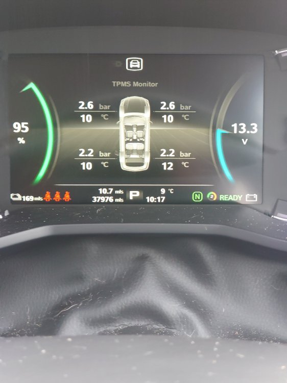

The Tyre does not have to be at the correct pressure as the cars system has no idea The Pressure or Heat unless you have a Car with that system and On Wheel Sensors. It knows the Circuference of the tyre. & that can be reset with a SPARE WHEEL on. Actually you can set the TPMS with one tyre or 2 tyres at different pressures. You can set all 4 at different pressures. TRY IT, go out and let one tyre down, or inflate it more and reset the TPMS. The car then registers that Circumference. The TPMS then alerts a change if that happens. Usually a loss of circumference, but it can be a tyre heating up and expanding. Bearing / Brake seizing heating up the hub, so wheel so air in tyre.

@nta16 It is not an Incorrect Pressure if you reset with the Spare of a different size. Maybe people are sitting with The Skinny SPACE SAVER, or Skinny Saver of Space steel wheel at 60 psi in the boot, and fit it and do not check the pressure. As it is there are Skoda Superb with Haldex (AWD) that have a far too small Factory fit spare carried that messes up the ABS / Haldex etc, CC or ACC. But then with the spare on of an odd one out, do not use Cruise Control, after all you should be reducing your speed. Different compound, tread, size, weight. Below, my tyres just now. When the sun comes up the front tyres pressure will go up a few PSI and the temp will go up. Once driving the Fronts might rise 2 or 3 psi & the rears 4 or 5. Once out on a fast road the 4 tyres might show different PSI,s & temps. Yes i know showing in BAR, that is how i set the inflator.
