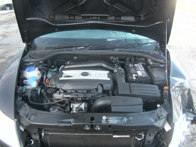

The best picture I could find online suggests there should be an upper plastic part. The idea is that the engine breathes cooler, denser air rather than the hot stuff from the engine bay.

Perhaps I wasn't clear - I have the lid for the airbox - see picture.
Even with the lid on, the air that comes in from the front grill seems to be able to flow straight through and it is this that I am questioning and whether there should be some sort of plastic panel that blocks the air from exiting at the back of the air duct and is that what the two small square holes in picture 4 and 5 (see previous post) are for , for it to clip into?
