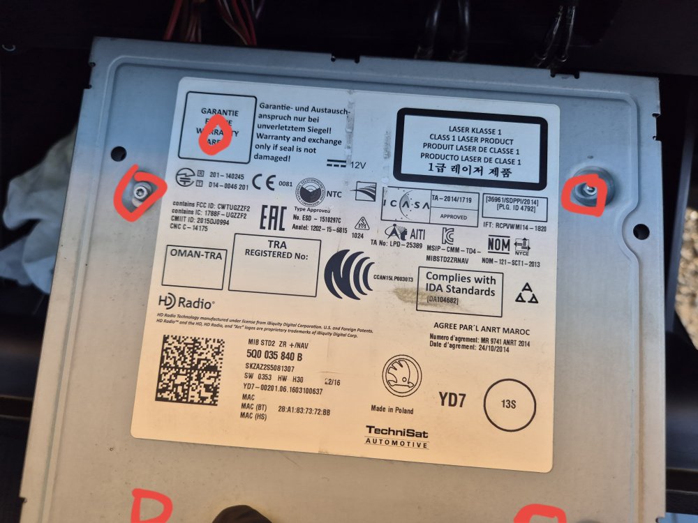

On the display and the unit, there are screws which you need to unscrew (photo of the approximate locations)20260323_221604.jpg
on the unit, there are 4 visible, and one under the warranty sticker
After the screws are out, you can clean the inside of the unit, mainly the inner side of the back connectors

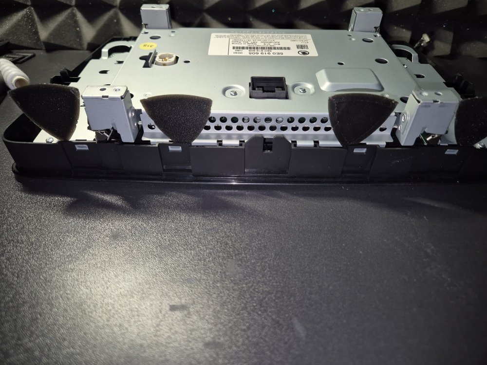

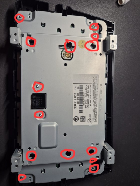

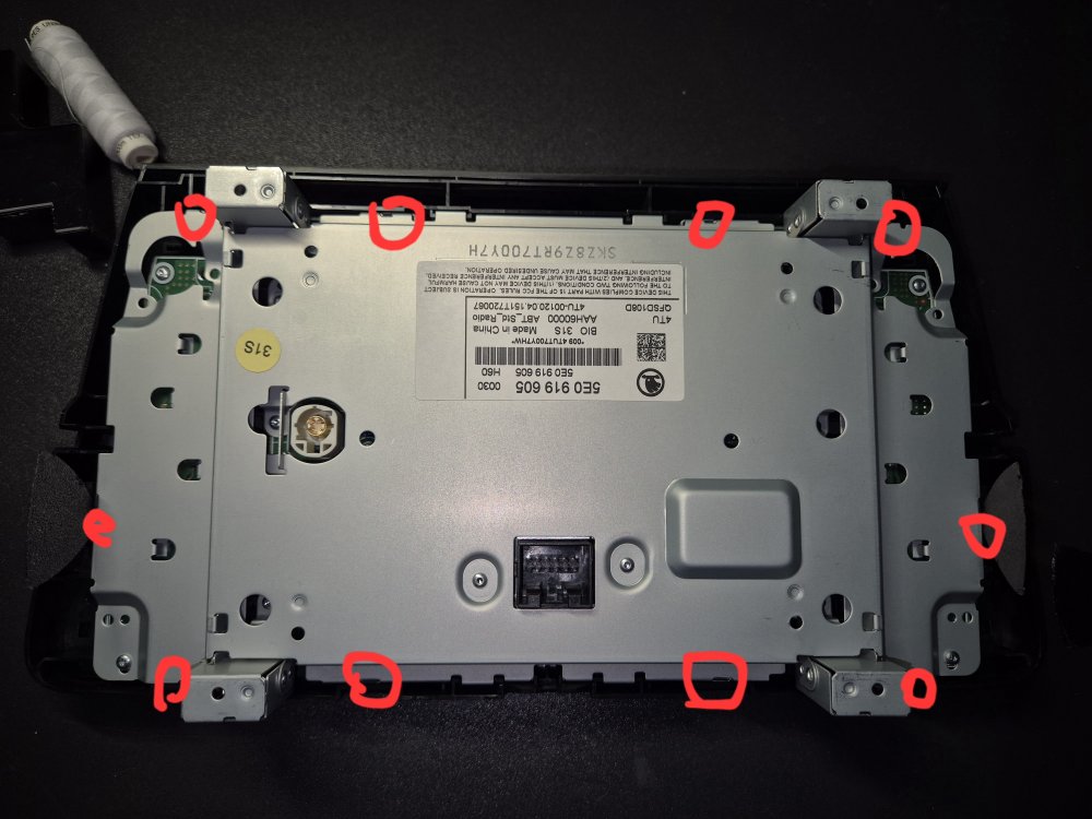

the display needs these hooks to be unhooked (photo)
20260323_222441.jpgI used 4 plastic pry tools - first unhook the bottom or the upper half - then sides
- then it starts to lift and you can unhook the other half 20260323_222353.jpg
Then you can lift it up and clean the inside of the display (mainly all of the connectors that are on the inside)
