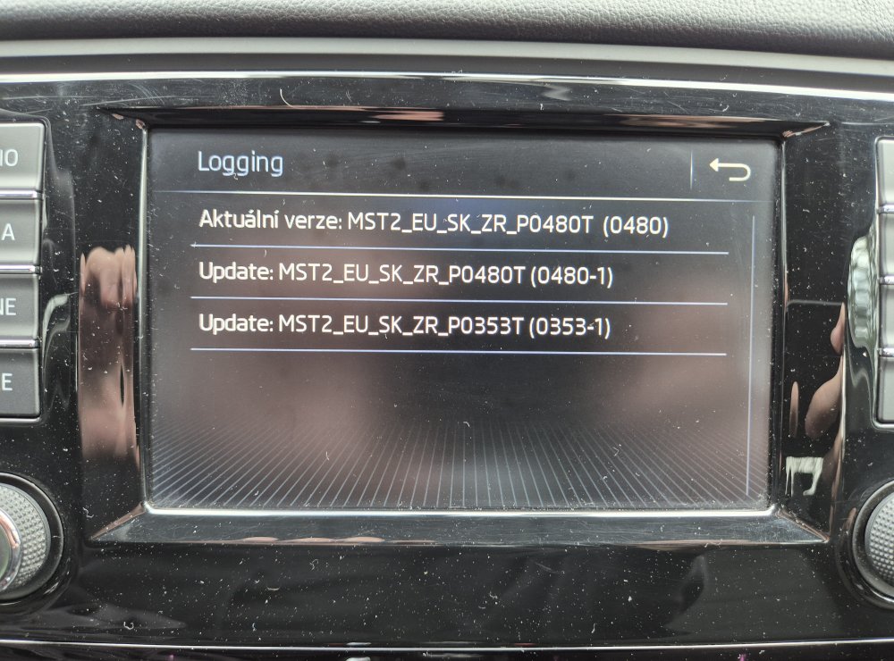

Yes, but I don't know it it was the right firmware, installed one from mibsolutions but I don't really understand the filing there, so I hope that it was the right one
Installed it from here
https://mibsolution.one/#/1/9/MST2%20-%20TechniSat%20Preh/Firmware/SKODA_ZR/EU

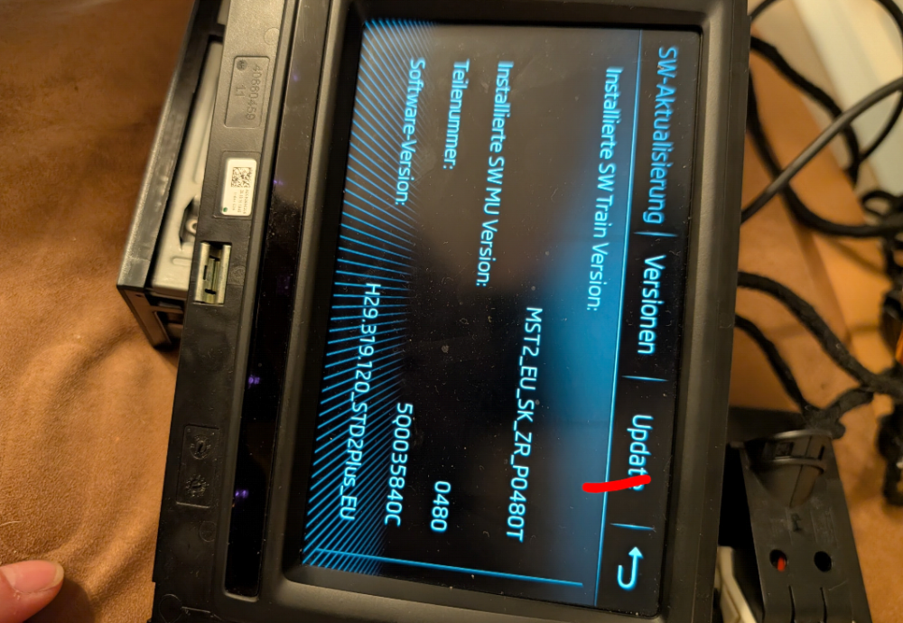

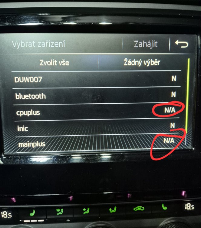

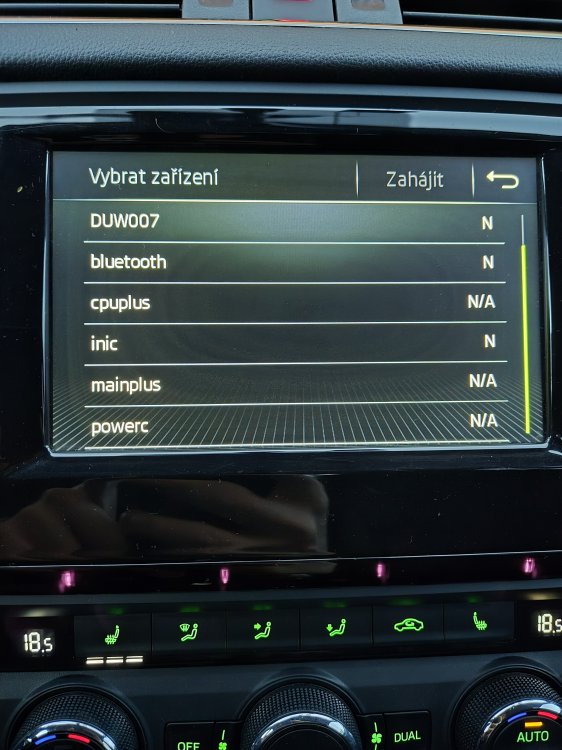

This is the update menu
Should I uncheck something ? There are a lot of N/A

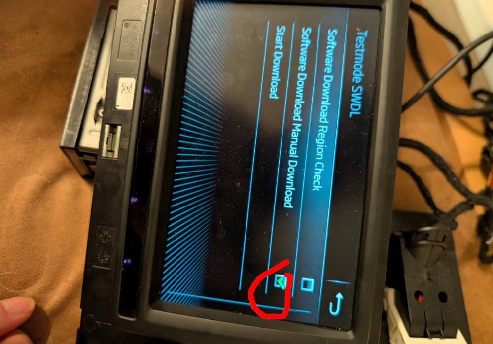

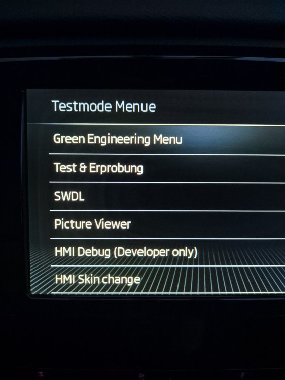

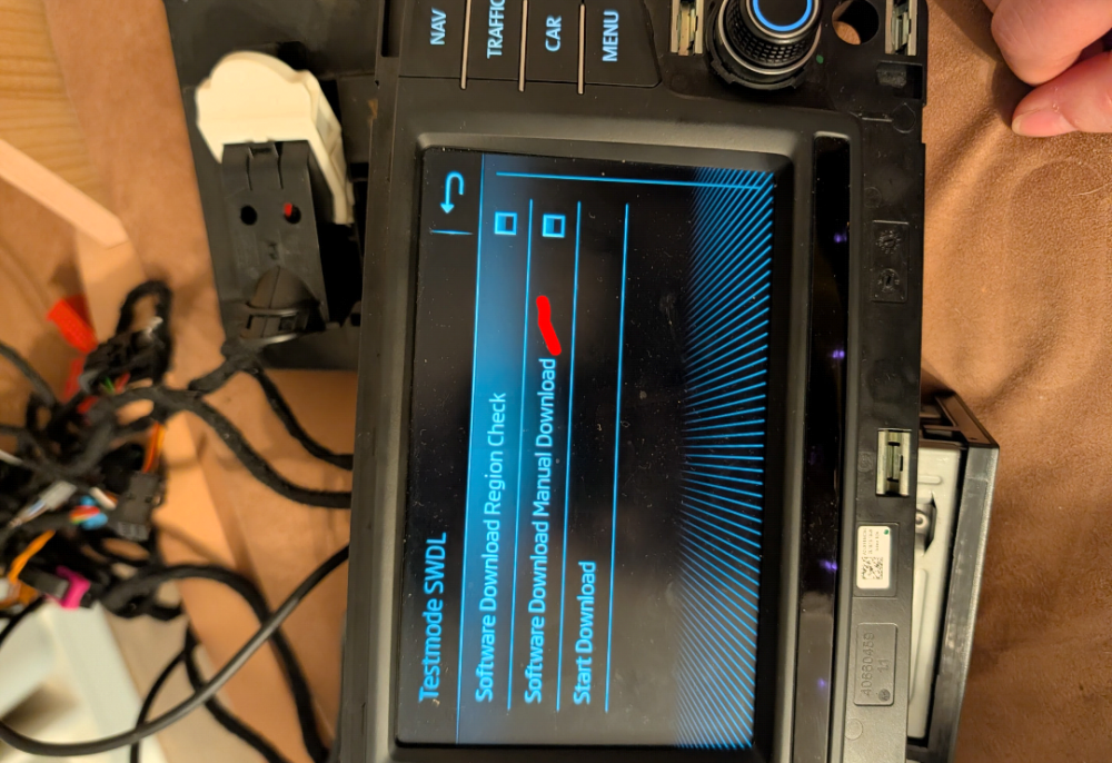

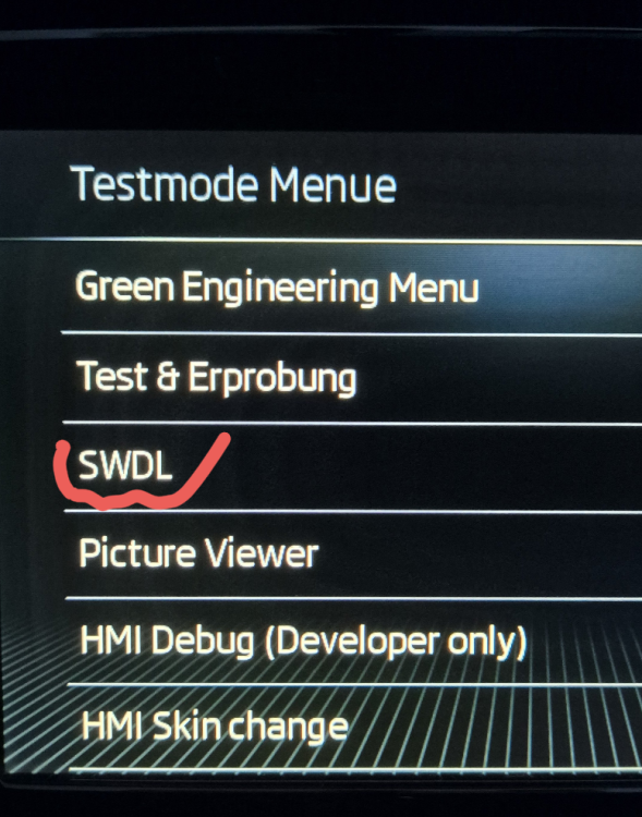

You have to made it in the SWDL Menü
It's this one
Or do you mean the green one ?
Should I update it ?
For me it seems weird, that the main modules have N/A

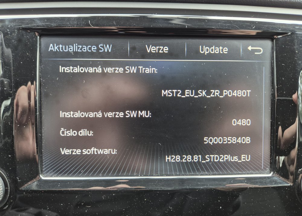

This Menü
2 minutes ago, Cairus said:
This Menü
Yes, it unfolds into the update menu I photographed

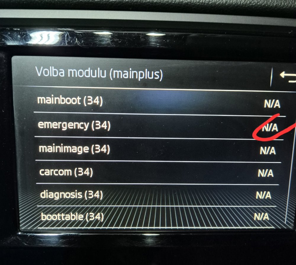

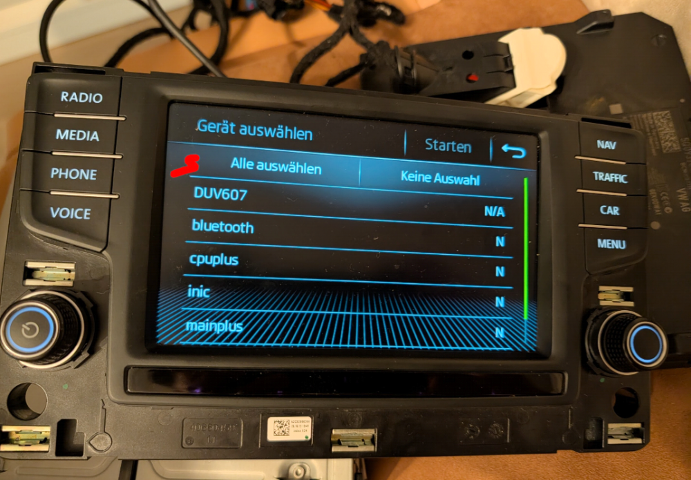

Wait
This
Dont forget To unselect emergency Main and CPU and ESD Folder
Edited by Cairus
17 minutes ago, Cairus said:
This

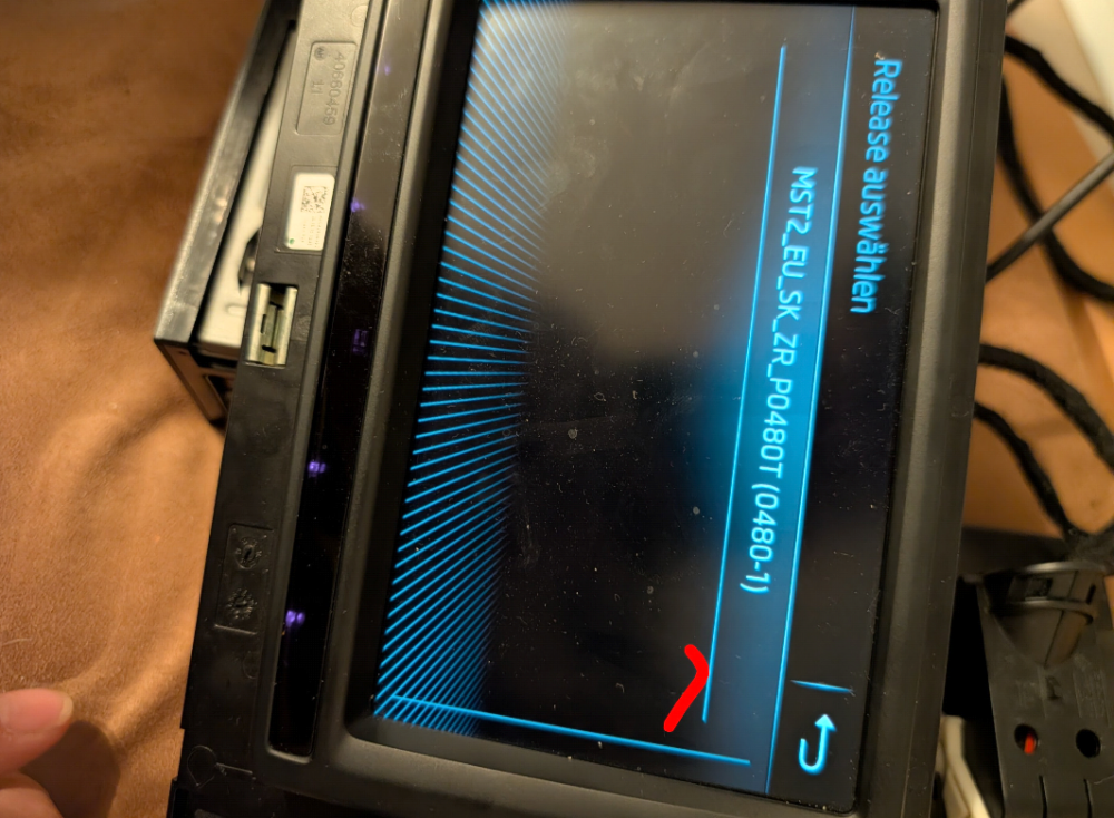

My unfortunately says N/A , is it correct ? (Can't unselect it )

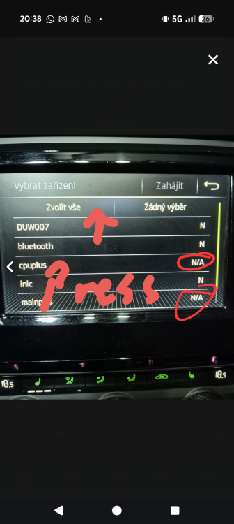

Select all, then unselect only this 3 parts

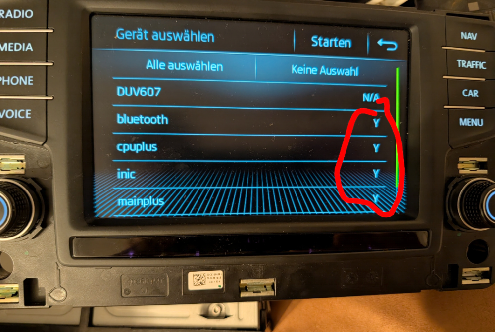

Press
5 minutes ago, Cairus said:
Press
Looks like this, but I cannot unselect the 3 mentioned, they are still N/A

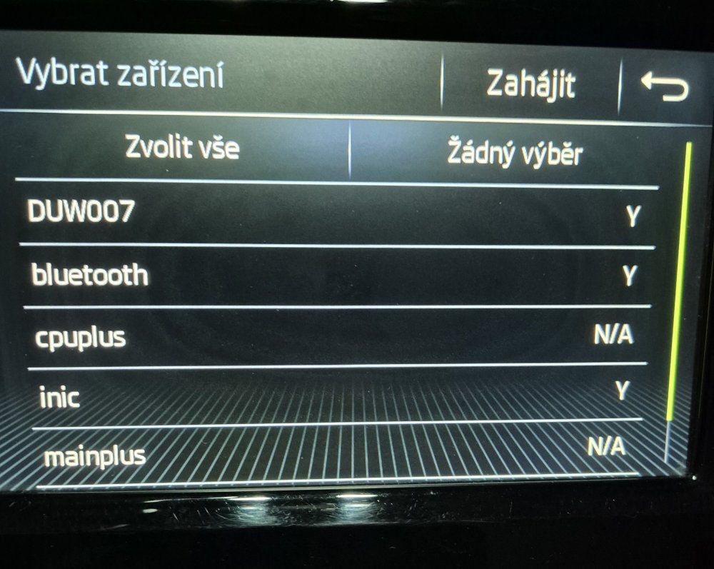

Make Update

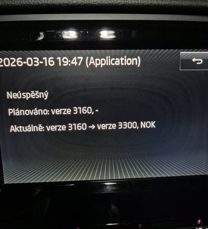

Updating

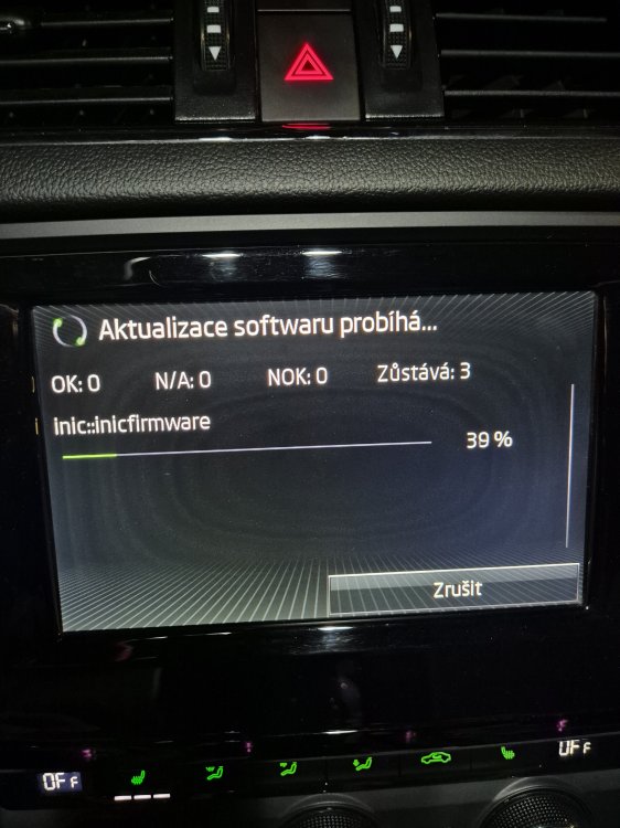

Still the same
Bluetooth failed
The weird part is, that even android Auto connected and everything, just cannot hear the sound or do anything
