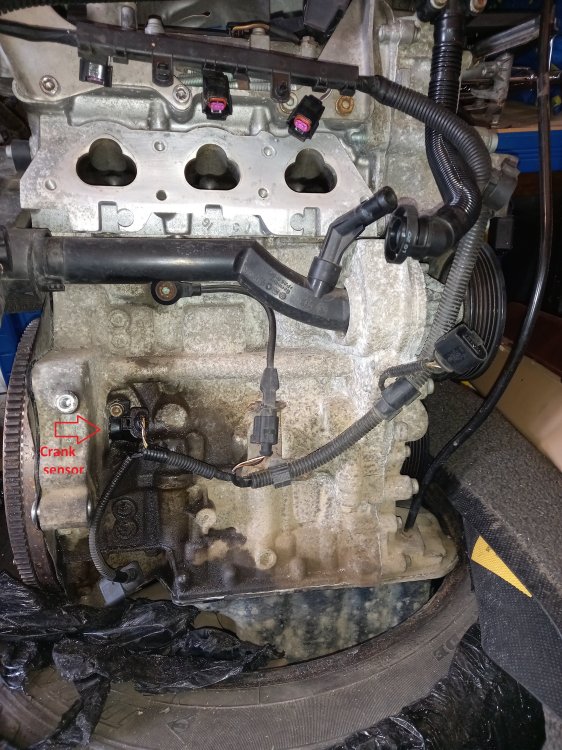

Crank sensor is horrible to access and replace - back of engine block below intake manifold right at gearbox end.
Will add a photo shorty.
If it was me I'd be looking to eliminate other possible causes of the behaviour, and not just trusting that the fault code means sensor fault.

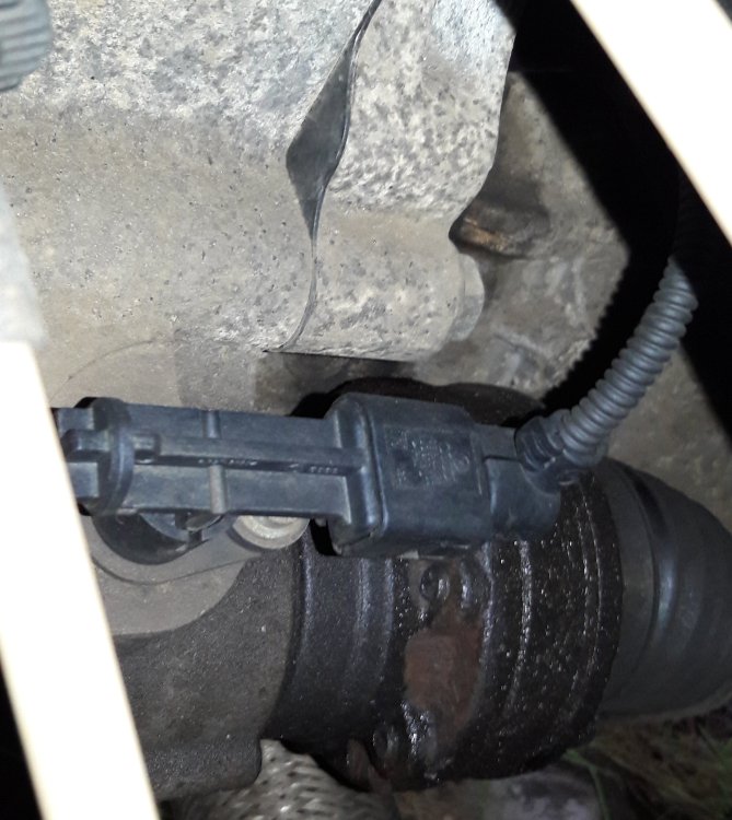

Thats different to the one I was meaning. On my sons 1.2htp theres a sensor on gearbox rear top near steering rack. I assumed it was speed sensor but may be wrong.
Alasdair
  • Sponsor
I guess you mean this dude, just near offside drive flange?
That's a dummy vehicle speed sensor that was where the vehicle speed speed sensor was fitted prior to ABS sensors taking over (around 2002 I think).
Not the same as an engine speed sensor, which is more often known as a crank, or crank angle sensor.
