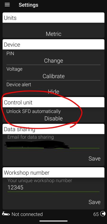

Go to Settings in your OBD app, towards the bottom there is an option called Control Unit -> "Unlock SFD automatically".
default is "Disable"
i'm assuming changing that to Enable should cover u.

Edited by JR RS

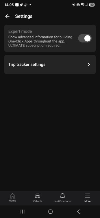

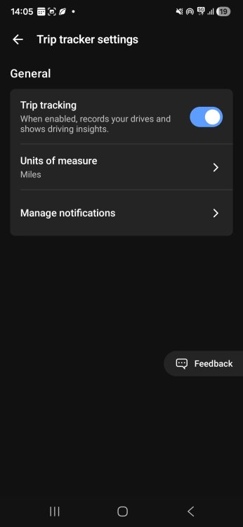

The only thing i get under 'settings' is this
Pro Account?
Yes pro ? Unless ive done something wrong here bjt i cant understand it ?

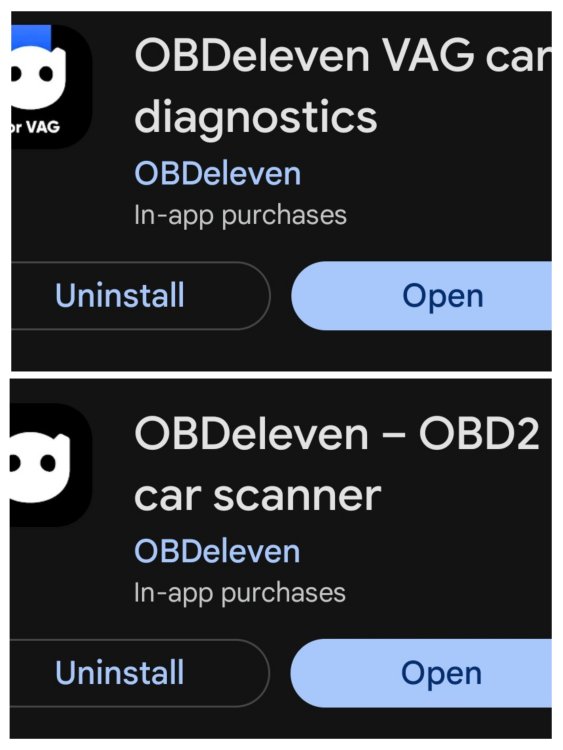

They r two versions of the OBDEleven app - OBDEleven VAG vs OBDEleven OBD2
I'm using the OBDEleven VAG version, Google Pixel phone (Android).

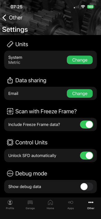

It’s in this section on mine under other and then settings.
What phone are you on? What app?

It’s the VAG version. I have a pro lifetime account and it’s running on an iPhone.

The VAG app version is better suited to us, i.e. VW, Audi, Skoda, Seat etc etc.
Hence the VAG name for the app.
The other one is less useful as it's more generic to cater for other car brands too.
It does different stuff, but not as useful when it comes to Long Coding and Adaptations that u use with the Pro.
