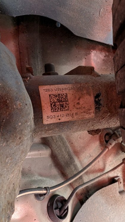

@Carlston Front strut part number is 5q3412014b from looking at the stickers I can see on them, can they still come in the two diameters you mention with this part number?
not had a chance to check disc size yet, but I have a vernier so can measure the strut diameter with that.
Find a different sticker, that's not a recognised part number.
Expect the correct part number to start 5Q0 413
  • Sponsor
Or PM me the VIN and I can look it up for you.

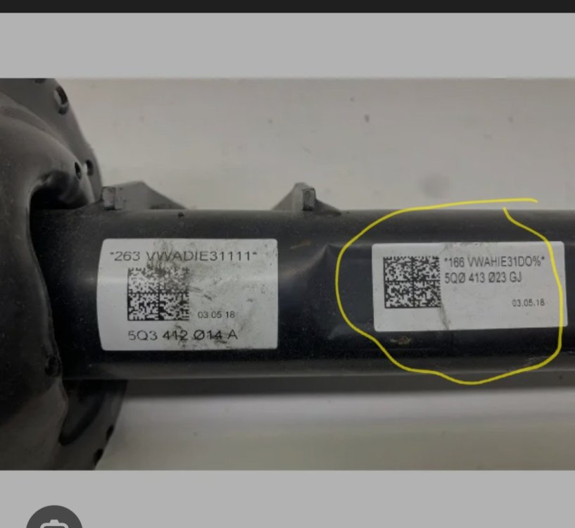

@Breezy_Pete 5q3412014b is the part number for sure,
PXL_20260514_150656795.jpgGoogle search confirm a Skoda strut for 1.6 and 2.0 TDI Octavia.
Edited by paulski
  • Sponsor
Nope
  • Sponsor
Look further down, e.g.
  • Sponsor
The sticker you've seen is possibly a part number of the whole strut assembly, which will likely exist as an internal VW Group part number that's very useful inside the factory.
No such part exists as a spare part though, you have to buy all the bits separately. Shock/spring/bearing/topmount etc.
The 5Q0 413... part number is that of the shock absorber only.
The 5Q3... part number isn't found in the parts catalogue.
Edited by Breezy_Pete
