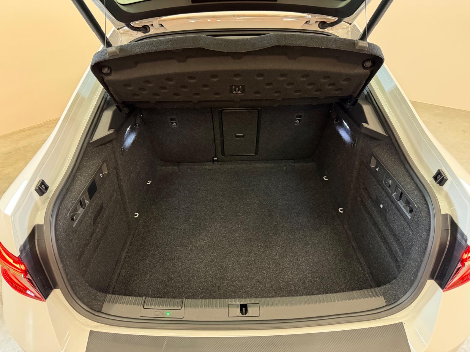

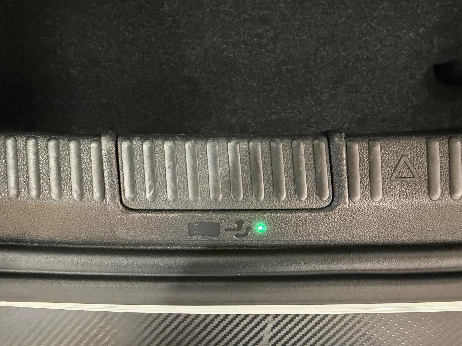

Well, I can guarantee the panel is different, as the "hole" for the luggage compartment is different.

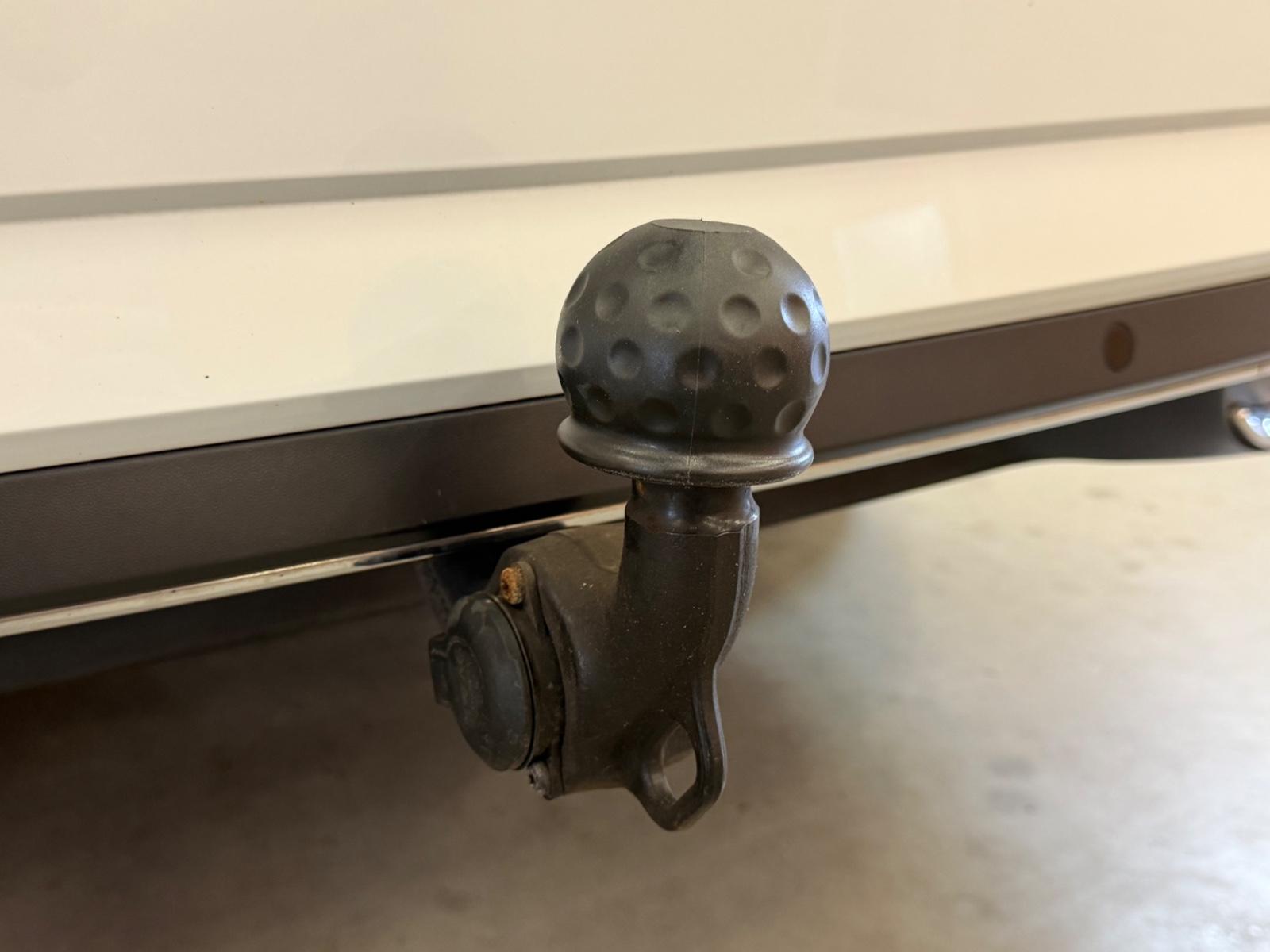

I've found a car for sale so I can show a couple of shots of it:
https://img.classistatic.de/api/v1/mo-prod/images/52/527067b8-ebd8-4ed4-bb18-ed617313f23a?rule=mo-1600
https://img.classistatic.de/api/v1/mo-prod/images/ca/ca16c8bc-e685-4f97-b861-9ce6faee99a0?rule=mo-1600
