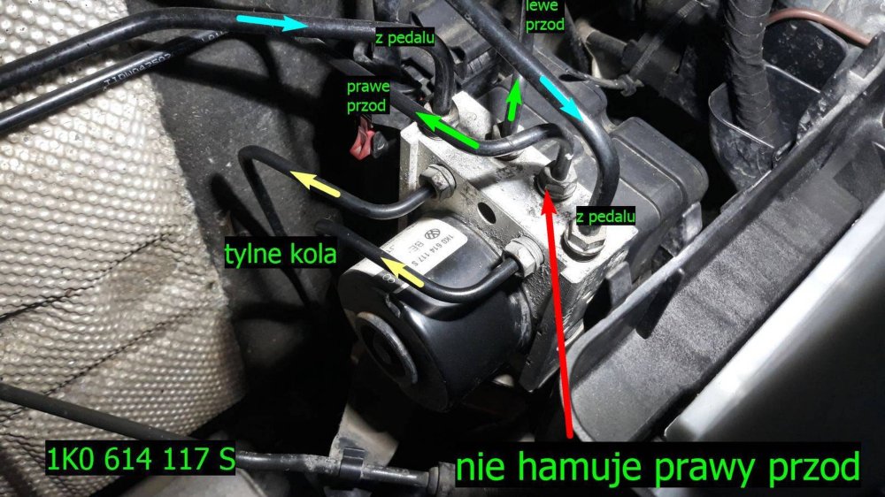

Hi all,
Looking for some technical guidance on a CANbus/diagnostic failure following an ABS pump replacement on my 2012 Octavia Mk2 FL (1.4 TSI CAXA, Bosch 8.2 ESP). The car is booked into an auto‑electrical specialist next week, but I want to ensure I’ve covered all plausible electrical causes before it goes in.
Vehicle / System Details
  • 2012 Octavia Mk2 FL
  • 1.4 TSI CAXA
  • Bosch 8.2 ESP

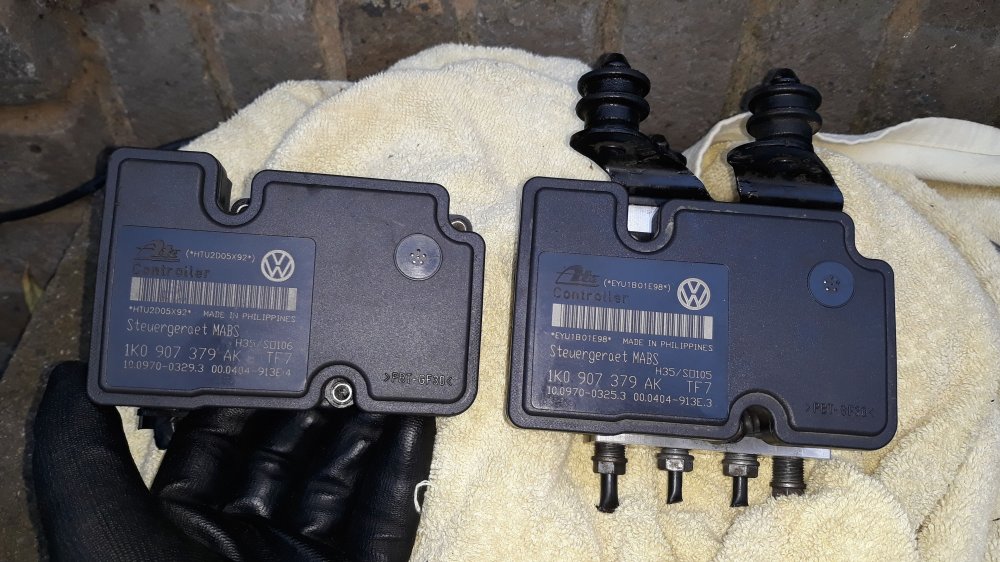

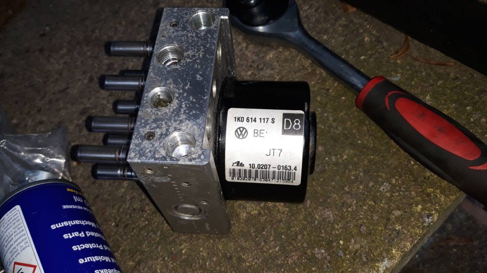

  • Correct hydraulic block: 1K0 614 117 S
  • Correct control module: 1K0 907 379 AK
  • PR‑codes and VIN match the fitted components
Background
The car failed its MOT. Initial suspicion was the master brake cylinder, but this was ruled out because the brake fluid present was from pre‑MOT work.
The actual failure was due to a blocked hydraulic circuit inside the mechanical section of the ABS pump. This aligns with the original reason for replacing the pump/module.
After fitting the correct replacement unit, the vehicle immediately lost all diagnostic communication.
Current Electrical Symptom
  • No OBD communication
  • VIN cannot be read
  • All modules non‑responsive
  • Two known‑working OBD tools (from my cousin’s neighbour) both fail identically
  • Diagnostics worked perfectly before the pump swap
This is a full CANbus dropout, not a single‑module fault.
Work Completed / Checks Performed
  • Engine‑bay fuses verified (Fuse 1 – 30A pump motor, Fuse 7 – 5/10A ABS module supply, Fuse 9 – 5A ignition feed)
  • Dashboard fuses verified (Fuse 2 – CAN Gateway, Fuse 40 – brake switch)
  • ABS 38‑pin connector fully seated and locked
  • No brake fluid contamination on connector pins
  • Battery voltage stable and above Bosch 8.2 threshold
  • No visible corrosion or overheated fuse legs
All fuses are intact and supplying correctly.
Technical Context
Bosch 8.2 ESP modules are known to:
  • Drop off the CANbus if the control‑module supply fuse is compromised
  • Half‑boot if ignition feed is unstable
  • Pull CAN‑High/Low down if internal electronics short
  • Cause gateway isolation if the module presents invalid CAN frames
Given the fuses are confirmed good, the fault is now likely to be:
  • A CAN‑line disturbance introduced during pump/module installation
  • A ground reference issue affecting the gateway or ABS node
  • Internal failure of the replacement ABS module despite being the correct part
  • A wiring harness issue at the ABS connector or gateway node
  • A gateway protection response due to invalid signalling from the ABS node
What I’m Looking For
Before the auto‑electrical appointment, I’d appreciate insight into:
  • Known Mk2 weak points in the CAN‑High/CAN‑Low wiring around the ABS pump area
  • Any ground points near the ABS hydraulic block or battery tray that commonly cause gateway isolation
  • Whether Bosch 8.2 ESP modules can present CAN‑bus shorts or malformed frames even when the hardware is correct for the vehicle
  • Any hidden connectors or splice points in the Octavia Mk2 CAN backbone that may have been disturbed during pump removal/refitting
  • Additional electrical checks that are worthwhile before the garage performs oscilloscope‑level diagnostics
I’m trying to eliminate simple electrical causes before the specialist takes over, but I’m aware that deeper CAN interrogation (gateway pings, bus loading analysis, frame integrity checks) will require VCDS/ODIS and proper bench tools.
Any technical input appreciated.
Thanks
Tom
