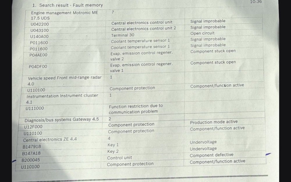

Hi everyone,
I recently had my 2020 Škoda Fabia 1.0 MPI (Engine code: CHYE) scanned after a few issues popped up, and the diagnostic sheet has flagged quite a few codes across multiple modules.
I wanted to ask the professionals or anyone familiar with the platform if they have seen this specific combination of codes before, particularly the B200045.
