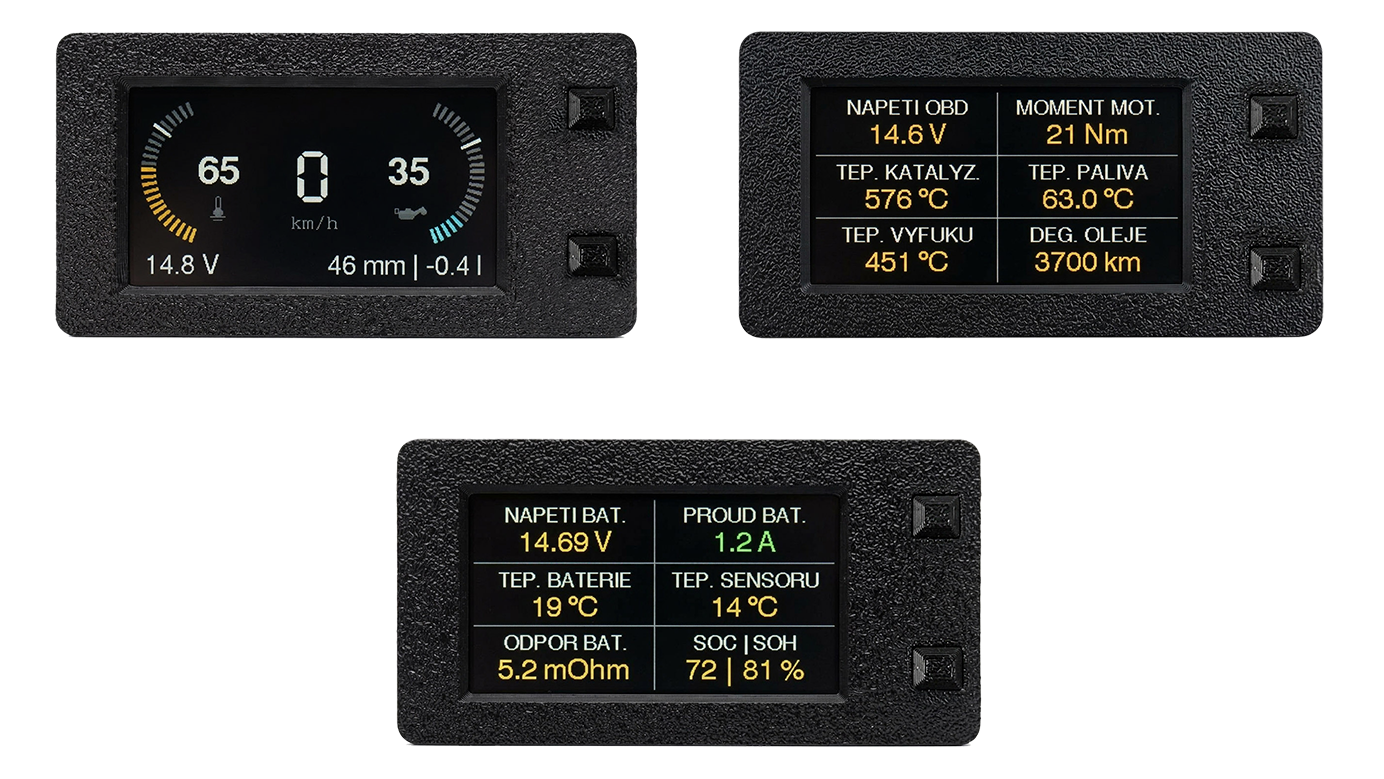

The monitor provides a real-time overview of selected vehicle parameters. Some of the most useful include:
  • Engine temperatures – coolant and engine oil temperatures, helping you monitor how the engine warms up.
  • Driving and engine data – a digital speedometer, voltage and engine torque.
  • Additional temperatures and oil data – for example, catalyst, fuel and exhaust gas temperatures, as well as available oil degradation information.
  • 12V battery status – voltage, current, temperature, internal resistance, state of charge and state of health.

Colour-coded values for quick reference
The display does more than simply show numbers. The individual readings use dynamic colour coding to make their current status easier to recognise and highlight important changes.
For example, the battery display uses colours to distinguish between charging and discharging and to indicate voltage that is too low or too high. For temperatures and other parameters, the colour coding depends on the relevant conditions for each value.
