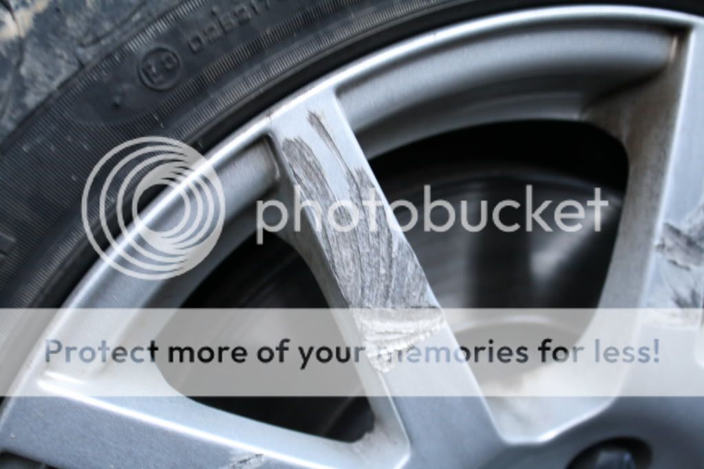

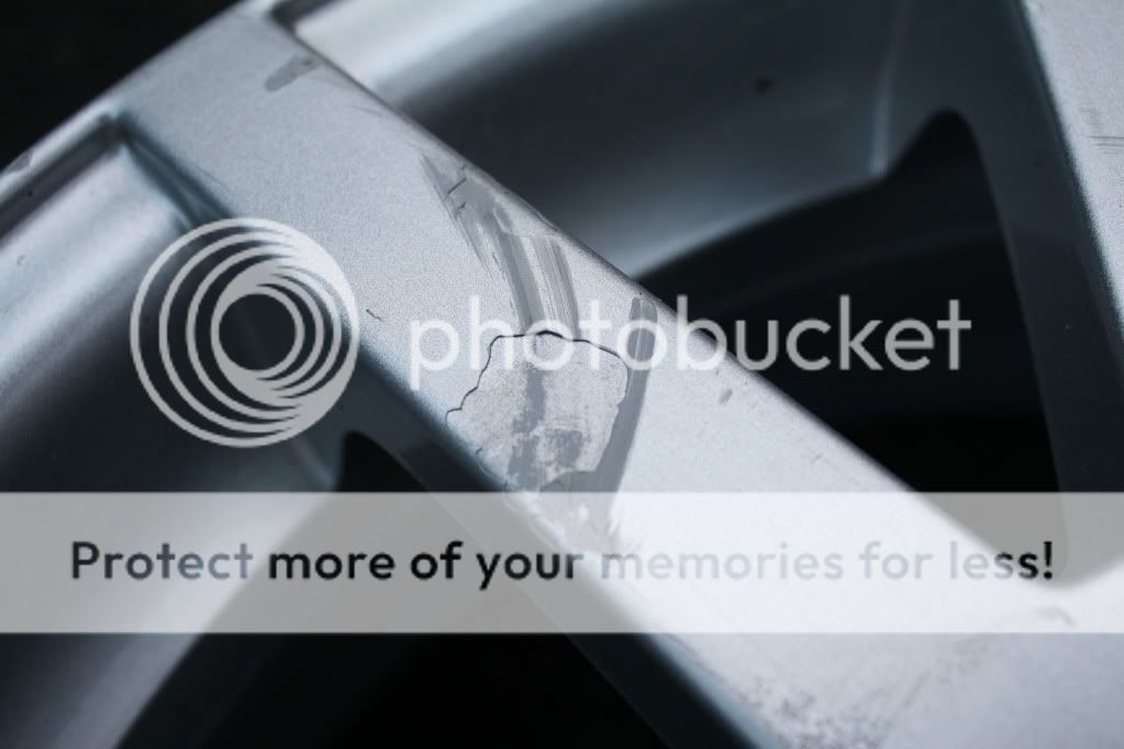

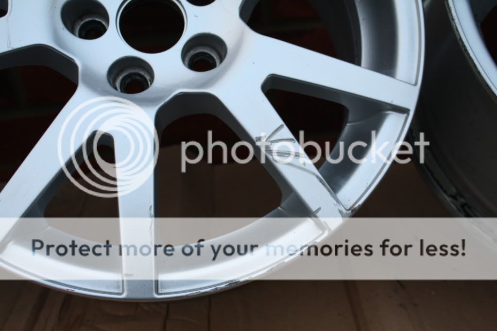

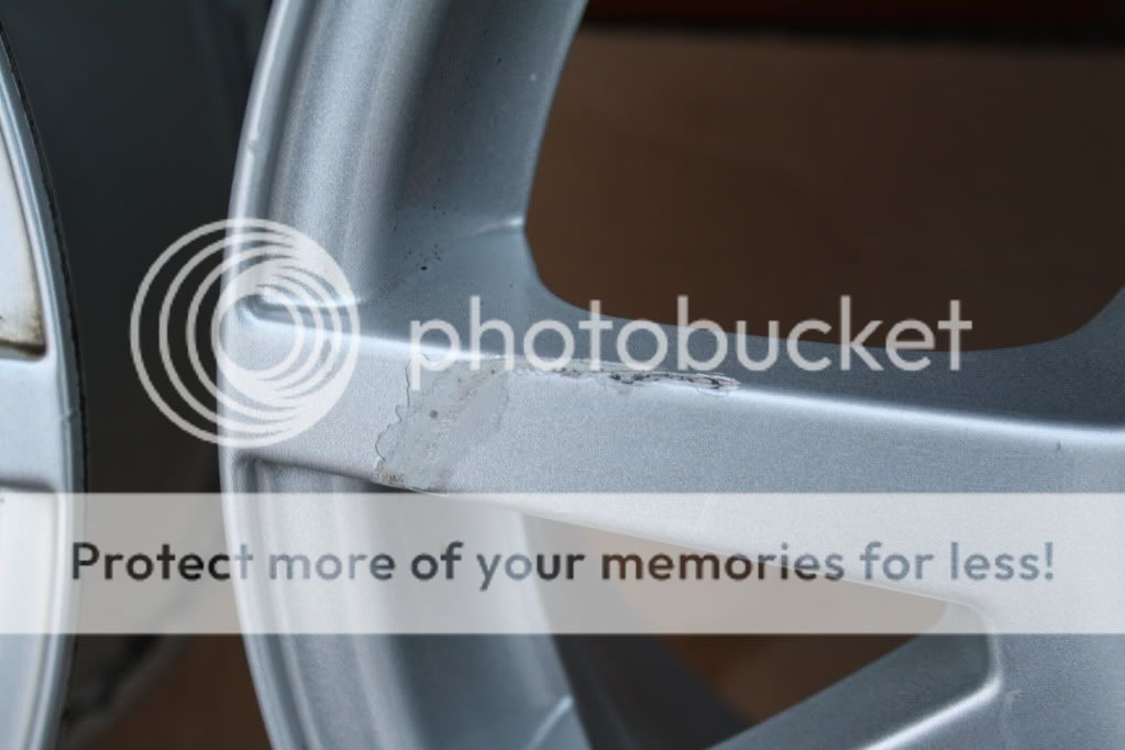

While the second sets looks ok from a distance
Posted Image
when you get up close there is various damage to the faces of all 4 wheels
Posted Image
Posted Image
Posted Image
Posted Image
and they are also very clearly from 2 different sets of wheels (2 of the wheels are actually wheels I sold to Gareth back in May)
2 are smooth and in good nick
Posted Image
Posted Image
the other 2 are... um.... very much not
Posted Image
Posted Image
these are the 2 that i previously owned and you can see why I got rid originally!

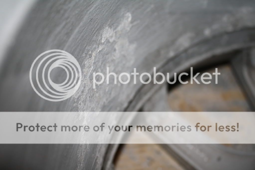

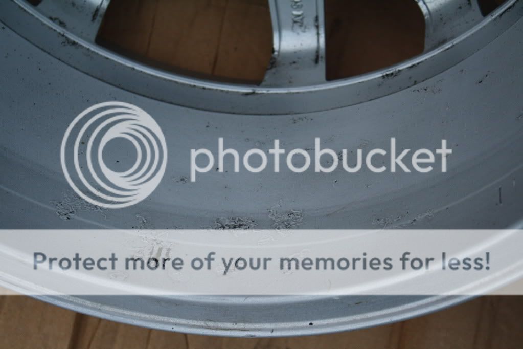

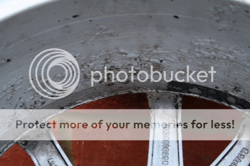

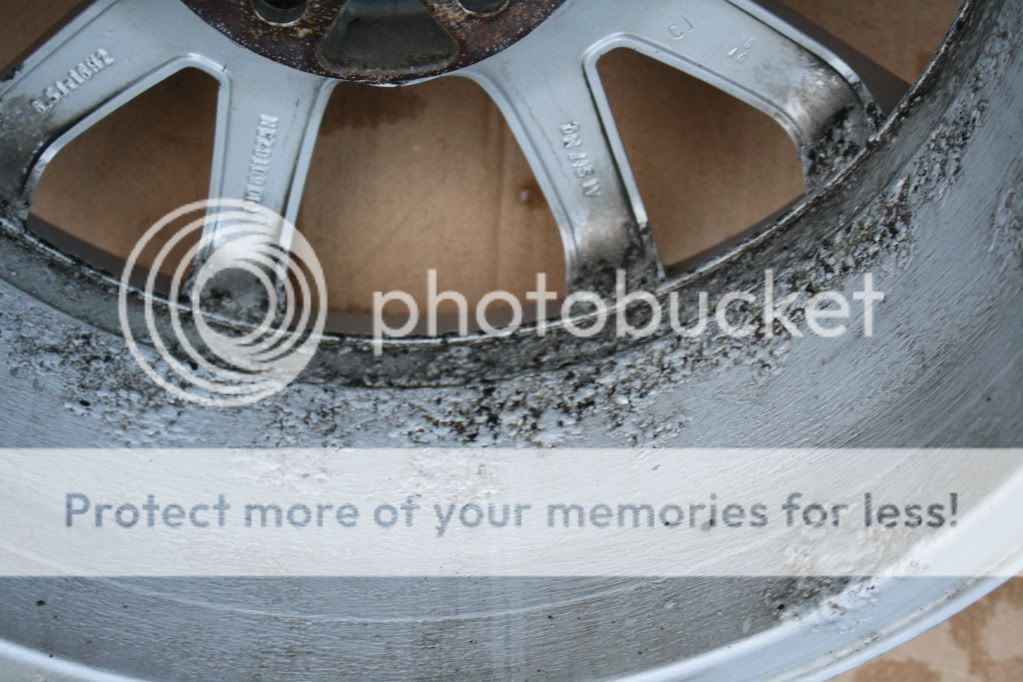

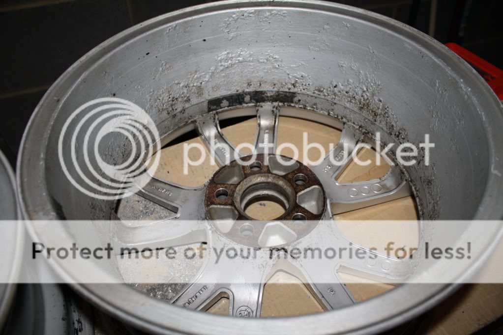

Now the bubbling on the inside of the rims is an absolute killer.
I did attempt to stop the corrosion when i owned the wheels previously with a coat of silver hammerite but that clearly didn't work. I think as my hammeriting didn't extend over the lip and onto the face the moisture continued to get in behind the paint and the corrsion continued.
So it was out with the wire brush and a big flat headed screw driver and started chipping away at the damage.
Half an hour later and one rim has the worst removed but will still need some vigorous sanding to get a smooth finish but has gone from this:
Posted Image
Posted Image
to this
Posted Image
Posted Image
Leaving behind this
Posted Image
Posted Image
I find that where the alloy beneath was actually smooth the Hammerite pretty much slid right off so i think most of what has come off is my previous handy work but hey ho.
Happy so far although when i did attempt to sand one of the smoother sections of the rim I found that the coarsest wet & dry paper in the assorted pack i bought (P600) wasn't up to the job. I think it'll be fine to key into the lacquer on the face ready for priming however removal of a layer of Hammerite and the original paint was a little beyond it; so i'll be heading back to B&Q to buy something a bit more heavy duty.

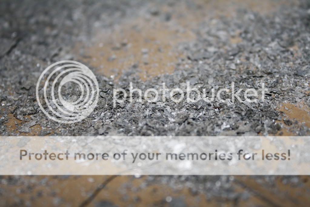

called in to B&Q on the way home and bought the coarsest sandpaper i could get - a 60 grit for removing "stubborn paint and built up layers"
Given the lack of impact a wire brush had had on the rims I didn't have high hopes.
I couldn't have been more wrong the stuff ripped through the coats of Hammerite like it wasn't there, then proceeded to strip of the lacquer and original Skoda paint too if you kept rubbing.
Posted Image
you can see a massive the difference between before and after (or after and before as they are here)
Posted Image
Once the insides were smooth i set about the faces and spokes with a combination of the sand paper and wet & dry paper.
Only issue is that the wheels are so intricate that you can't really get a normal sanding block in there so it was all done by hand.
I'm going to try and find something suitable to turn into a mini sanding block but for now i'm off out to commit some crime as my finger prints no longer exist :)
It's was still dusty as i'm yet to wipe them down but i think they have keyed in pretty well
I'm actually quite liking the "smokey" look the sanding has given them! :D

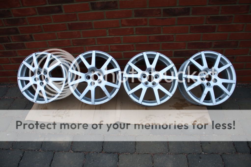

Wheel number 2 done!  :thumbup:
Posted Image
Ok so this is the picture of the first wheel again but the second one looks exactly the same! :)
Was done last night and have today had a day off as my fingers are sanded to oblivion
No more money spent
so running total still £140.51
Approx time spent - 3 hours 30 mins
I was thinking that an etch primer might be a good idea given how deep some of the sanding has gone.
Might get a small can and do the first coat (or at least the worst patches) as etch, then normal for the other coats
