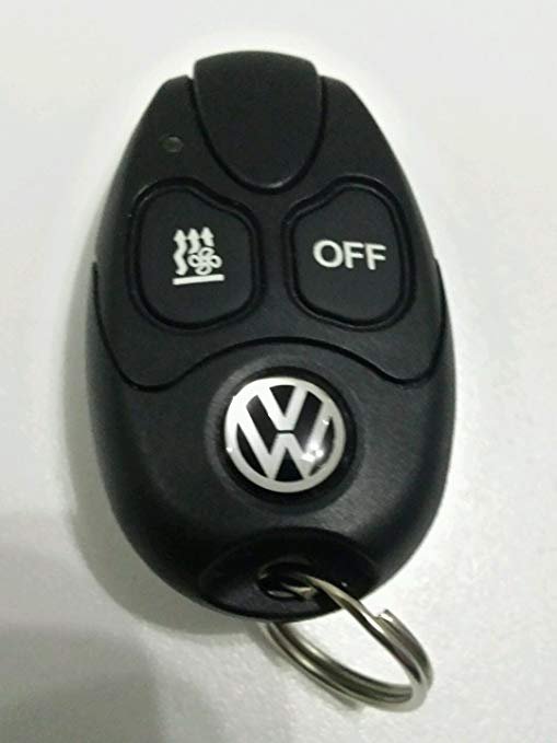

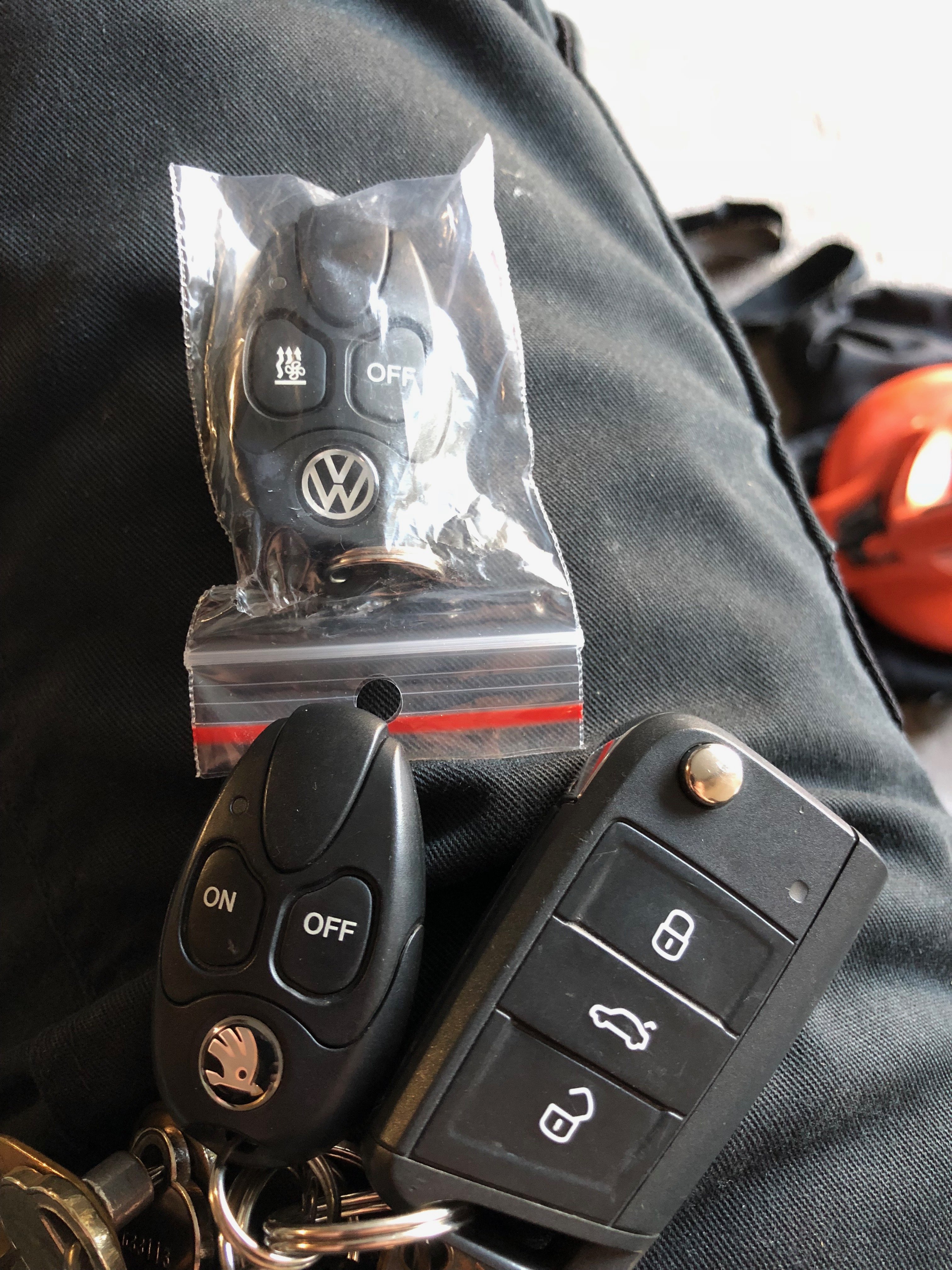

I bought a T91R on Ebay. I have Skoda Octavia 2014. Under the battery on my original remote it says T91R-SKO and the one from Ebay that has VW logo says T91R-WOS.
Are they brand specific? Because I cant get the remote to program. Pulling safe 7 as instructed. Even checked with my remote when that fuse is pulled. Does not start the heater.
When I push OFF it blinks red a couple of times fast. But later when i try ON it just blinks green and nothing happens.
They look exactle the same. It should work right?

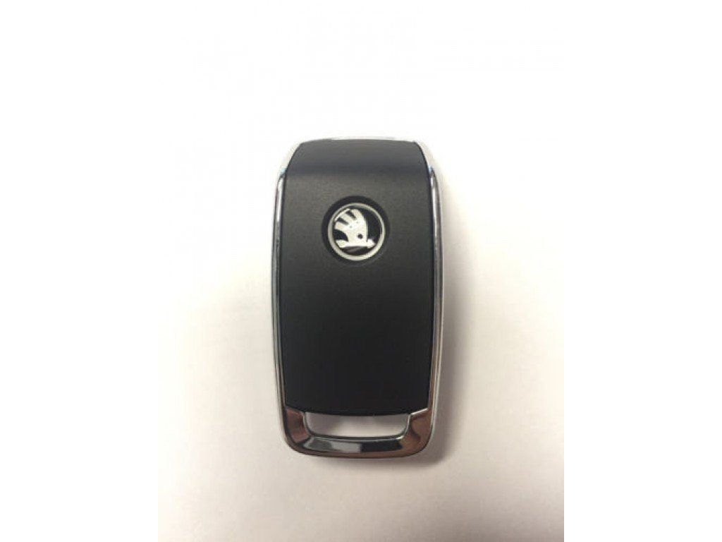

does anybody know is it possible to add or replace my old style webasto remote with a new one? (photos attached)
They have the same buttons, no additional electronics, but my oct is 2015 with the old style remotes, and I saw one 2016 that has the new style..
I ordered this one from eBay and I really hope that it will work because it is so much nicer:
