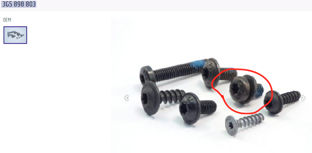

  9. I got this bolt from a sunroof repair shop. They were kind and gave me one bolt free of charge.

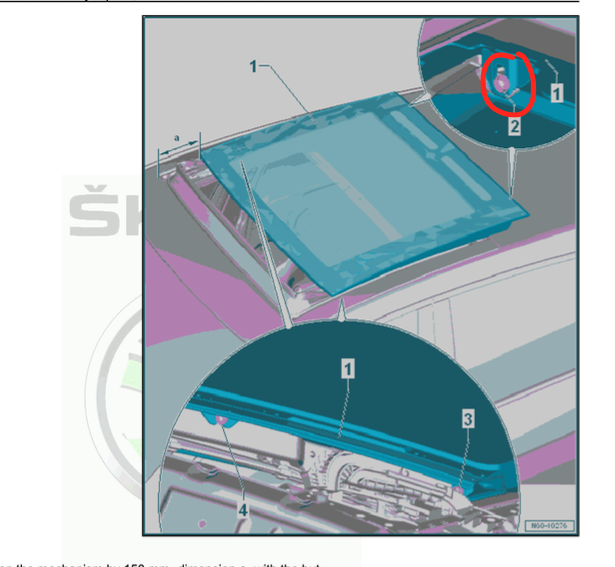

  21. Hello everyone, I am searching for sunroof alignment screw which caused me sunroof cracking noises. It is included in a set of securing bolts 3G5 898 803 but I need only one screw. I need this one in the picture but again I don't know what is the name of this screw to search on internet to find it. Can someone help me with it?
