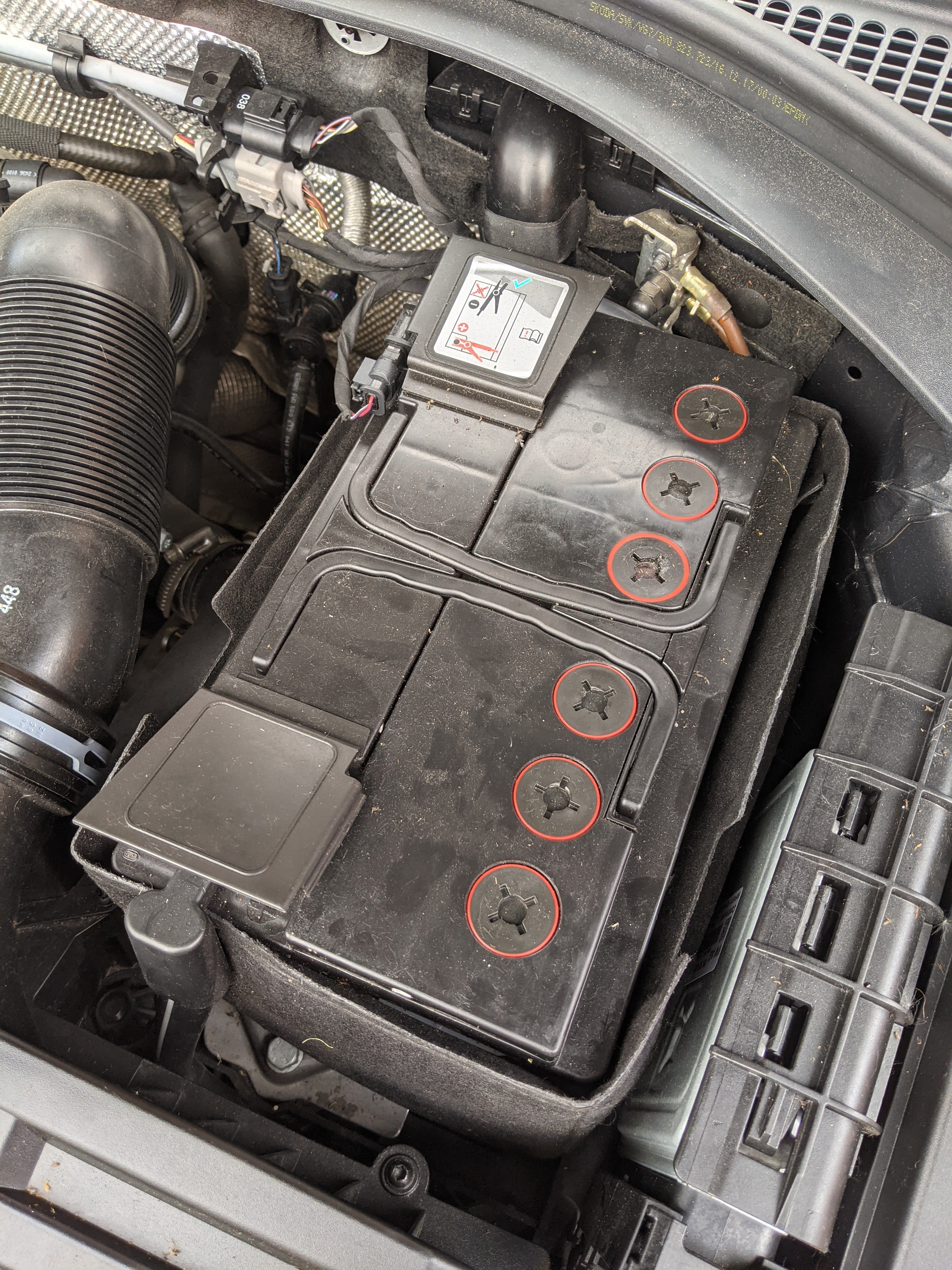

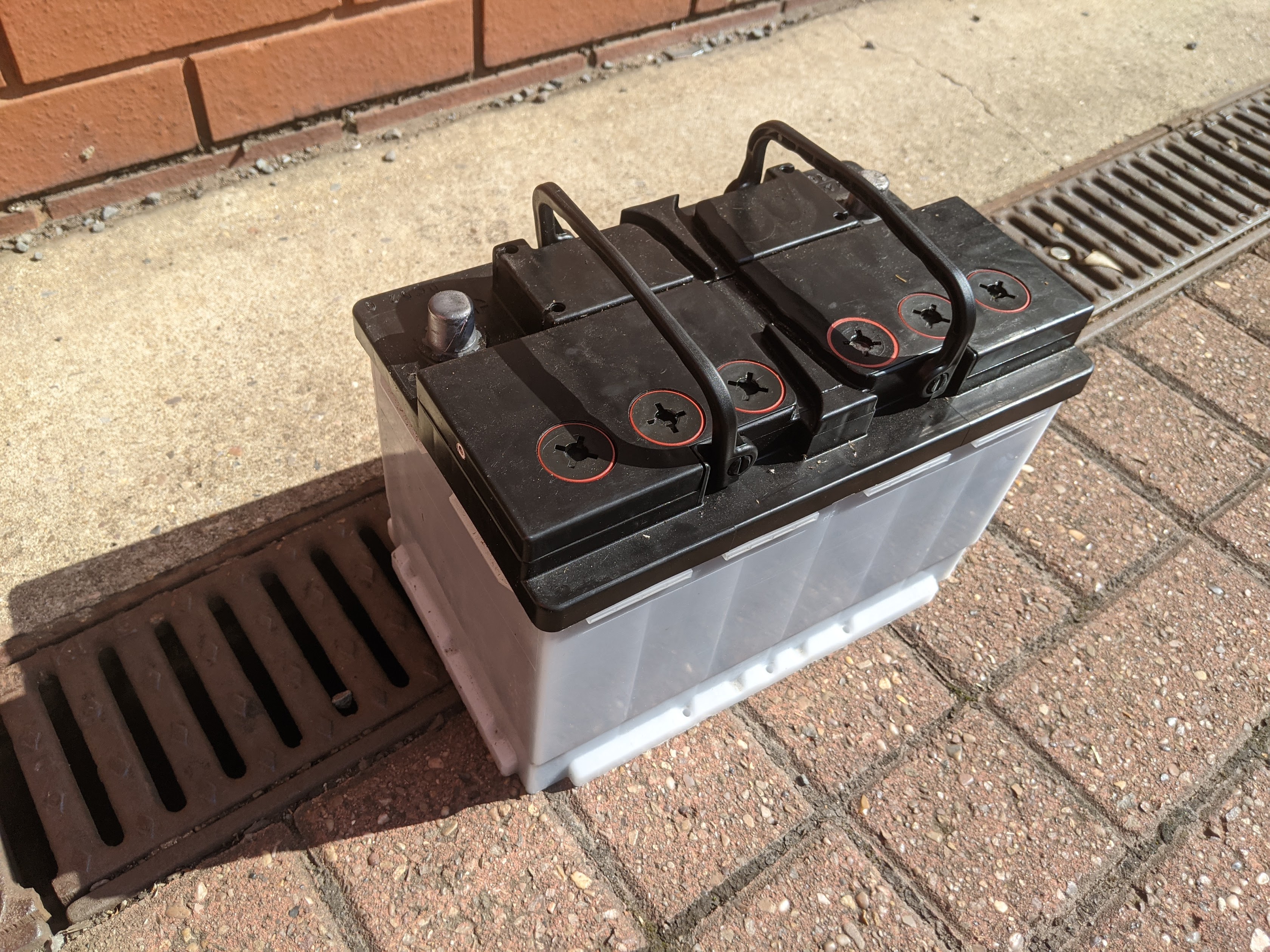

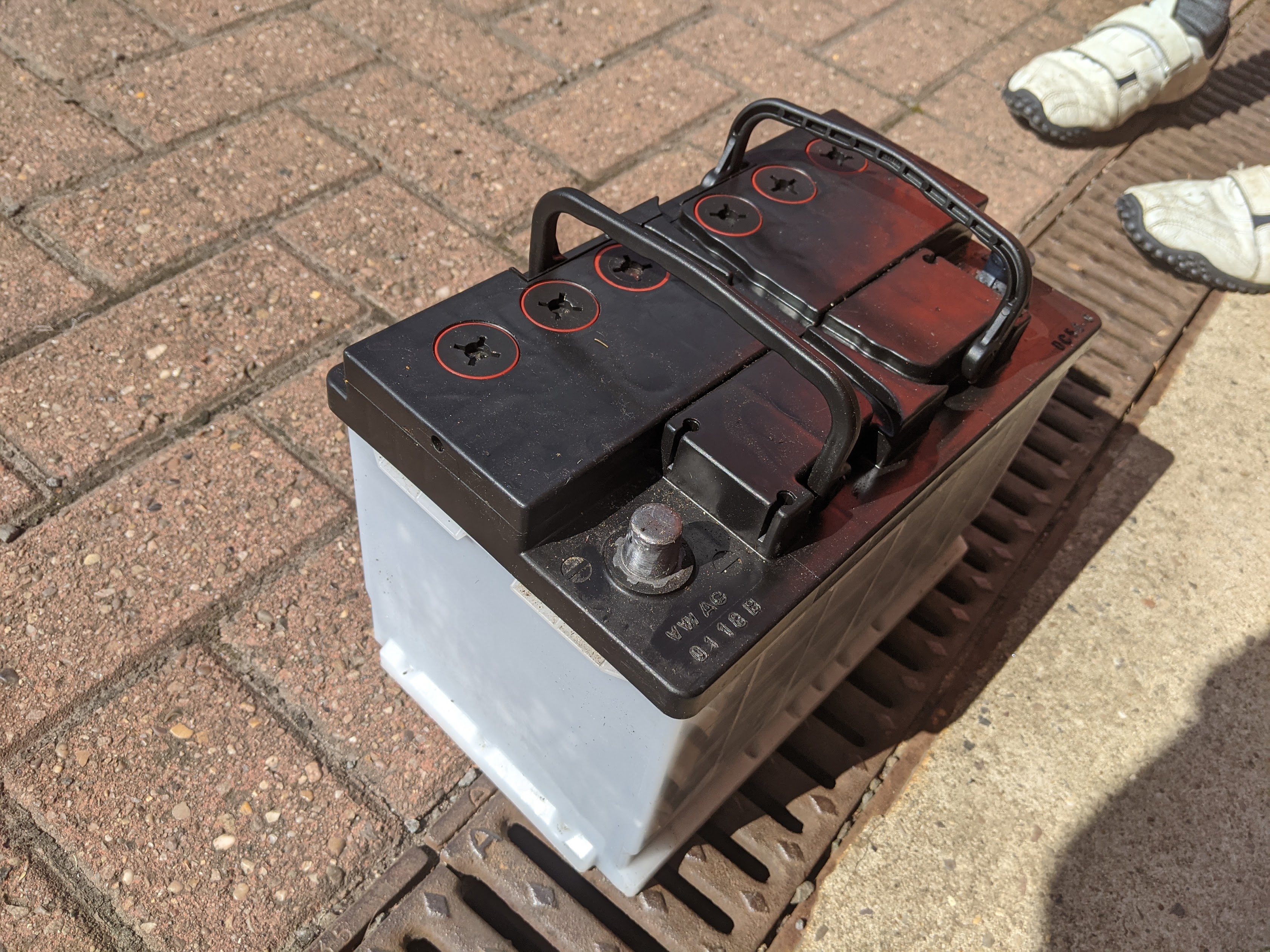

  9. Hi folks, thanks for your help on this. I went over to an Independent Specialist who have now installed and coded an EFB+ for me. Time to speak to the dealer as this was an Approved car bought only 2 months ago. Although I have little confidence that they will be interested. Having taken the old battery out, there are indeed no stickers. The only marking stameped into the plastic is "VW AG 0118B", which doesn't throw up anything on Google. Does anyine recognise this? Is it perhaps a (incorrect) VW part which has had its stickers removed?
  10. Yes, I will probably post there. I think (hope) the days of dealership monopoly are numbered for those that don't offer an exceptional service to customers. When the online dealers are offering no-quibble returns and detailed condition reports some of the shady dealership practices just can't continue for the long term.
  11. This is really helpful. There is a date stamp on the flap but I'm not sure if this came with the battery or the car? The date is correct. So is there usually a marking on the terminal itself? I've never noticed that before. If I throw that Varta AGM in will it harm anything if I don't get it coded for a week or two? I had the Bimmercode app for the old BMW to code new batteries, it was easy. Need to check out some of the options above for VAG.
  12. Thanks for confirming. I just assumed the markings were on the side but it seems not. The Approved Warranty guide does in fact say batteries are excluded. I'll go to my local VAG specialist whom I actually trust. They looked after my old 5 series very well. In all honesty, I had a major battle with the dealer just after purchase over another issue. I don't have the fight left in me. Life is too short. The jury is still out on the brand for me, but this'll 100% be the last Skoda I buy from an official main dealer. I've had dealings with three Skoda dealerships now, and all have been truly terrible. I have come to the conclusion that the 'approved' scheme is a marketing gimmick which is very hard to hold the dealer too when it comes to it. Even Skoda UK admitted to me that they (as a customer service team) have no means to hold their own dealers to account if they don't want to co-operate. They can make calls and send emails but there it stops. Any real power of sanction sits so far up the corporate tree that it's very had to get any traction as an individual.
  13. I didn't pay much attention to it, but now you say it... 🤦🏼‍♂️ This is a Skoda Approved car! It's not worth the paper it's written on. Can I replace it with a Varta Silver AGM and recode using ODB Eleven via my ODBC adaptor? https://www.tayna.co.uk/car-batteries/varta/e39/
  14. Thank man, all really helpful. I'm beginning to think it may be a very generic battery not up to the job. Picture attached. It wouldn't surprise me to be honest. The Skoda dealer it came from have already proven themselves to be pretty shabby on other issues with the car.
