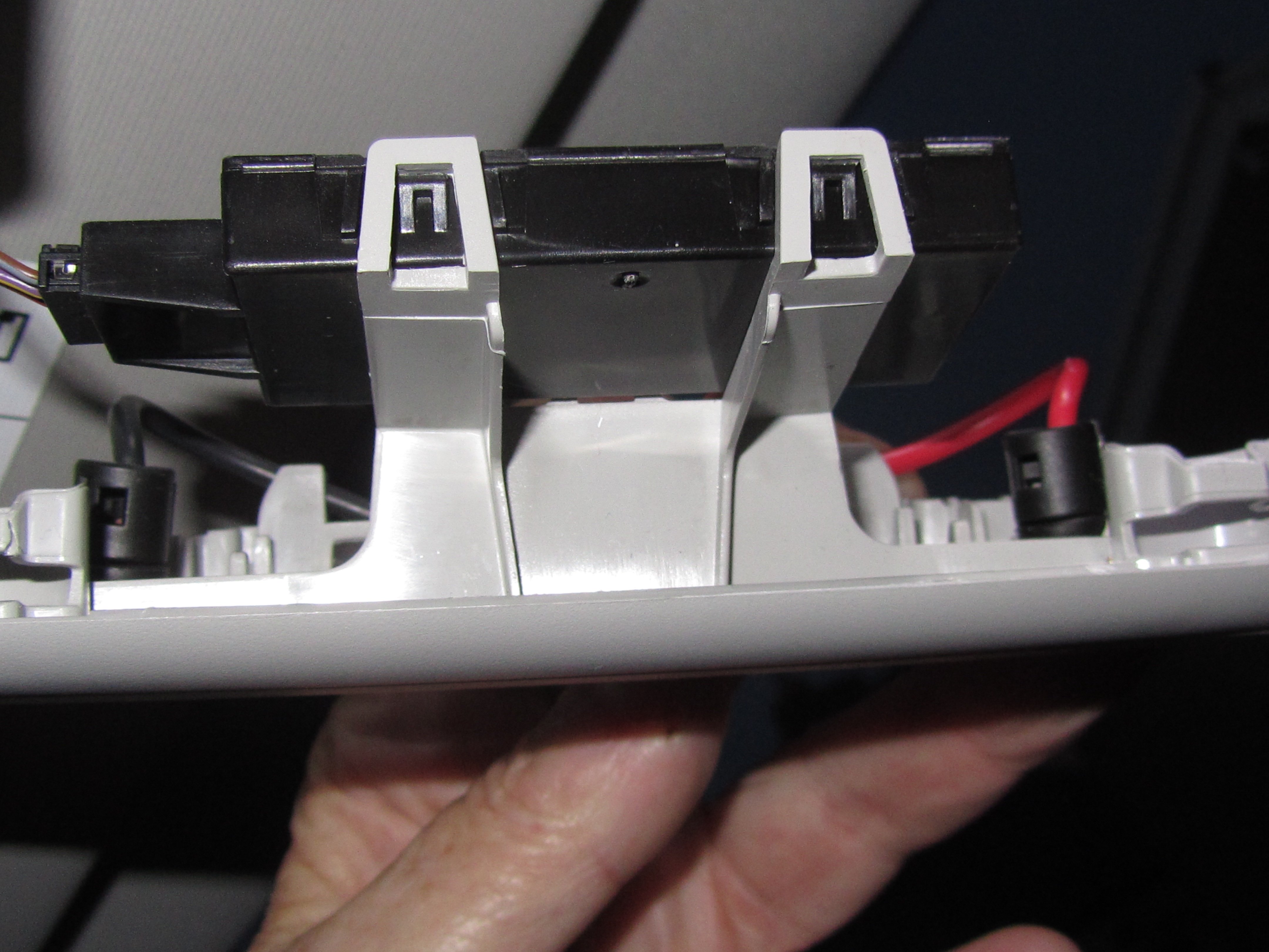

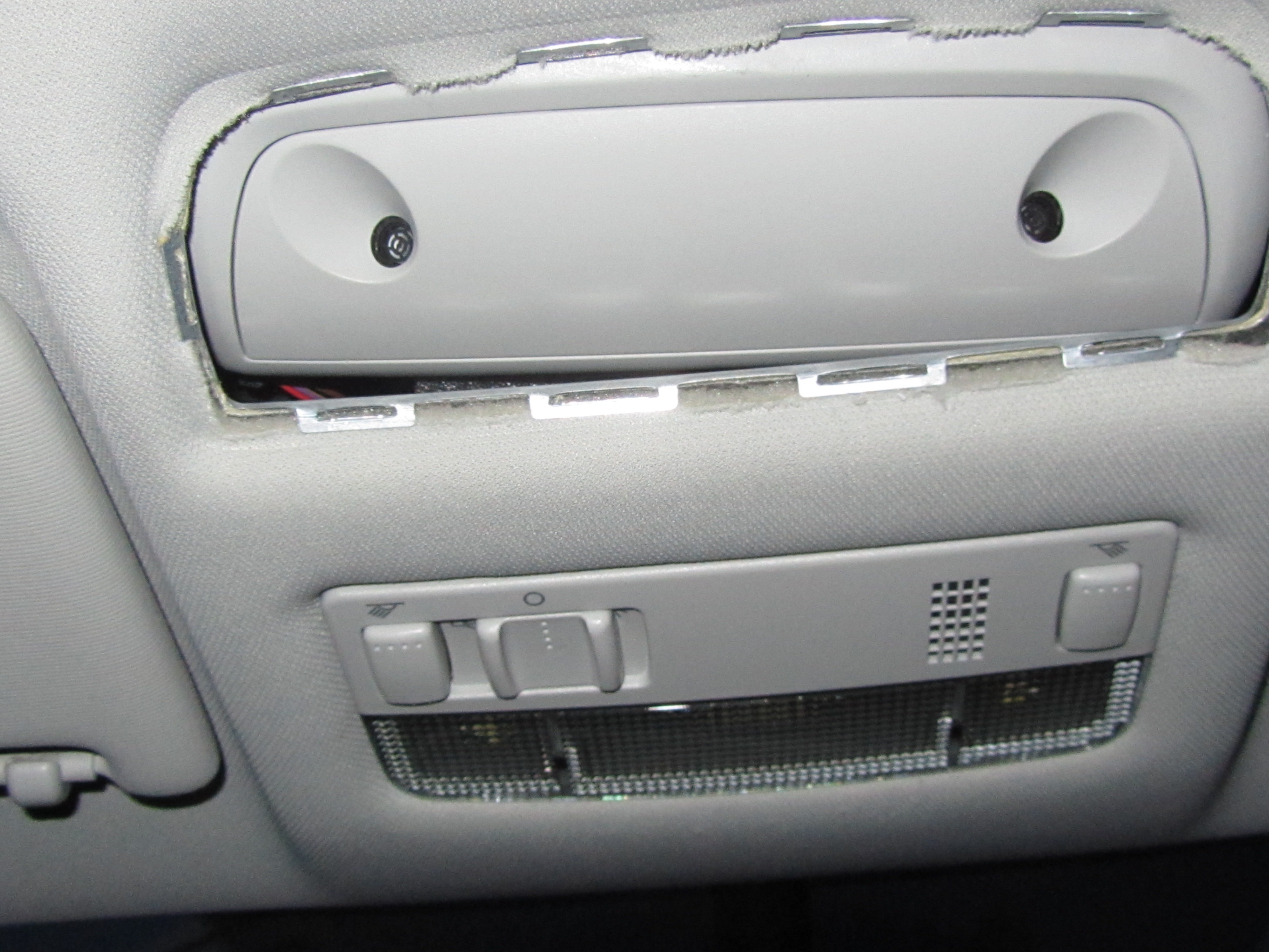

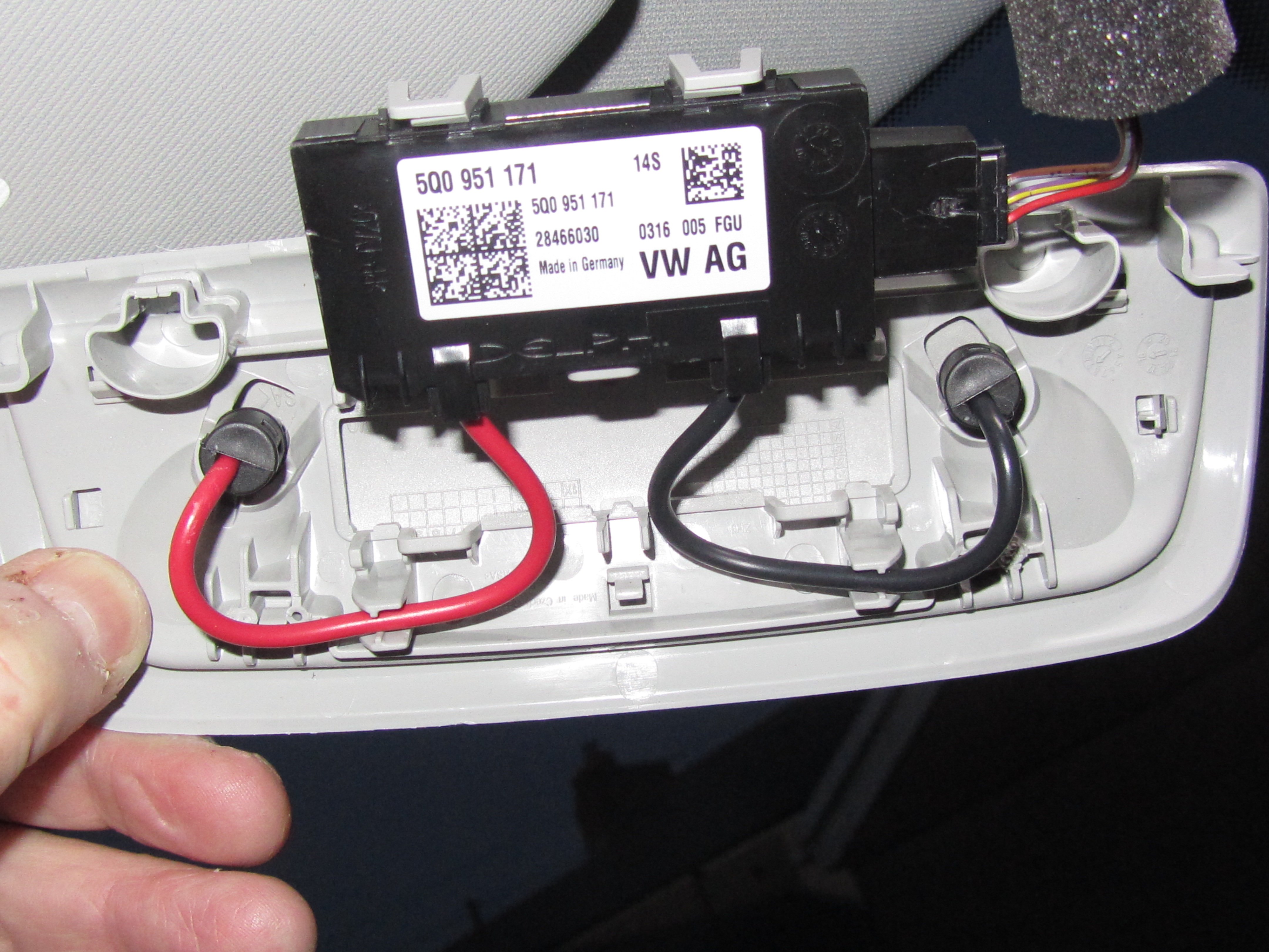

Just to add the last photo was the unit pushed up inside the cut out to stop it coming out when driving , I did try to unplug the small plug on the end of the unit but it's like the kripton factor again no sure which way to push pull or tug

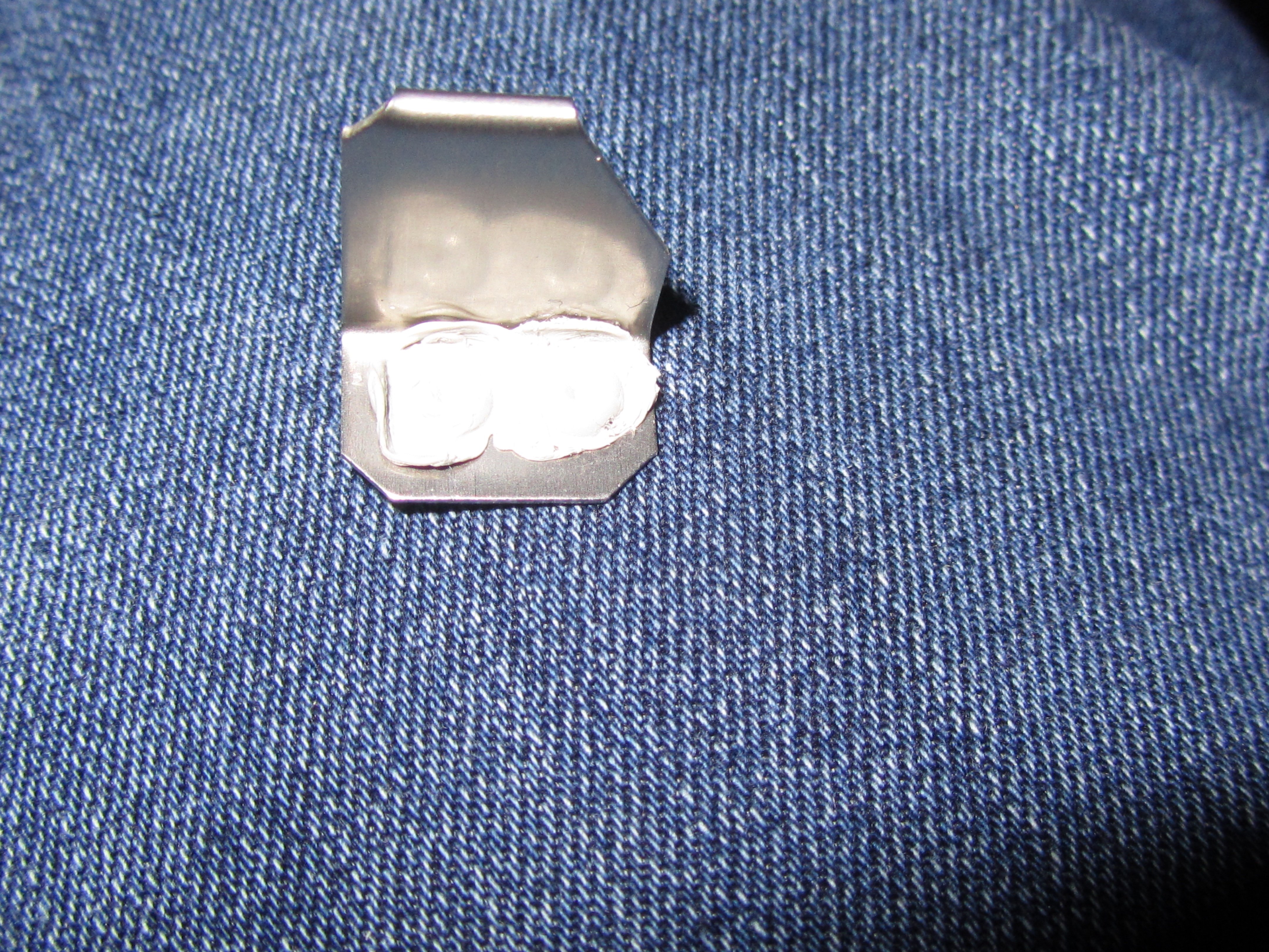

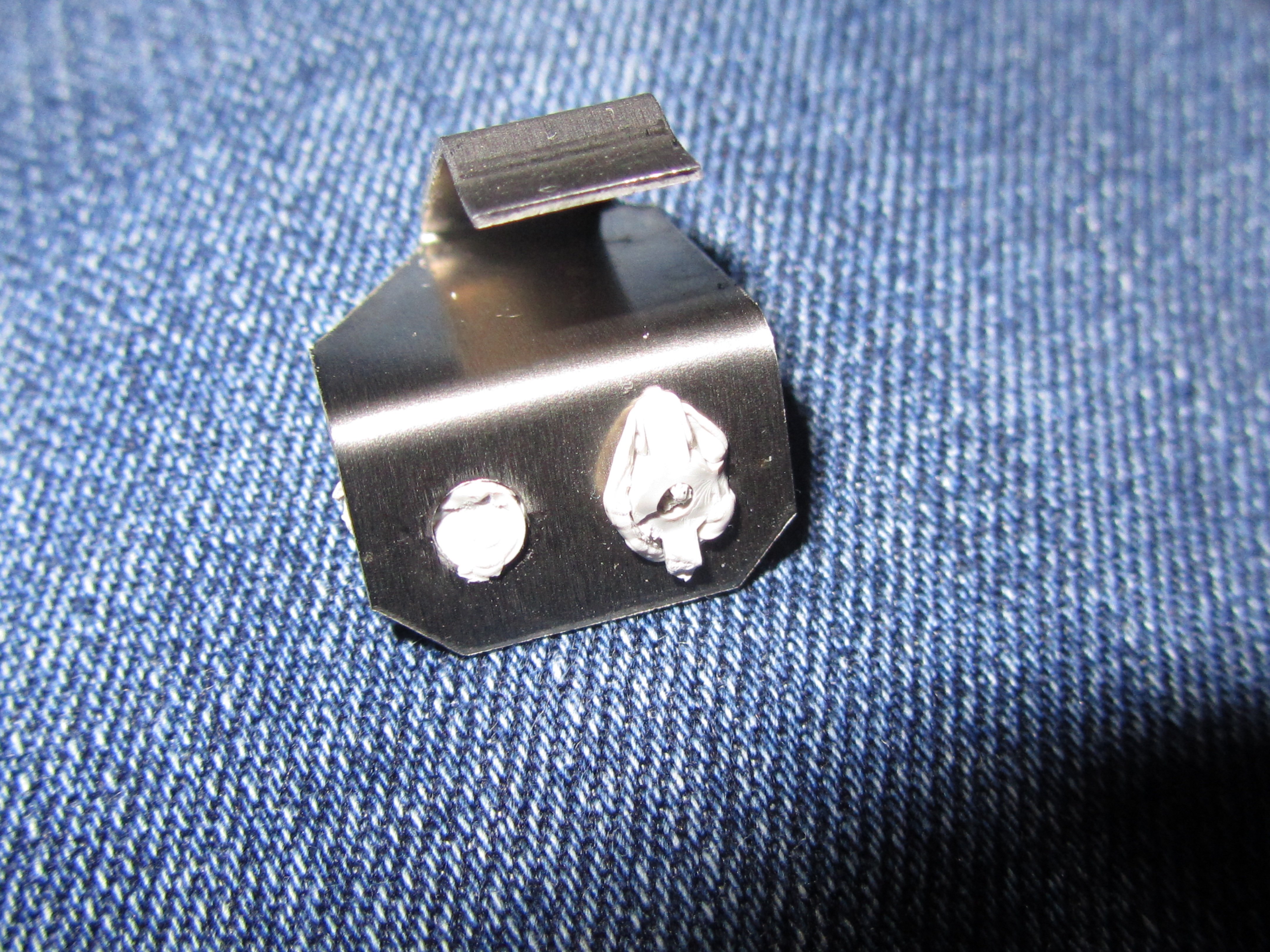

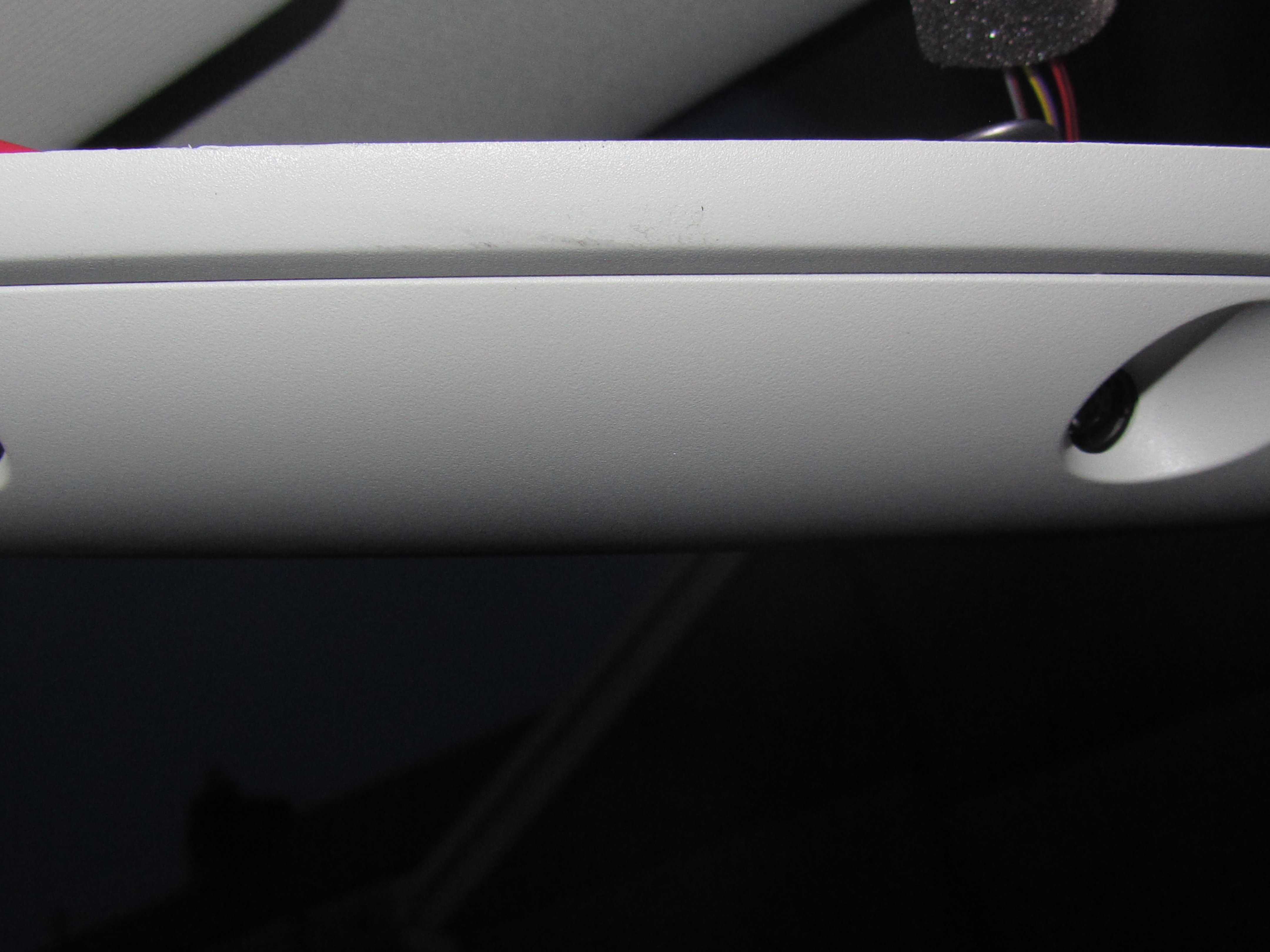

Anyone know where this clips fits onto as I have looked on the plastic housing and cannot find where it has broken off ,the alarm housing keeps falling down it looks like you push in in towards the front of the roof opening then this clip some how holds the unit in place but as you see it has broken off where ever the only other option is to bond it back in place as I have tried all sorts of double sided tape and they hold untill the car gets hot and the unit again falls out, asked in dealers but they want me to book the car into thier workshop and leace it there not that interested by that
