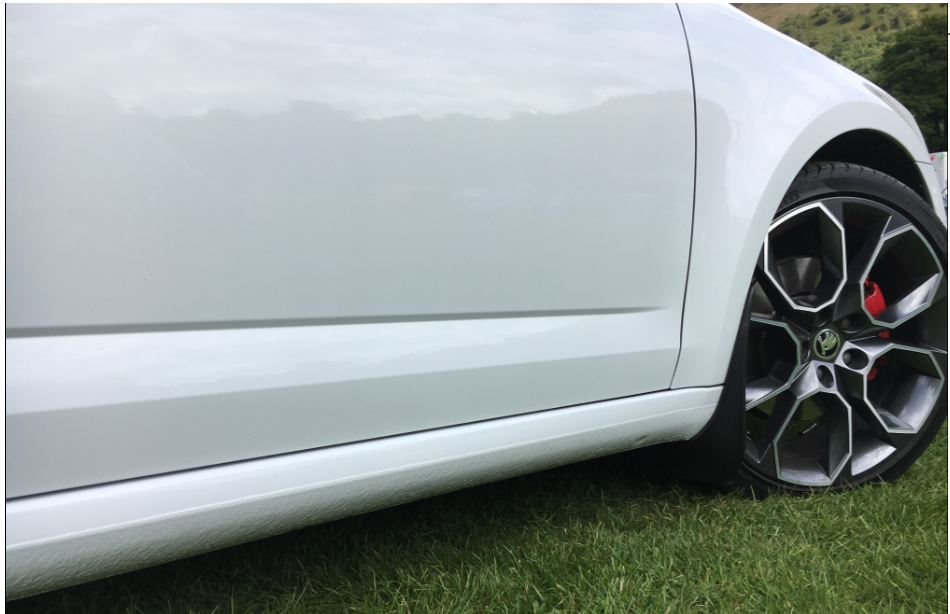

  7. Standard anthracite 19”. I have never had an issue with them but I do go around anything that looks like a pothole so they don’t get wrecked. The ride quality is fine. Just marginally more input from finer road surface harshness over a softer tyred 18” but no where near bad or off putting. Avoid kerbs and placing face down if taken off the car as the front face stands proud of a 225 tyre.
