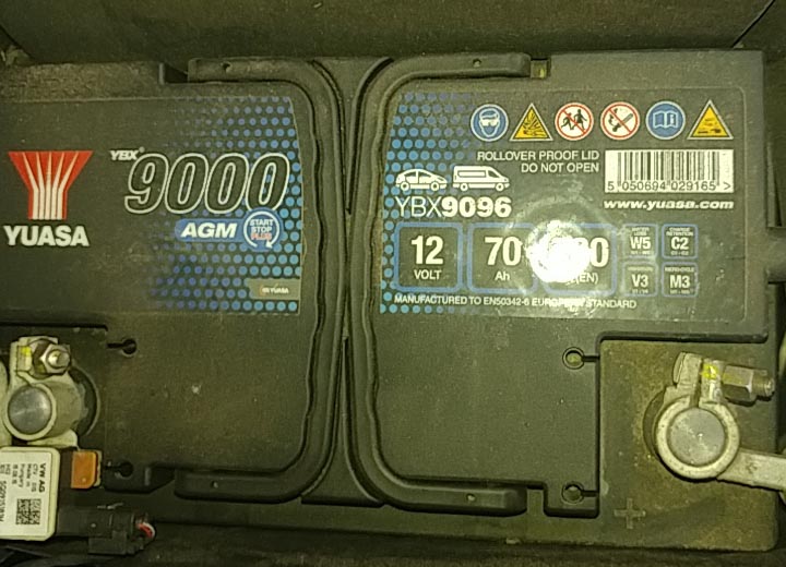

I bought a new battery (Yusa 9000 AGM YBX 9096 see pic) a couple of years ago, Although advertised by the supplier as OK for the SKoda it was not a make known the the Battery Management System.
So I used VCDS to change the serial number in the hope that technology would treat it as a new battery and work out how to charge it properly.
This seems not to have happened I've been running withoiut Auto Start Stop (except for a brief period after a long {>1hr} drive) since then {no great hardship!}). Occasionally I would get a low battery warning but it always went away after even a short drive.

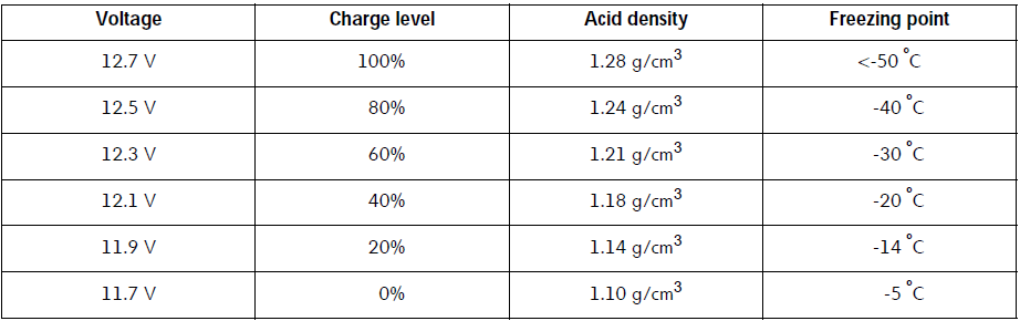

Your values seem a little low at 12.3V after a run.
SOC State of Charge starts at 0% for 11.7V and 100% is 12.7V, so a 1V difference between empty and full
What I would recommend is to charge again your battery, and check voltage at the end of the charge cycle directly on battery terminals.
Then wait two hours, unlock car, open bonnet and again check voltage quickly, some control modules will be awake, but will give you a rough SOC.
