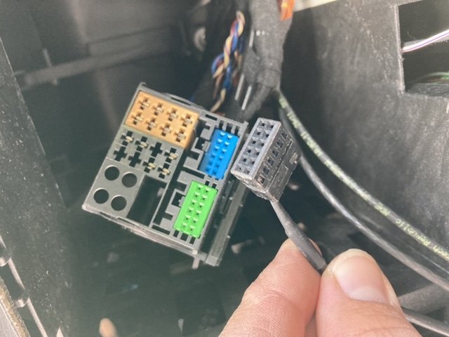

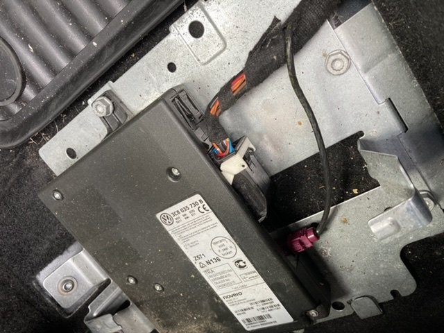

  7. I did. If you check my topics and posts you’ll see an entire thread for not. Basically bought the radio from a Yeti and got it coded. Few extra bits installed as well. I bought our radio from retrofitsw.co.uk. You’ll likely need to add a microphone and disable/unplug the old Bluetooth module.

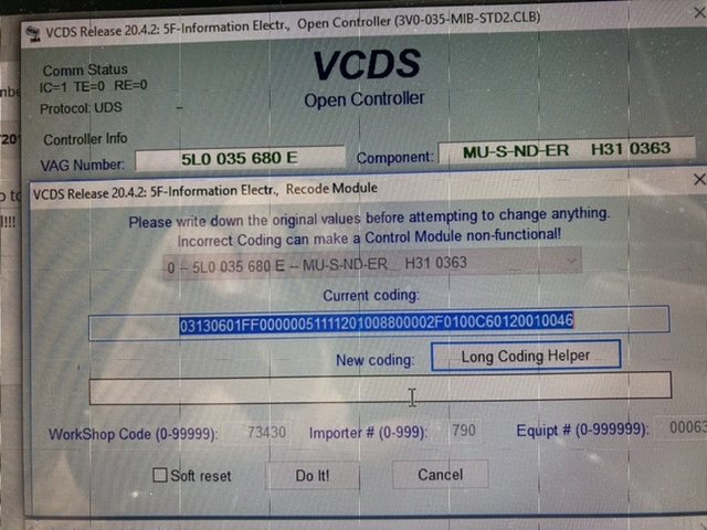

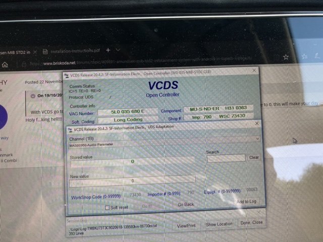

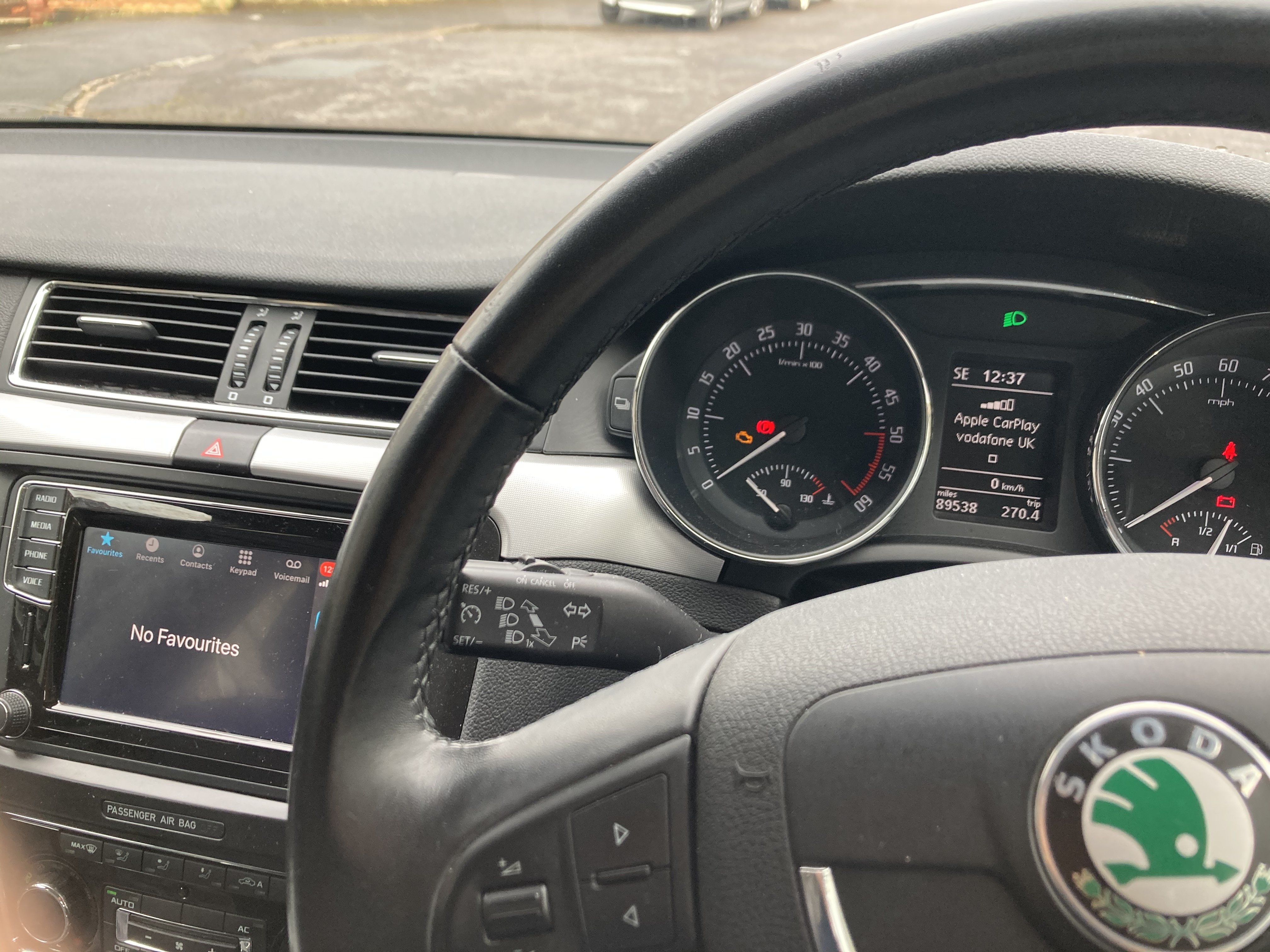

  11. So I can't get the MFSW phone button working correctly with CarPlay. When pressed it just shows the CarPlay info in the MFD (photo attached of result). I've been in and pulled my VCDS logs for the Amundsen unit on 5F and the car itself. I've checked the coding for byte 16 and the button is enabled. It works correctly for standard phone mode as far as I can tell, pushing it tends to redial the last number. My basic logs below - the battery regulator fault I believe is because of the car detecting a parasitic draw from my dash cam I was installing at the time (now with parking mode added) which no longer causes issues. Monday,09,November,2020,12:12:24:51726 VCDS -- Windows Based VAG/VAS Emulator Running on Windows 10 x64(Parallels) VCDS Version 20.4.2.0 (x64) Data version: 20200730 DS317.0 www.Ross-Tech.com VIN: TMBKJ73T3C9020618 License Plate: Mileage: 144100km-89539mi Repair Order: -------------------------------------------------------------------------------- -------------------------------------------------------------------------------- Chassis Type: 3T-SK46 (7N0) Scan: 01 03 08 09 10 15 16 17 19 25 37 42 44 46 52 56 61 62 72 77 VIN: TMBKJ73T3C9020618 Mileage: 144100km-89539miles 01-Engine -- Status: OK 0000 03-ABS Brakes -- Status: OK 0000 04-Steering Angle -- Status: OK 0000 08-Auto HVAC -- Status: OK 0000 09-Cent. Elect. -- Status: OK 0000 10-Park/Steer Assist -- Status: OK 0000 15-Airbags -- Status: OK 0000 16-Steering wheel -- Status: OK 0000 17-Instruments -- Status: OK 0000 19-CAN Gateway -- Status: OK 0000 25-Immobilizer -- Status: OK 0000 37-Navigation -- Status: OK 0000 42-Door Elect, Driver -- Status: OK 0000 44-Steering Assist -- Status: OK 0000 46-Central Conv. -- Status: OK 0000 52-Door Elect, Pass. -- Status: OK 0000 56-Radio -- Status: OK 0000 61-Battery Regul. -- Status: Malfunction 0010 62-Door, Rear Left -- Status: OK 0000 72-Door, Rear Right -- Status: OK 0000 77-Telephone -- Status: OK 0000 ------------------------------------------------------------------------------- Address 01: Engine (J623-CAYC) Labels:. 03L-906-023-CAY.clb Part No SW: 03L 906 023 JJ HW: 03L 906 023 JH Component: R4 1.6l TDI H43 9978 Revision: --H43--- Serial number: Coding: 00114036032501080000 Shop #: WSC 33361 790 00999 ASAM Dataset: EV_ECM16TDI02103L906023JJ 003011 ROD: GV_ECM16TDI021PQ36.rod VCID: 77DBC7E3CE074A3E22-8023 No fault code found. Readiness: 0 0 0 0 0 ------------------------------------------------------------------------------- Address 03: ABS Brakes (J104) Labels:. 1K0-907-379-60EC1F.clb Part No SW: 1K0 907 379 BJ HW: 1K0 907 379 BJ Component: ESP MK60EC1 H31 0121 Revision: 00H31001 Coding: 863D6016092400FA611106E590210091300000 Shop #: WSC 33361 790 00077 VCID: 7BD3DBD3FA2F6E5E46-802F No fault code found. ------------------------------------------------------------------------------- Address 08: Auto HVAC (J255) Labels:| 5K0-907-044.clb Part No SW: 3T0 907 044 BK HW: 3T0 907 044 BK Component: Climatronic H18 0506 Revision: 00001007 Coding: 0000000003 Shop #: WSC 33361 790 00999 ASAM Dataset: EV_Climatronic A01010 ROD: EV_ClimaAutoBasis_SK46.rod VCID: 7CD1D8CFF72169664F-8029 No fault code found. ------------------------------------------------------------------------------- Address 09: Cent. Elect. (J519) Labels:. 1K0-937-08x-09.clb Part No SW: 1K0 937 087 R HW: 1K0 937 087 R Component: BCM PQ35 H+ 110 0651 Revision: 00110 AC Coding: 48010AB8A05BF1C040080080310081E4437000AE436D81605C81C7000041 Shop #: WSC 33361 790 00999 VCID: 40A96C3FD349CD8653-8015 Subsystem 1 - Part No: 3T2 955 119 A Labels: 1KX-955-119.CLB Component: Wischer 30071 26 0602 Coding: 00D7B7 Subsystem 2 - Part No: 1K0 955 559 AH Labels: 1K0-955-559-AG.CLB Component: RLS 150811 05 54 0403 Coding: 2730ED Subsystem 3 - Part No: 7N0 951 171 Component: DWA-Sensor 00 002 0205 Subsystem 4 - Part No: 1K8 951 605 B Component: LIN BACKUP HO H11 9005 No fault code found. ------------------------------------------------------------------------------- Address 10: Park/Steer Assist (J446) Labels:| 5J0-919-475.clb Part No SW: 5J0 919 475 A HW: 5J0 919 475 A Component: PARKHILFE 4K H11 0005 Revision: --H11--- Serial number: 32901122900259 Coding: 108015 Shop #: WSC 33361 790 00999 ASAM Dataset: EV_EPHVA14SKxxx0000 001001 ROD: EV_EPHVA14SKxxx0000_001.rod VCID: 334333F39AFF661EDE-8067 No fault code found. ------------------------------------------------------------------------------- Address 15: Airbags Labels: 5N0-959-655.lbl Part No SW: 3T0 959 655 C HW: 3T0 959 655 C Component: J234__LAU VW10 HI 1918 Revision: 20014000 Serial number: 003K2PGM33CK Coding: 0016725 Shop #: WSC 33361 790 00999 VCID: 41AF693B1843C48E5C-8015 Subsystem 1 - Serial number: 6332MTS615942101 Subsystem 2 - Serial number: 6342MTS616042101 Subsystem 3 - Serial number: 6351HTS645EU8AKJ Subsystem 4 - Serial number: 6361HTS6GDSU8AKR Subsystem 5 - Serial number: 63727TS6NA8C8AKR Subsystem 6 - Serial number: 00000000000000000 No fault code found. ------------------------------------------------------------------------------- Address 16: Steering wheel (J527) Labels:| 5K0-953-569.clb Part No SW: 5K0 953 521 BN HW: 5K0 953 569 E Component: LENKS.MODUL 014 0140 Revision: FF010040 Serial number: 20110808301362 Coding: 108A140000 Shop #: WSC 33361 790 00999 ASAM Dataset: EV_SMLSNGVOLWSXS A01004 ROD: EV_SMLSNGVOLWS.rod VCID: 79DFC1DBF8135C4E54-802D Multifunction steering wheel control module: Subsystem 1 - Part No SW: 3T0 959 537 HW: 3T0 959 537 Labels: 3C8-959-537.CLB Component: E221__MFL-URO H07 0012 Coding: 820000 No fault code found. ------------------------------------------------------------------------------- Address 17: Instruments (J285) Labels:| 5K0-920-xxx-17.clb-SRI1 Part No SW: 3T2 920 941 K HW: 3T2 920 941 K Component: KOMBI H05 0607 Serial number: 00000000000000 Coding: 411B00 Shop #: WSC 33361 790 00077 ASAM Dataset: EV_Kombi_UDS_VDD_RM09 A04114 ROD: EV_Kombi_UDS_VDD_RM09_SK46.rod VCID: 3D5715CBACBBA06E38-8069 No fault code found. ------------------------------------------------------------------------------- Address 19: CAN Gateway (J533) Labels:. 7N0-907-530-V2.clb Part No SW: 7N0 907 530 J HW: 1K0 907 951 Component: J533 Gateway H43 1620 Revision: H43 Serial number: 060811F2001788 Coding: 359303 Shop #: WSC 33361 790 00999 VCID: 375B07E386878A3EE2-8063 No fault code found. ------------------------------------------------------------------------------- Address 25: Immobilizer (J334) Labels:| 5K0-920-xxx-25.clb Part No SW: 5K0 953 234 HW: 5K0 953 234 Component: IMMO H05 0607 Serial number: 00000000000000 Coding: 000000 Shop #: WSC 00000 000 00000 ASAM Dataset: EV_Immo_UDS_VDD_RM09 A03009 ROD: EV_Immo_UDS_VDD_RM09_VW31.rod VCID: 6AFDEE978DB5E7D6AD-803F No fault code found. ------------------------------------------------------------------------------- Address 37: Navigation Cannot be reached ------------------------------------------------------------------------------- Address 42: Door Elect, Driver (J386) Labels:. 8X0-959-793.clb Part No SW: 8X0 959 793 E HW: 8X0 959 793 E Component: TSG FA H09 0410 Revision: -------- Serial number: -------------- Coding: 011D0220D001001000 Shop #: WSC 33361 790 00999 VCID: 4F8B5F031E1722FEDA-801B No fault code found. ------------------------------------------------------------------------------- Address 44: Steering Assist Labels: 1K0-909-14x-GEN3.clb Part No: 1K0 909 144 M Component: EPS_ZFLS Kl. 194 3201 Revision: 00H20000 Shop #: WSC 33361 790 00077 VCID: 344130EF57F16126C7-8061 No fault code found. ------------------------------------------------------------------------------- Address 52: Door Elect, Pass. (J387) Labels:. 8X0-959-792.clb Part No SW: 8X0 959 792 E HW: 8X0 959 792 E Component: TSG BF H09 0410 Revision: -------- Serial number: -------------- Coding: 011D0220D001001000 Shop #: WSC 33361 790 00999 VCID: 4EB54207191D2BF6D1-801B No fault code found. ------------------------------------------------------------------------------- Address 56: Radio Cannot be reached ------------------------------------------------------------------------------- Address 61: Battery Regul. (J840) Labels:. 1K0-907-534.clb Part No SW: 7N0 907 534 HW: 1K0 907 951 Component: Batt.regelung H43 1620 Serial number: 060811F2001788 Coding: 030B185A Shop #: WSC 33361 790 00999 VCID: 71CFF9FBA863140EEC-8025 Subsystem 1 - Part No SW: 1K0 915 181 H HW: 1K0 915 181 A Component: J367-BDM H07 0180 Serial number: 00000000008900180044 1 Fault Found: 02256 - Quiescent Current 001 - Upper Limit Exceeded - Intermittent Freeze Frame: Fault Status: 00110001 Fault Priority: 7 Fault Frequency: 39 Reset counter: 206 Mileage: 139660 km Time Indication: 0 Date: 2015.02.21 Time: 02:20:48 ------------------------------------------------------------------------------- Address 62: Door, Rear Left (J388) Labels:. 8X0-959-795.clb Part No SW: 8X0 959 795 B HW: 8X0 959 795 B Component: TSG HL H06 0409 Revision: -------- Serial number: -------------- Coding: 010C00200001001000 Shop #: WSC 33361 790 00077 VCID: 4EB54207191D2BF6D1-801B No fault code found. ------------------------------------------------------------------------------- Address 72: Door, Rear Right (J389) Labels:. 8X0-959-795.clb Part No SW: 8X0 959 795 B HW: 8X0 959 795 B Component: TSG HR H06 0409 Revision: -------- Serial number: -------------- Coding: 010C00200001001000 Shop #: WSC 33361 790 00077 VCID: 4EB54207191D2BF6D1-801B No fault code found. ------------------------------------------------------------------------------- Address 77: Telephone Cannot be reached End Address 5F: Information Electr. Labels: 3V0-035-MIB-STD2.CLB Control Module Part Number: 5L0 035 680 E HW: 5L0 035 680 E Component and/or Version: MU-S-ND-ER H31 0363 Software Coding: 03130601FF00000051111201008800002F0100C60120010046 Work Shop Code: WSC 73430 790 00063 ASAM Dataset: EV_MUStd4CTSAT 001022 (SK37 *) ROD: EV_MUStd4CTSAT_VW37.rod VCID: 2C71288F47C139E69F-8079

  16. Is there a way to show CarPlay info in the dashboard mfd? Mine all works but when I look at media or telephone info it just says “CarPlay” or similar in the dash. Just curious if that’s a coding issue or a feature that you can’t change. Was that an estate install or a saloon? Looks decent!
  17. All installed and working. Last thing I am trying to figure out is how the phone steering wheel button should work. Is there a coding to make sure that the steering wheel phone button triggers Siri when CarPlay is on?

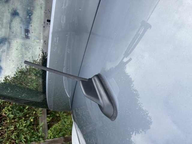

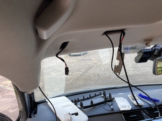

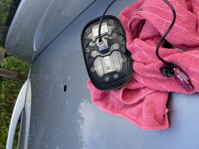

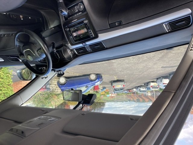

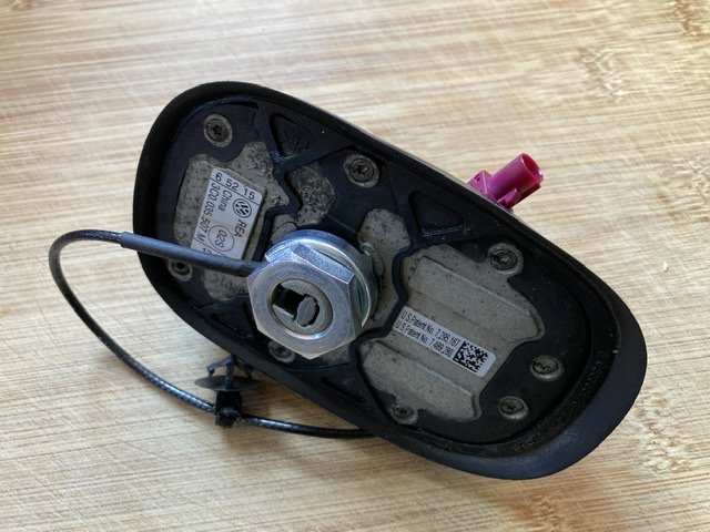

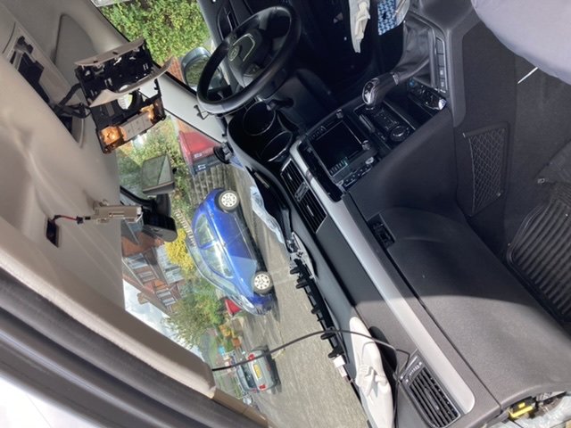

  18. To confirm you do indeed need to remove the rear grab handles to drop the roof lining enough to get my arm in to undo and disconnect the old shark fin antenna. Wonderfully the old fakra lead is clipped to the roof and that needs to be pulled out carefully with pliers. You have to be very careful pulling the roof down or you’ll get a crease by the grab handles. I cleaned the area under the old antenna and refit the new fin. I tightened up using an adjustable as it gave me better control your mileage may vary. It’s ten times quicker to rebuild the car once you’ve had it carefully to bits once!
  19. While I am at it, a thread on how the grab handles come out, which I am doing to ours

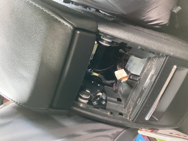

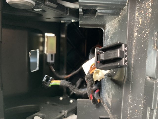

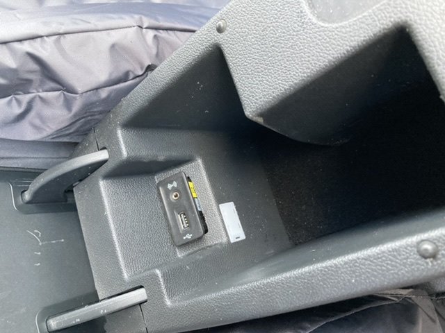

  20. I can't edit previous threads and posts above to amalgamate research for anyone else going from a stock Bolero radio with premium bluetooth to a MIB2 PQ upgrade like me. So apologies but here's my brain dump of useful threads and information I've gleaned from folks so far. Details on centre console and bluetooth wiring: Details on different aerials and the roof liner: Lots of research and reading in relation to the MIB2 install: Differences between the aerials: My parts list (mostly bought off eBay): I bought a genuine USB and AUX cable: 5G0035222E I picked up this roof antenna (intended for a VW I believe but cheaper than the Skoda alternatives): 1K0035501H . It appears to be identical to a 6R0035501D with the 1K prefix being VW with 6R being Skoda. Microphone replacement cable from roof to the radio: 3B0035711B I used a radio surround from Connects2, part number CT24SK12. I am waiting on my 5Q0035726E USB socket to arrive as the one I have is for charging and probably USB sticks only. I need the 'E' USB socket to support Apple CarPlay and Mirrorlink. This then fits inside the USB/AUX socket I already have which is a 5G0035222C / E5638 and is now mounted in place of the now enlarged original factory AUX socket in the arm rest cubby. Map SD card is a 5NA919866AR with latest 2020 maps (AS 1430 maps V12). I picked my own Amundsen 2 from https://retrofitsw.co.uk which was ready to go from out of the box. Now that I have half the rear boot supports down I should be able to remove the rear grab handles and drop the rear liner enough to get to the antenna and swap that out tomorrow. Some notes I made today: The rear support inside the radio mounting cage needs to be cut back if you connect the USB cable as the socket bumps against the back and holds the radio out by a 1cm or so. I dremel'd the right half of the support back on mine. You don't need right angle fakra connectors for the GPS and DAD hook ups, there's enough clearance at the back for a standard connector. You need FEMALE to FEMALE fakra cables to run from a standard antenna to the radio. I bought extension cables and had to get an extra adapter to swap the genders at the radio end. Disconnecting the passenger airbag on/off warning light or the airbag disable switch in the glovebox with the ignition at any point live (say you power it up to test the radio) will result in an airbag warning light that you need to clear with a DTC clearing supporting device such as VCDS/Vagcom. Both items need to be disconnected if you pull the glovebox and swap the radio fascia.

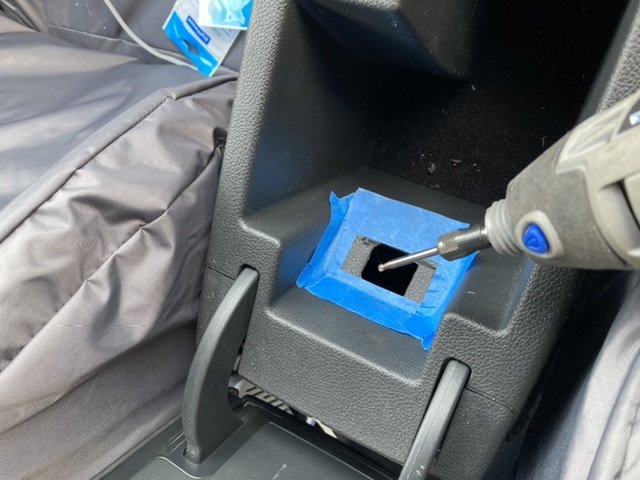

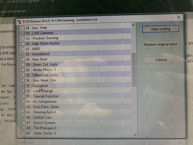

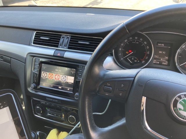

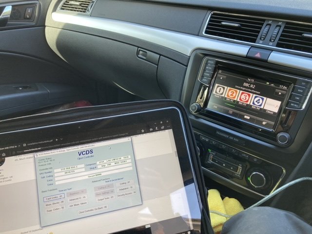

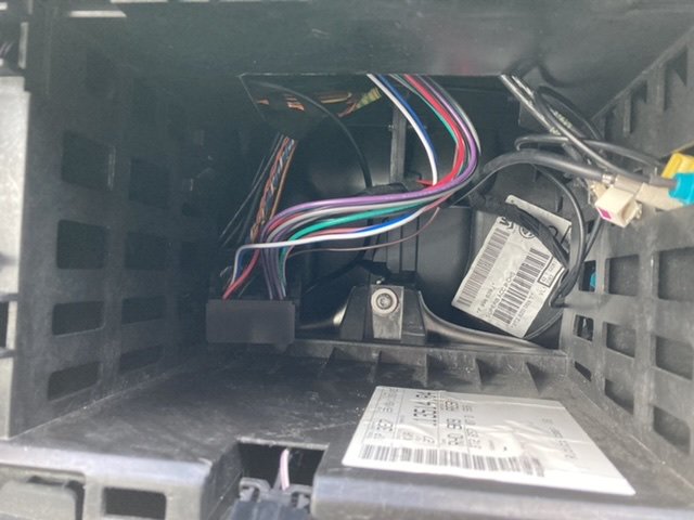

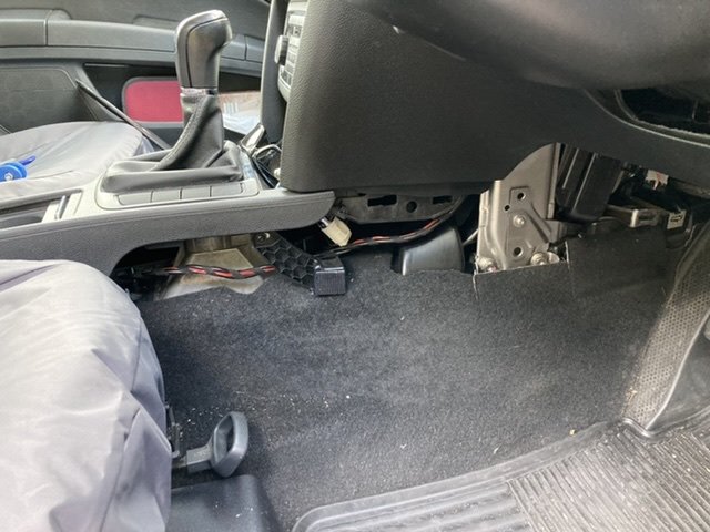

  22. So new MIB2 is installed. Ran a new microphone wire from the headliner to the unit as my old setup went to the Bluetooth module under the driver’s seat. Ran the USB wires to the old aux socket under the centre console and cut the new socket hole. Ran two wires with fakra connectors to the rear of the roof. On the VCDS front I physically disconnected the old Bluetooth module, enabled the speakers and turned on navigation in adaptions. When I get a moment I will cross reference all the threads that helped me and the gotchas I found.
  23. Found the two Velcro tabs at the rear by the door rubber, but looks like the liner won’t pop down without the C pillar covers coming off. Anyone got a line on how they come off?
  24. Ah thank you. Where is the Velcro roughly? No dog guard installed, didn’t want to force it and crease it all!
