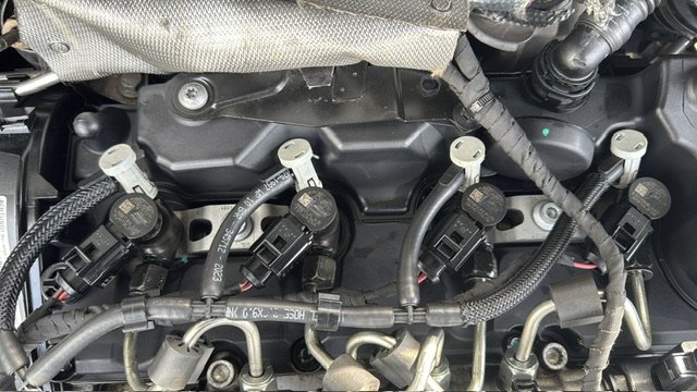

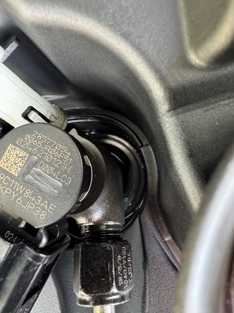

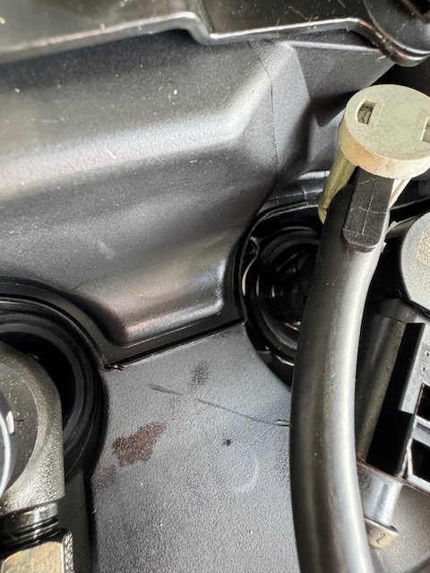

  1. Just a quick update. I ‘ve had the fuel lines (injector loom) to the injectors replaced but that didn’t change anything. The seals and washers for the injectors have been replaced (twice now) and the plastic rocker cover or cam cover has now been changed. This included a seal set, gasket, new oil filler cap and all washers/orings. Looking at the engine from the front the two left injectors remain bone dry. The well nearest to the oil filler is pooling a little bit of oil again. Most of the oil is on the left of the pairing that recess (number 3?) injector but 4 (nearest the filler) is wet too. After a 50miles round trip there a few ml of oil. Does anyone have any advice of where to look now? Small aside anyone have any idea why the previous garage has rubbed off details at the top of the injectors? Here’s some photos of the current oil state:

  4. We have a 2008 Karoq 1.6TDI and there’s oil pooling in the injector wells on top of the valve cover. The oil seems to be starting to pool near to the injector nearest to the oil filler. I have had the injector seals and washers changed for new ones but it still persists. I have also swapped the injector loom as there was a little diesel mixed in it. That’s now cured but the oil is still appearing. It’s not a fast leak, about 1ml a mile. Has anyone else had this? I’m led to believe that the rocker/valve covers can crack and cause this. It is my next port of call. I can’t see anywhere else where the oil would get from the engine to the top cover.

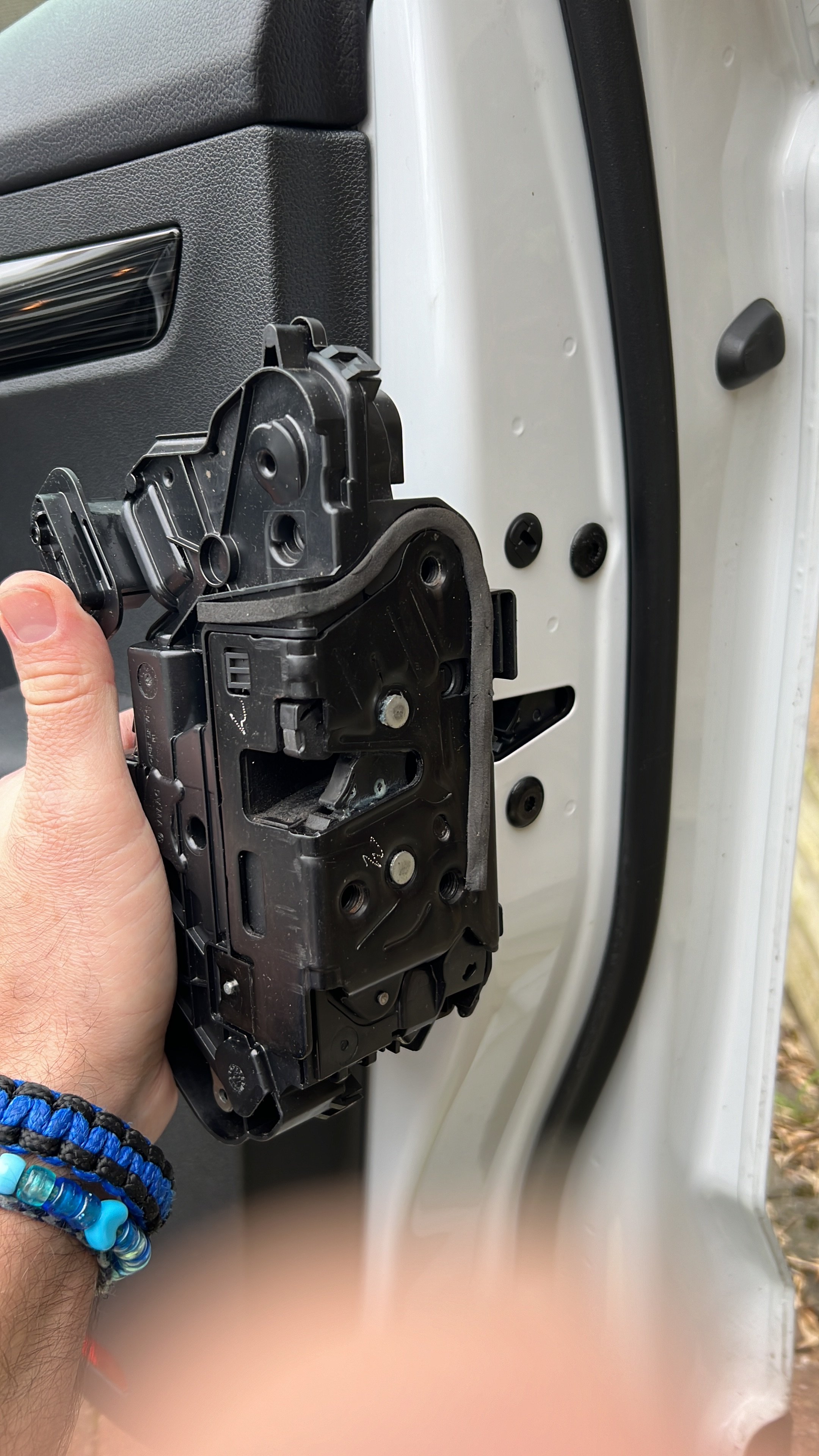

  7. So I can confirm our part number was indeed the non suffix version 5TC 837 016. There’s a decent guide on the door card removal here however it’s a bit short of some details: The removal of the door lock cylinder means removal of the black bolt and unscrewing the smaller torx and then pushing the screw inwards. This is shown here on a similar car: You’ll also find that a wiring loom is attached on clips to the door lock itself. These need to be carefully unclipped to extract the door lock. I am still none the wiser what has been done on the new versions of the lock and what the differences are. I may well take this faulty one to bits to see where the flaw lies. I bet there are micro switches in there that are broken or shorter.

  9. Having what appears to be the usual KESSY and door lock problems on a 2018 Karoq. Door locks seem to go into auto lock spasm mode when driving away and car will randomly lock sometimes when the door is open. I am going to plug in the diagnostic to see if any lock faults are shown. I suspect I know which lock it is. Is there an official diagnostic method and does anyone know the correct door lock part numbers? I gather there’s an improved lock mechanism? My front right (driver’s door) is shown as a 5TC 837 016 D on SkodaParts based on my VIN. Does anyone know the part numbers and if there’s an improved part? Reading around I see there may be and a cover piece that needs swapping if I do that. Anyone know for certain?
