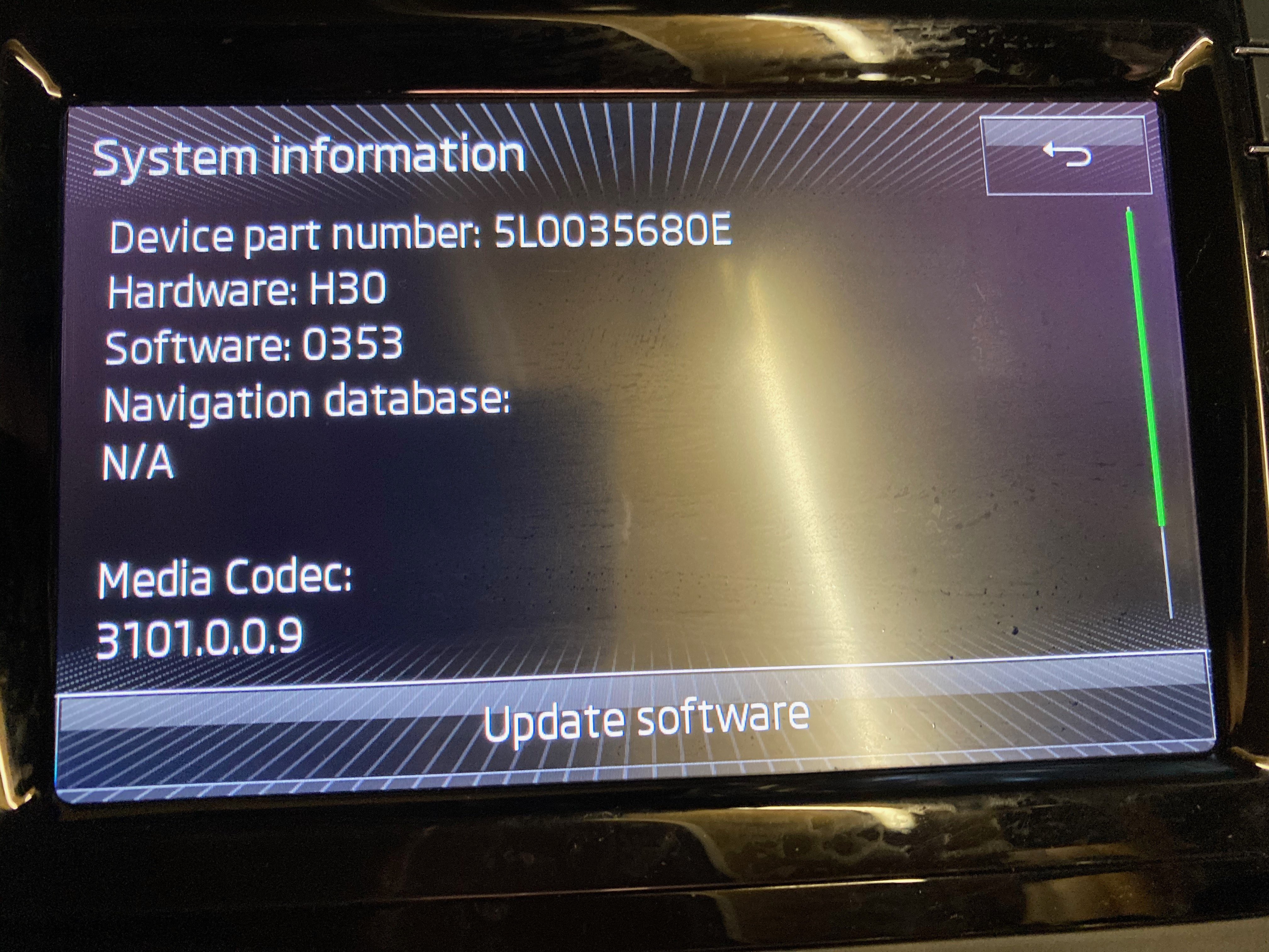

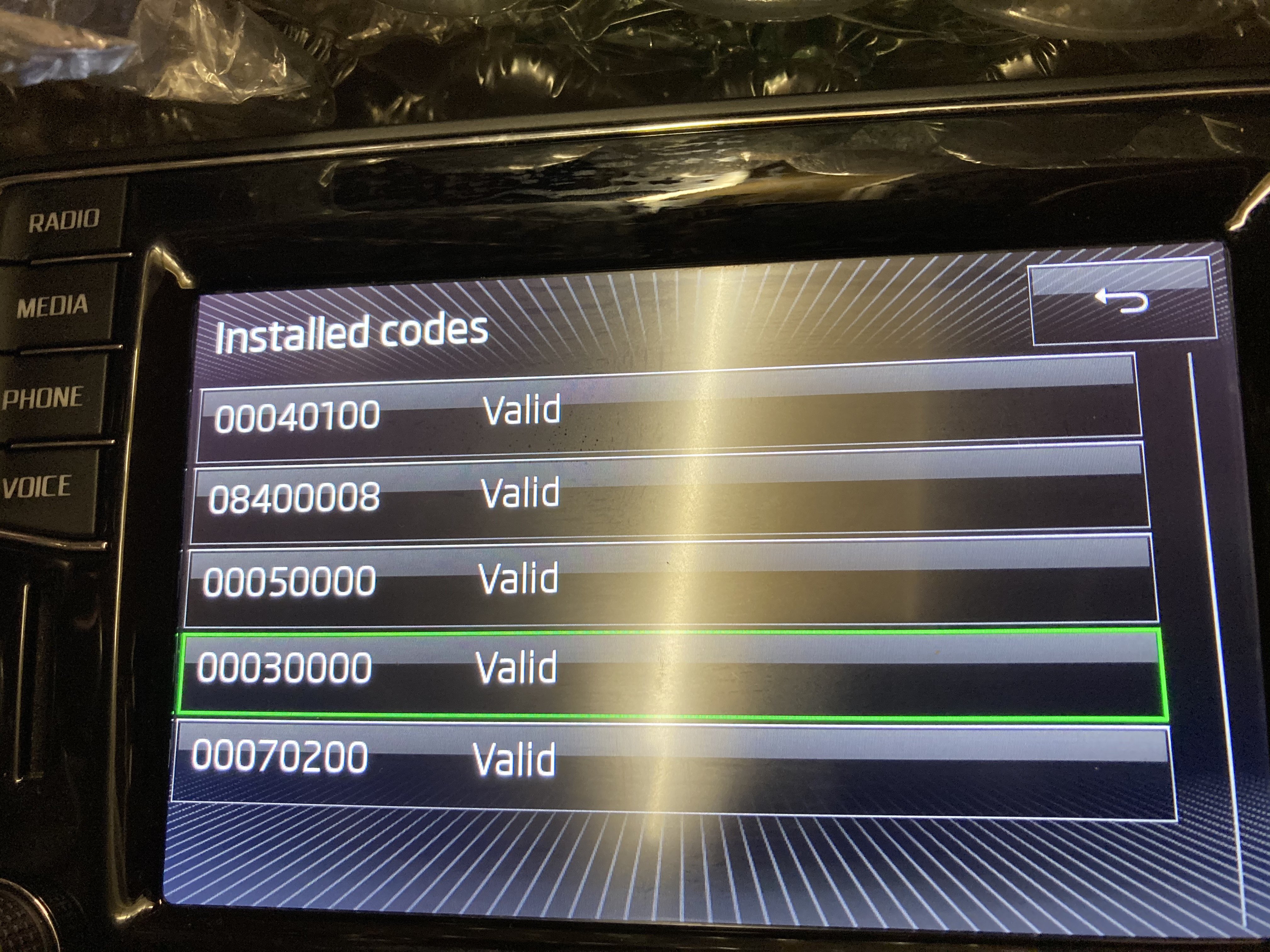

Tried whilst holding the case on either side with one of both bands, no great improvement sadly. I wonder if there is crap in the bezel/tft area that's causing issues. I may well look to see how the screen surround comes off so I can get in there and clean it all. Had a quick dig around to see what version and installs are in there.

I sourced a Skoda Yeti radio from a 2014 model, part number 5L0035680E. Hoping I can grab the matching gateway as well. Where did you get the Aux bits and adapter cable etc for yours? I have the Bolero unit which is coming out to be replaced by the new one. Just wanted to make sure I collected the right bits now as well as hooking up an DAB antenna somewhere. Need to find an auto tech to sort the radio before I plug it in though!
