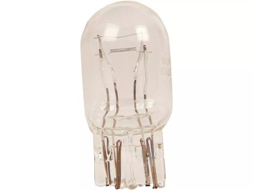

  1. Hmm, that does look like the power wires are offset, which is right, and what I was curious about. They are a bit thin though compared with standard filament ones, which look 'doubled up', but I can't see that it would be a lack of contact that is causing the issue.... Unless someone tells me I'm wrong, there is not a CanBus system for lighting on these cars, so I think I'd rule that out too..... Honestly, I'm thinking something weird is going on with electrical noise from your new LEDs. LEDs usually do have electronics incorporated in them that act as regulators, so that the actual internal LEDs receive a constant voltage, no matter what your car produces under various conditions, in order to be a constant brightness (and not burn out). The regulator could be the source of noise.... Hard to say. Send them back and a get an eBay refund is my suggestion. Maybe look on Autobulbs Direct for a branded LED. Nice tile floor, BTW.

  6. I've just done a quick search, and I think the DRLs use "580" bulbs, which are 21W / 5W twin filaments.... That's how they can be bright or dim - they get switched depending headlight on/off or sidelights on/off. Your LEDs probably should be LED 580 bulbs too, with twin circuits. Check that. I'm still not sure why the rear lights go out! Do the sidelights work as expected when using the LEDs?
  7. Interesting point about DRLs being bright (no headlights, no parking lights) compared with being dim (headlights on or sidelights on indicator stalk)..... I just checked mine, and it has factory LED DRLs which do appear to go dim when headlights are on (needs ignition on) or when a sidelight is on (indicator stalk set L or R, and ignition off) as said above. The interesting point is if you have filament bulbs for DRLs, how do they achieve hi/low brightness. I don't know, but there are several possible way to do this - 1) Switch between 12V and say, 6V to feed the lights - but this doesn't seem likely to me, or 2) switch the bulbs from all in parallel to pairs in series and then have the pairs in parallel, or 3) Switch in a resistance to limit the 12V feed to the bulbs, which seems inefficient, but is a common thing to do for heater fans!, or 4) Use twin filament bulbs with each filament being a different brightness, or 5) feed the bulbs a PCM signal and say 50% duty cycle to reduce brightness. Not all of these schemes are likely to work with LEDs (unless the original system was designed with LEDs in mind), although 5) has a good chance. Nevertheless, it doesn't really explain why the rear lights go out when the headlights are on! I'm thinking your LEDs are noisy and upsetting a relay.... Send them back.
