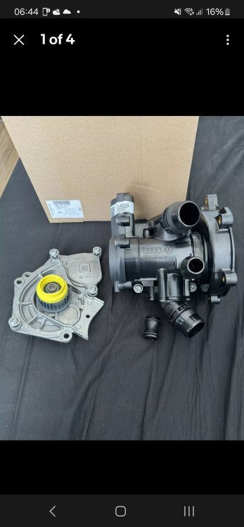

Seems pretty fair. It is a fair bit of work. That is the book time I expect.- Dreaded water pump issue
It's very unlikely to be the waterpump on its own. What they mean is the thermal management control unit and the waterpump assembly. Ina sell them together (oem supplier) vw sell them separately. Given amount of work to get in there you wouldn't normally replace one without the other. But the TMCU is the pricey bit as well as time.- A few issues... Mk3 vRS
