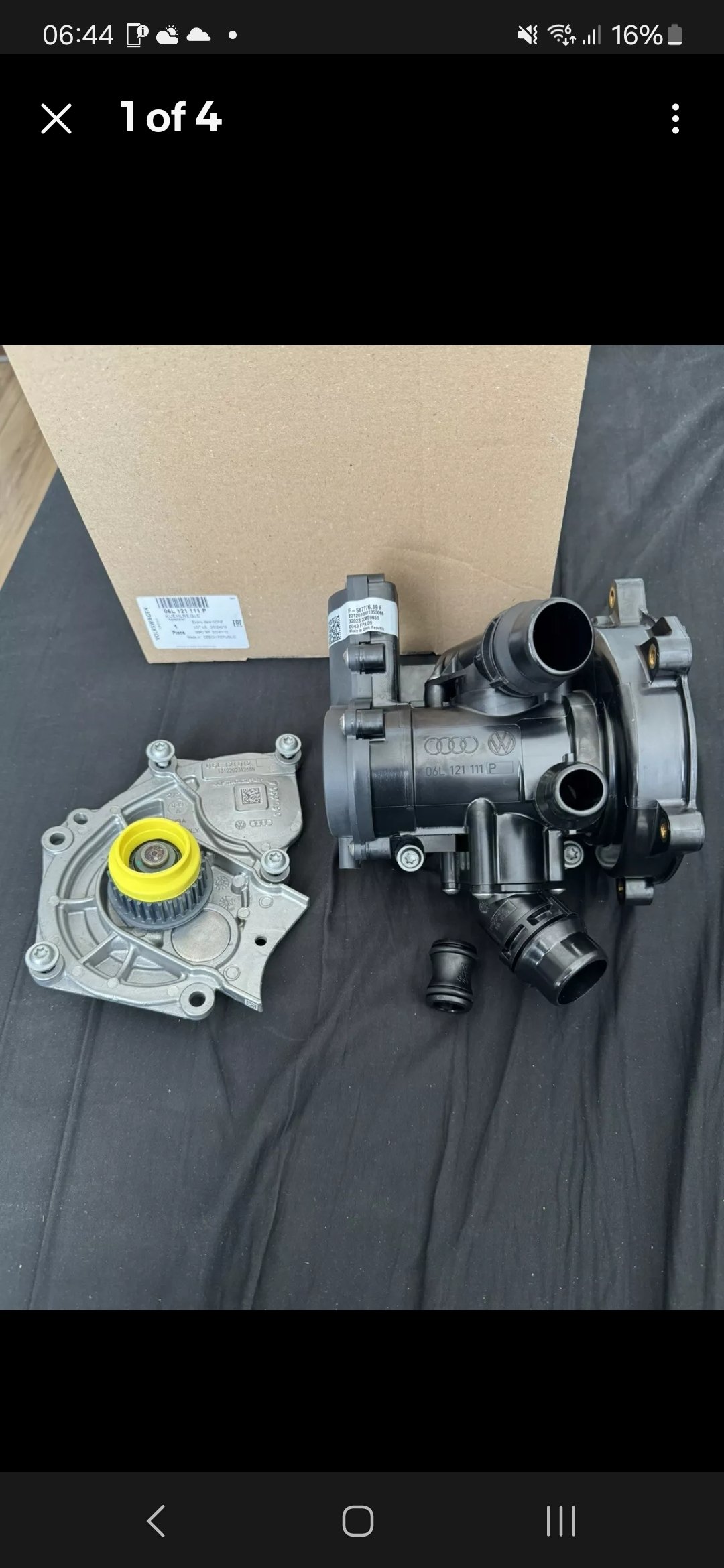

Coolant leak from auxiliary water pump
TheClient replied to Crayon_UK's topic in Skoda Octavia Mk III (2013 - 2020)
Yep. Main water pump and thermostat assembly of those part number. £830s very reasonable. Something obviously got lost in translation including “auxiliary” in the service advisory. -
The only belt driven pump is the main coolant pump. There is one electric aux pump for the inside heater matrix from memory. It is visible front right hand side of engine over from besides battery box area. Close to the turbo it has silver foil insulation jacket on it. They also aren't cheap but a lot less getting to, so less labour if that's the issue. £830 sounds decent price for the main water pump which, based on description I'm inclined to suspect is faulty.. -
