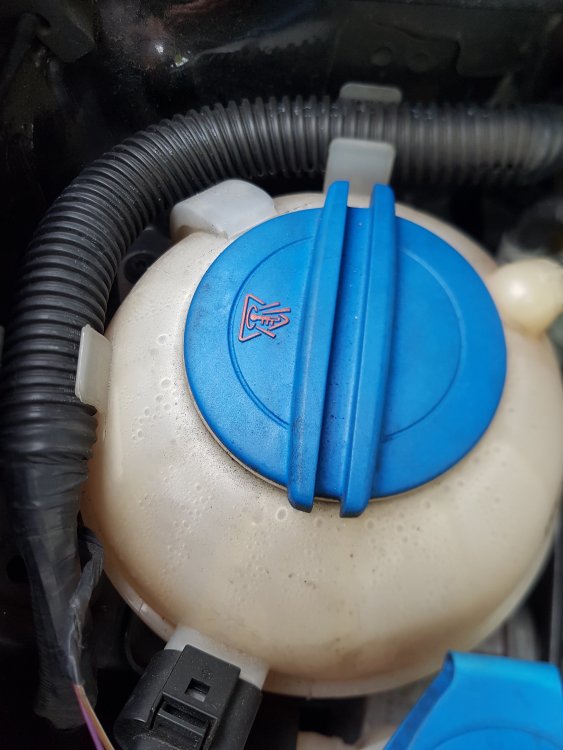

  7. The black cap looks more like the genuine design. Is that the original? The other thing to check, apart from the usual hoses, if it is still leaving puddles is the actual reservoir starts to get cracks in it and can start to leak with age.
