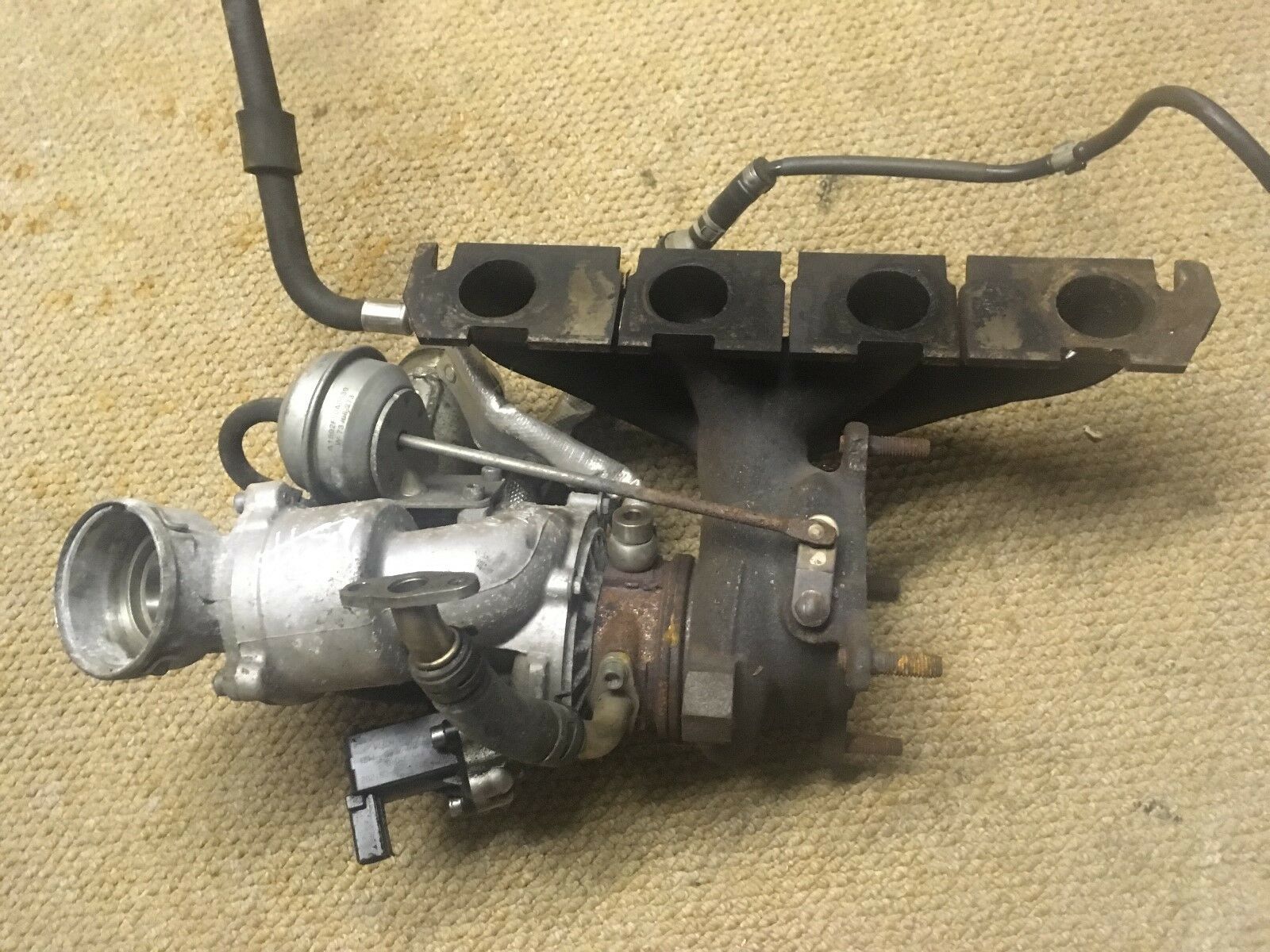

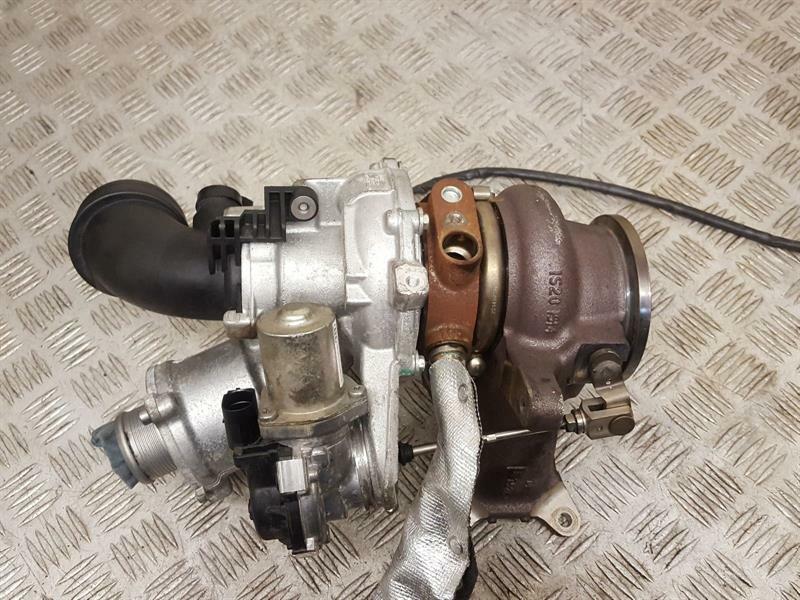

Wastegate Rattle
.I think it's possibly a mutual mis understanding of what each other is saying. There was a clip available for the gen 2 ea888 as in mk2 Oct Fl, golf gti mk6, audi q5 et al. But the actuator design is different I believe. For one thing the gen 3 uses an electro mechanical mechanism where as the gen 2 was vacuum. Is the car under warranty? If not, is probably put up with it unless it is so sloppy it indicates a failure Ps. I own a gen 2 and installed the clip within a few weeks of buying the car used at 34k miles. So I know the annoyance of the sound. Gen 2 EA888 IHI RHF5 Gen 3 IHI IS20 The gen 3 actuator coupling to the wastegate arm looks much chunkier.
