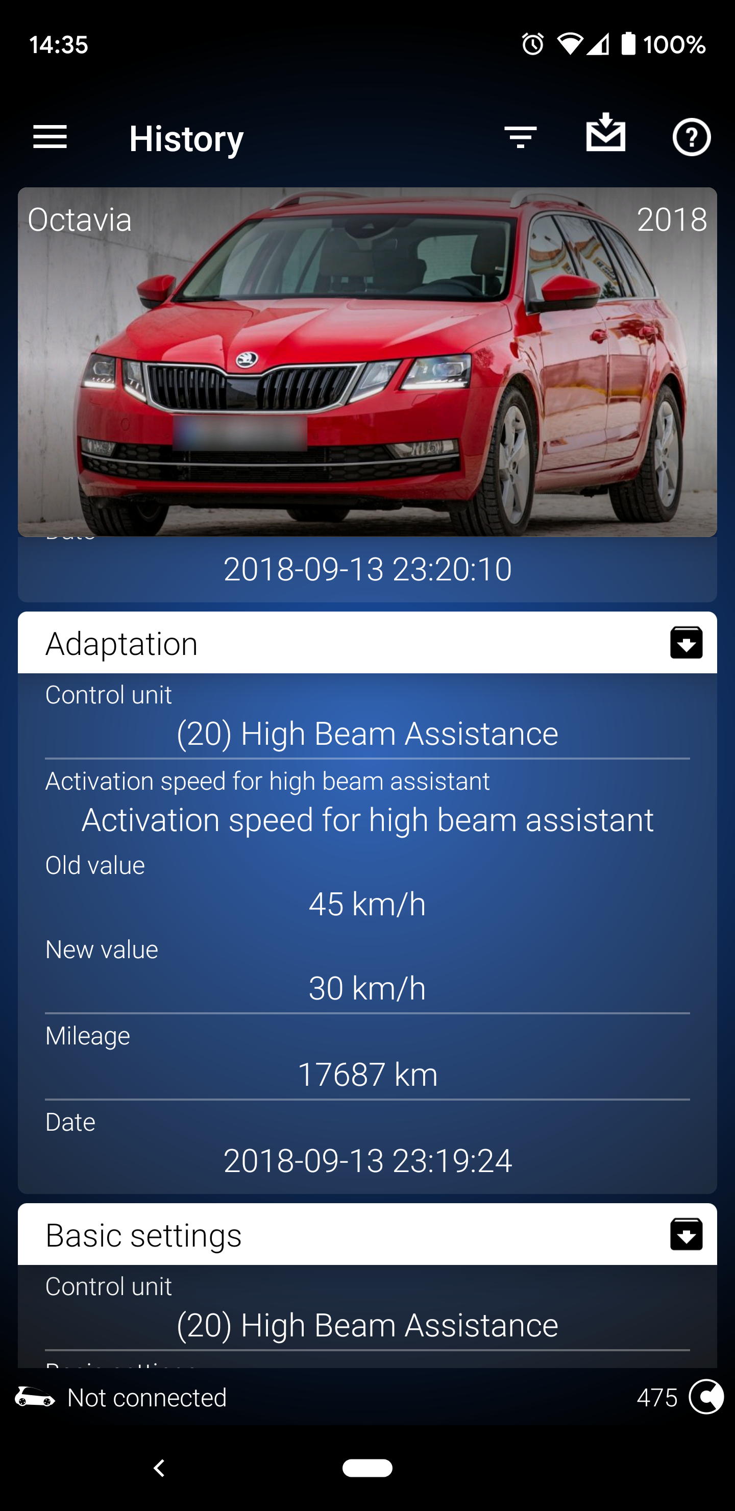

 And another one with the front lights is that you can change the mph threshold for the full beam activation, basically because (when I travel to work, currently I'm WFH still since march) I travel a lot of small country lanes to and from work, so I have reduced the mph threshold so the full beam comes on at a lower speed, rather than the factory set speed, iirc it's set at 40 ish plus mph
Hi Stonker.  I have an OBDEleven and would love to know how to do this.  I agree the threshold is too low - sometimes I find myself accelerating up to 38 mph/60kph just to turn on the auto full beam.  I have a 2017 Octivia 2.0 TDi.  Can you point me to the info I'd need?  Thanks.  Mark.
Hi Mark, here is a screenshot of the long coding from my history, hope this helps 👍
Hi Stonker.  I did this over the weekend.  Much easier to do than I expected.  Thanks for showing me the way.  Mark.
