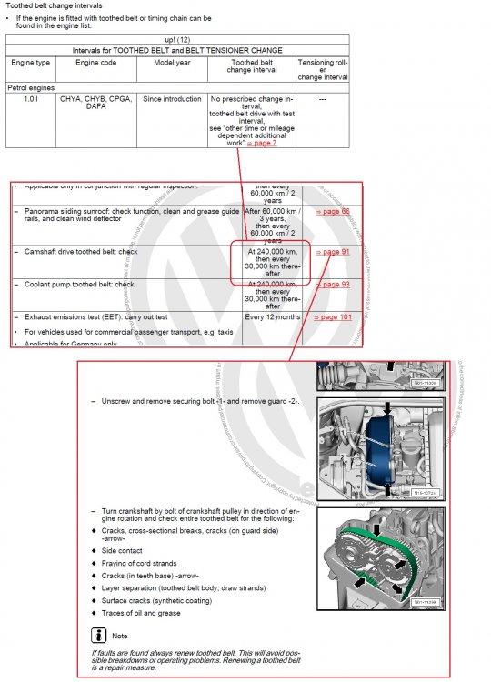

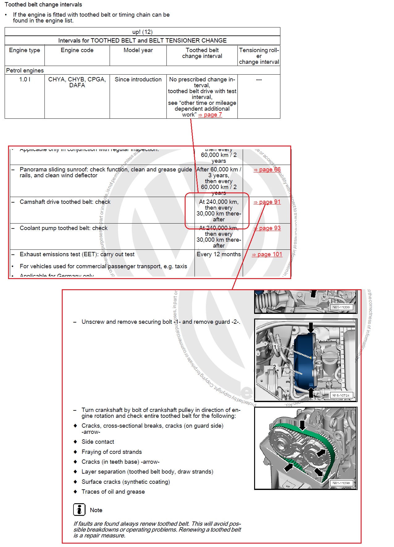

  1. This from VW regarding their CHYA/B Citigo engines. The belt service schedule is to inspect at 240k km (160k miles) and replace if necessary, there is no time limit.
  2. The engine manufacturer of the CHYA & B engines, VW, recommend inspecting the cambelt at 240k km (160k mile) intervals, and to replace if necessary. There is no time limit. All covered in the service manual (below). My 2016 cambelt is on 95k miles and running as smooth as silk.

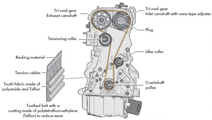

  11. >"Do I need to check the tension on it?" Not in the normal course of operation i.e. the service life of the belt. I'm surprised the belt has been changed on an 2015 vehicle as VW (the engine manufacturer) doesn't have a time limit for the PTFE reinforced belt; and the service schedule states to check the belt after 160k miles (240k km) and to replace if necessary. The cam gears are trioval in design and the belt tension is carried out harmonically at Top Dead Centre.

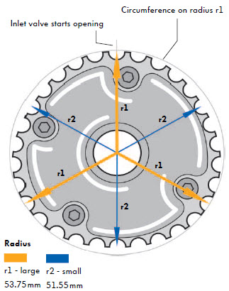

  16. >Sorry if this seems pedantic, but it just sounds so wrong to my ears to hear 'PTFE reinforcement'. The PTFE coating reinforces (i.e. strengthens or supports) the cambelt. The reduction in friction allowed by the PTFE coating gives a cooler running belt which lasts longer as a result. Similarly the trioval cam gears reduce belt tension when it isn't required. And the powder metallurgy cam gear production process gives a smoother surface finish without the sharp edges found on hobbed gears. VW have done their development and recommend the service schedule accordingly. As previously mentioned the CHYA/B belts aren't to be associated with the rubber cambelts of say the 70's Ford etc. All that said, if owners wish to choose a different service schedule than specified by the designer/developer/manufacturer, that's their choice and one I respect. But, there's no engineering reason to do so. So all the single parents out there on a very limited motoring budget (myself included) can rest easy knowing the cambelt doesn't need replacing at 60k/5 year intervals as advised by some Skoda dealerships. Respectfully yours...Snaefell (2016 - Citigo Colours currently at 72k miles on the original cambelt).
  17. VW don't specify a time limit, only mileage; but at an average 15k per year (approx.) it's good for 10+ years. The cambelt is PTFE reinforced, not rubber like the 1970's Cortina. And the cam gears are trioval in design. All this research and development allows the 160k mile extended service schedule as listed above. It's perfectly acceptable to change the belt prematurely for 'piece of mind' - and if the owner has the money, but it's totally unnecessary from an engineering point of view. My 2016 Citigo Colours recently passed 71k miles on the original belt and I plan to inspect it in late 2023, I'll report back with my findings at that time.
