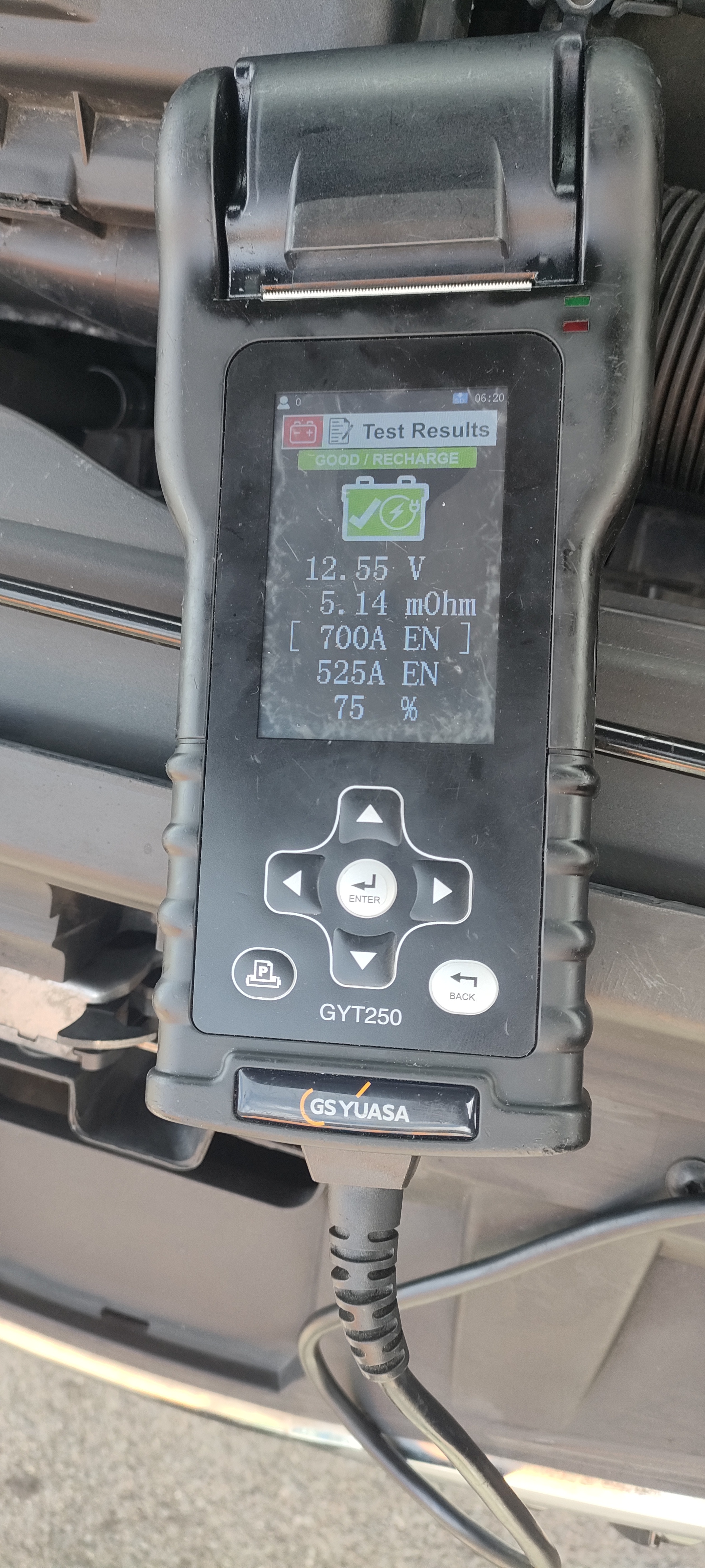

I went to halfords again and they checked the battery. They said battery is ok..may be electrical fault causing start-stop not working. They recommended me to have the car checked up by halfords autocenter. My OBDelevenbis plaing up now . can't diagnose any more..it says 'Device is not authorized'

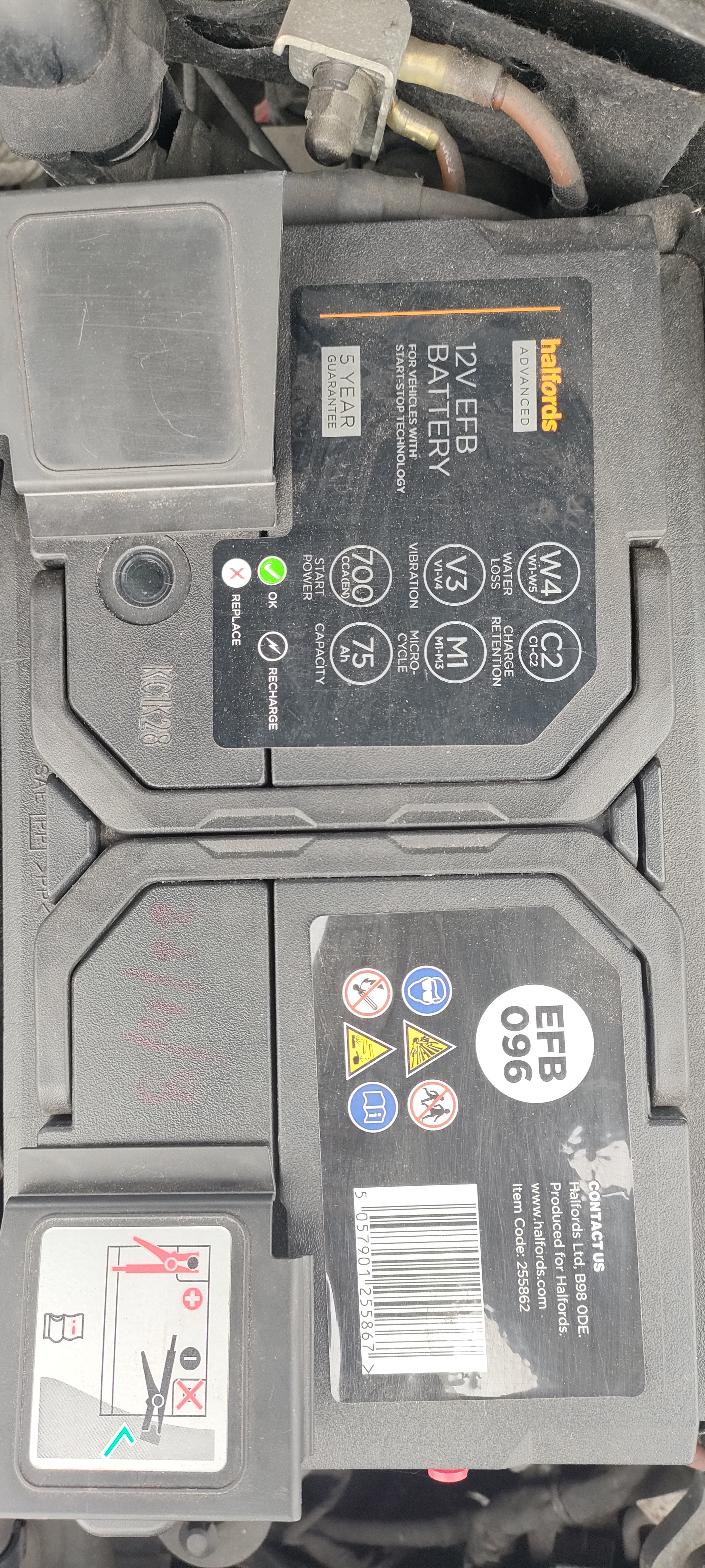

nattery terminals are clean and they are securely tight. no doubt about it. they use positive to positive and negative to negative and asked me to start the car. car started within a second. battery came with 5 years warranty halfords brand. I am just guessing can my dashcam drain out all the juice of the battery ? its a AZDOME dashcam. I've been using it for ages without any trouble and it is always connected in 12v port. nowadays, I can see it gets powered off time to time and ofcourse if i leave the car for long it gets off whcih was not the case previously.- Battery problem again
it's not multimeter. i think basic battery diagnostic tool. I argued with him that as i was driving the car, the battery is fully charged now and hence it is showing good in your system, but he replied this is basic test and that's what they can do. Should i use my OBDeleven tool to check 14.5v. if yes then how? When the car was not starting for the first time in London (Sunday night) everything was working. headlights, interior lights, infoteinment system, car locking/unlocking..basically everything. only thing i saw in the dash was battery power is too low and all the other warning was popping up one by one. Cranking sound but not starting When the car was not starting for the second time in Germany sysmptoms were all the same. Cranking but not starting. as soon as they guy used jumpt starter battery booster, it started straight away.- Battery problem again
Everytime I go to Europe, something has to happen. This time it was one after another. friday we went Main-Taunus-zentrum from our holiday rental in Drolshagen and car battery went flat. last sunday night battery went flat for the first time right before the holiday. I had to call the breakdown to jump start. Battery is bought from halfords 1 year and 4 months ago. I had the battery checked up today in halfords and guy said battery is good, probably alternator or starting motor is faulty. how can i diagnose/check it myself?- False Loss of pressure warning pops up

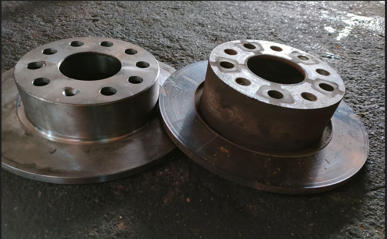

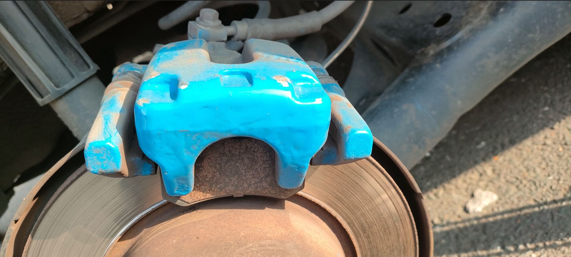

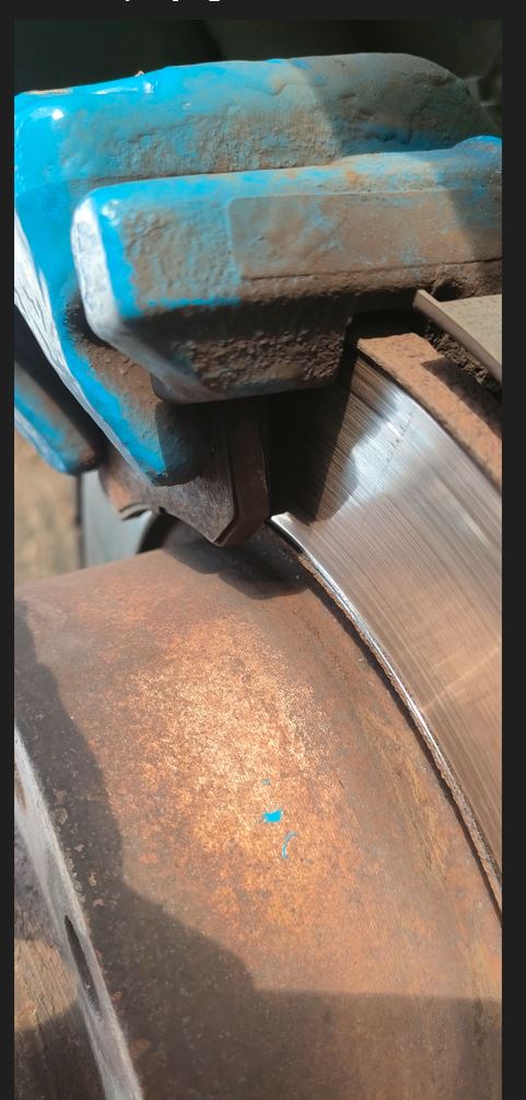

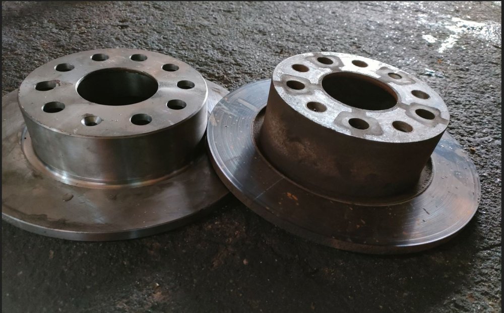

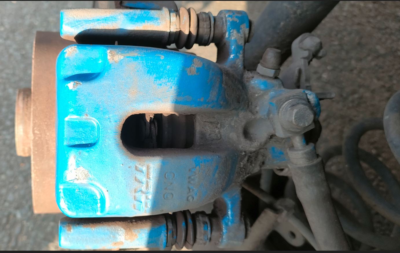

Yesterday I took the wheels off for better look and seriously i couldn't find any fault/damage or whatsoever. Pad has still 35% life left and disk is still in good shape and has good life in it. Well, last night as i was driving, my rear left went over a mini pothole and instantly lose of pressure- rear right sign popped up. I stopped the car and inspected the tyres, but nothing unusual. Anyway,i have decided to replace the rear brake disks and pads and front pads only. I want to summaize my post and needs one last favour from you guys please. Current mileage 96,459miles Rear Brake Pads replaced = 9/8/21 mileage: 51,500 miles (bought disks as well from autodoc but it was wrong measurement), garage guy said my disk was perfectly normal so not to worry. I am attaching the pictures for you guys to recommend the right size. Front Brake Disk and Pads replaced: 4/3/21, mileage: 41,580. still have 30% life left but decided to replace the brake pads only disk is perfect as of now.- False Loss of pressure warning pops up
Wheel has been swapped with front right as i mentioned my post. So, there shouldn't be any wrong with tyre. it could be something else. last brake fluid was changed couple of years ago (8/3/21) though Kwik Fit said it was not necessary, but i had it changed . so it is not that old and i have brake disk and pad checked up during MOTs and every now and then. I am not aware of brakes service annually. I consider replacing any parts as and when needed to keep the car in optimal condition. Last time i had been to the garage Probably two months ago for replacing Coil springs and front shocks, they said Brake Pads and disks are perfectly fine and they have 50% life left. Rear Brake Pads were changed 9/8/21 and mileage was 51,500 miles and now car mileage is 96,500miles.- False Loss of pressure warning pops up
Sorry, it will be Wheels not Tyre Swapping. What is sticking calliper? What should i look for? Does anybody have any picture for me to understand better. Thanks once again - Battery problem again
