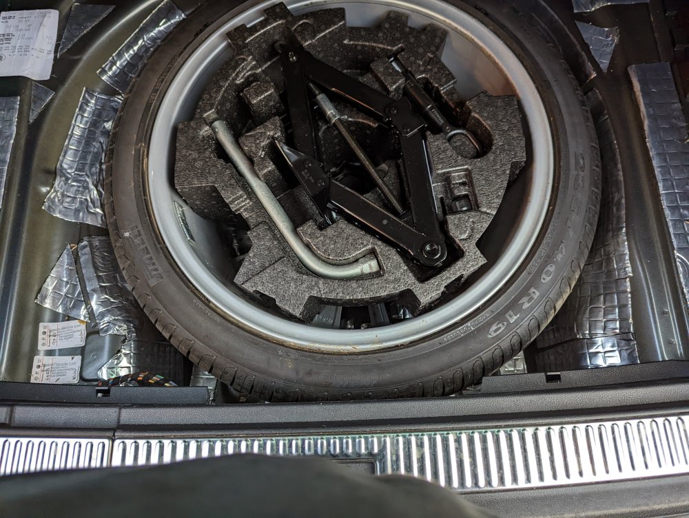

i finally got around (6 years later) to putting the spare 19" full size wheel into my car. its a 280 4x4, so the extra skinny wheel, and the big foam insert from the factory. the rear trim piece pops up easily enough, but I have the factory towbar, so left that connected, and worked away with a snips. super easy job to do, trimmmed up the foam insert, and now i have a full size spare. i also have the variable boot floor, and i had no idea what the hell that was actually for, but now, it takes the slight bump out of the floor with the slightly bigger wheel in place, but the factory tray thing that used to sit into the floor now sits on top of it. i think i could drop the foam insert a bit by trimming the bottom of if with a saw, so I will do that piece tonight and see how close to flush i can get it thanks to the OP for the instructions!

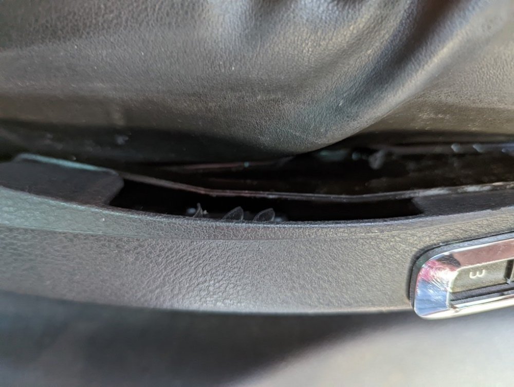

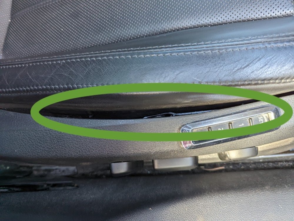

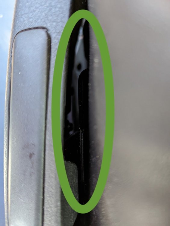

my old superb II combi had an issue where if I was in the car for any lenght of time, my right leg used to get quite numb and then sore when I was out of the car. this was resolved when i saw a thread here about it, and on the back of that, took a pry bar to the metal upside down u-shaped bar that supported the plastic side to the seat with the position buttons on it and moved it about 12-14 mm away from the seat side. I had the same issue on and off in my superb III combi, but in the last while. i've not been driving it much, so had forgotten about it. for various reasons, I ended up driving it a lot recently, and the sore leg came back with a vengance. it felt like somethign was sticking into the underside of my right leg about halfway down the outside of my thigh, and it was sore after about 45 minutes in the car, and stayed sore for quite some time afterwards too. i reckon something was pressuring something in my leg, so i thought back to the old superb and the remedy, so i finally took a look, and lo and behold, while the seat structure is different, there is a metal "bar" there. it is in under the side of the bolster, and pushes up the side bolster of the seat into your leg, pretty much the same as the older model seat did (this pic is the passenger seat for reference). so I reached for the trusty pry bar, and pried that metal piece out about 10-12mm. it gives a lot more space on the side of the seat for the bolster to moved downward, and also does not press up into that exact part of my leg. I dont feel that pressure anymore on the back of my leg when driving the car, which is wonderful! fwiw, this is pretty much the same distance that was available on the side of the superb II seat when the bar was moved out of the way. hope this is of help to anyone getting the same thing
