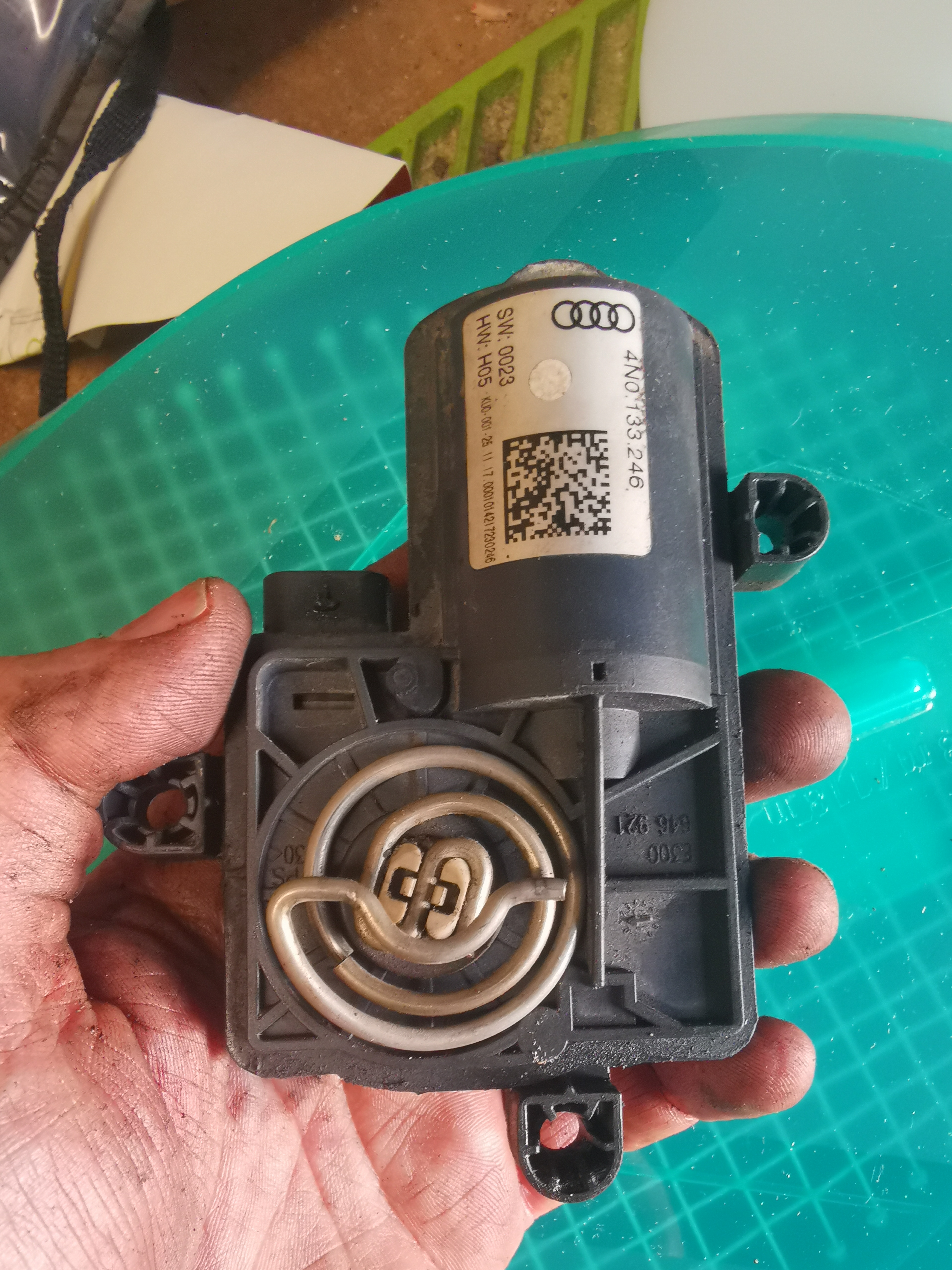

  4. I know I was shocked when it arrived, then I checked ad and it was for one. Should get them cheaper next time though if this supplier can help. Good news is the exhaust is back on, went on no problem today after emery cloth the hanger and then fairy liquid on the both them and rubbers. Fresh muscle this morning.

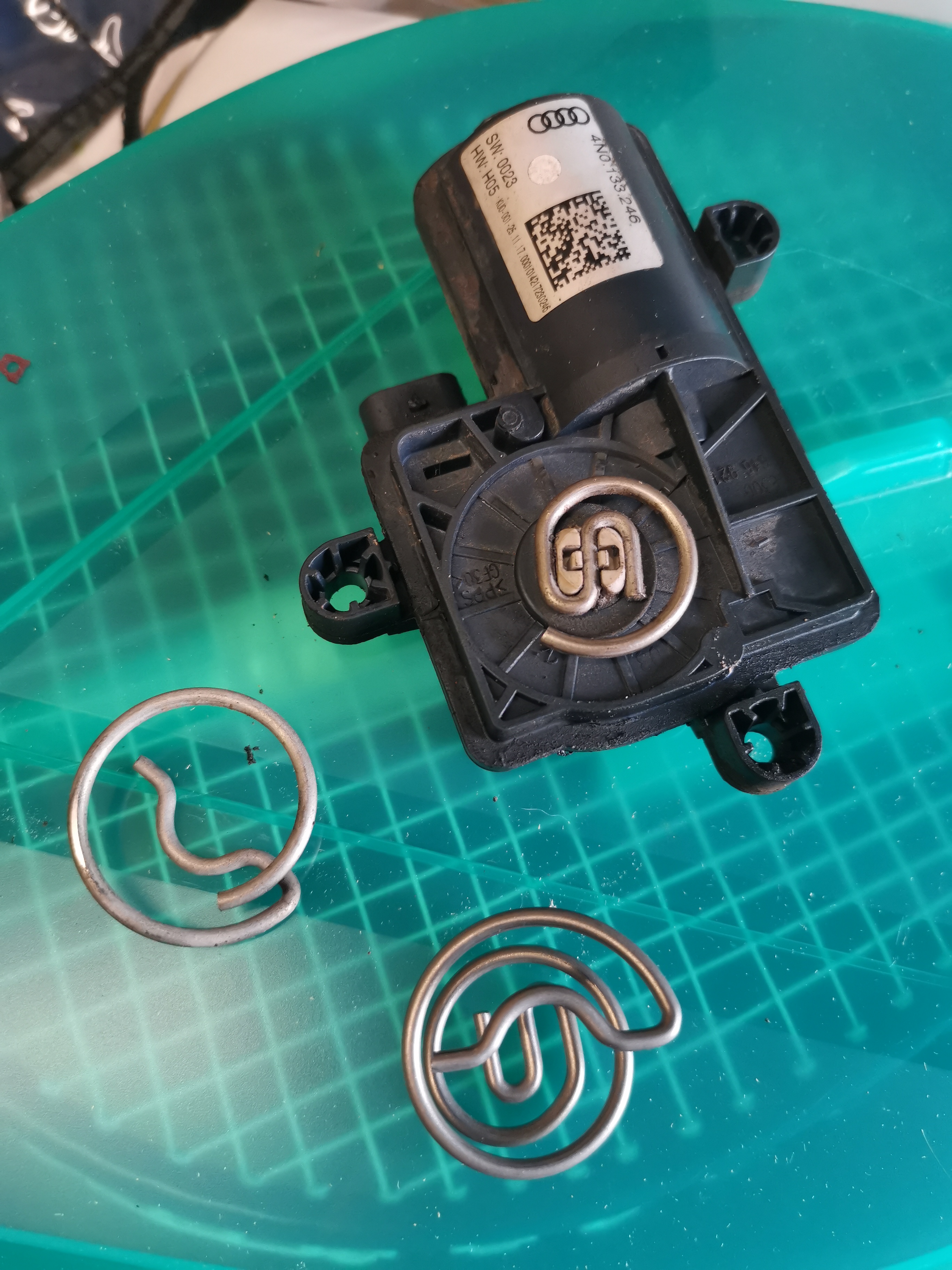

  7. I used some pengaurd on them before dinner but think they were past that point. I'm going to need to find a way today or my car is off the road lol. I have one side up on a ramp of sorts The link for the springs is in this thread, posted by another user. Cost me approx £45 which is a fraction compared to a new unit or exhaust. For sure it's a job you want to tackle yourself or your local garage. Labour cost would be high or they would just tell you it's damaged and needs a whole new rear silencer. Will hopefully have some other options for the spring which I will post up when I get them.

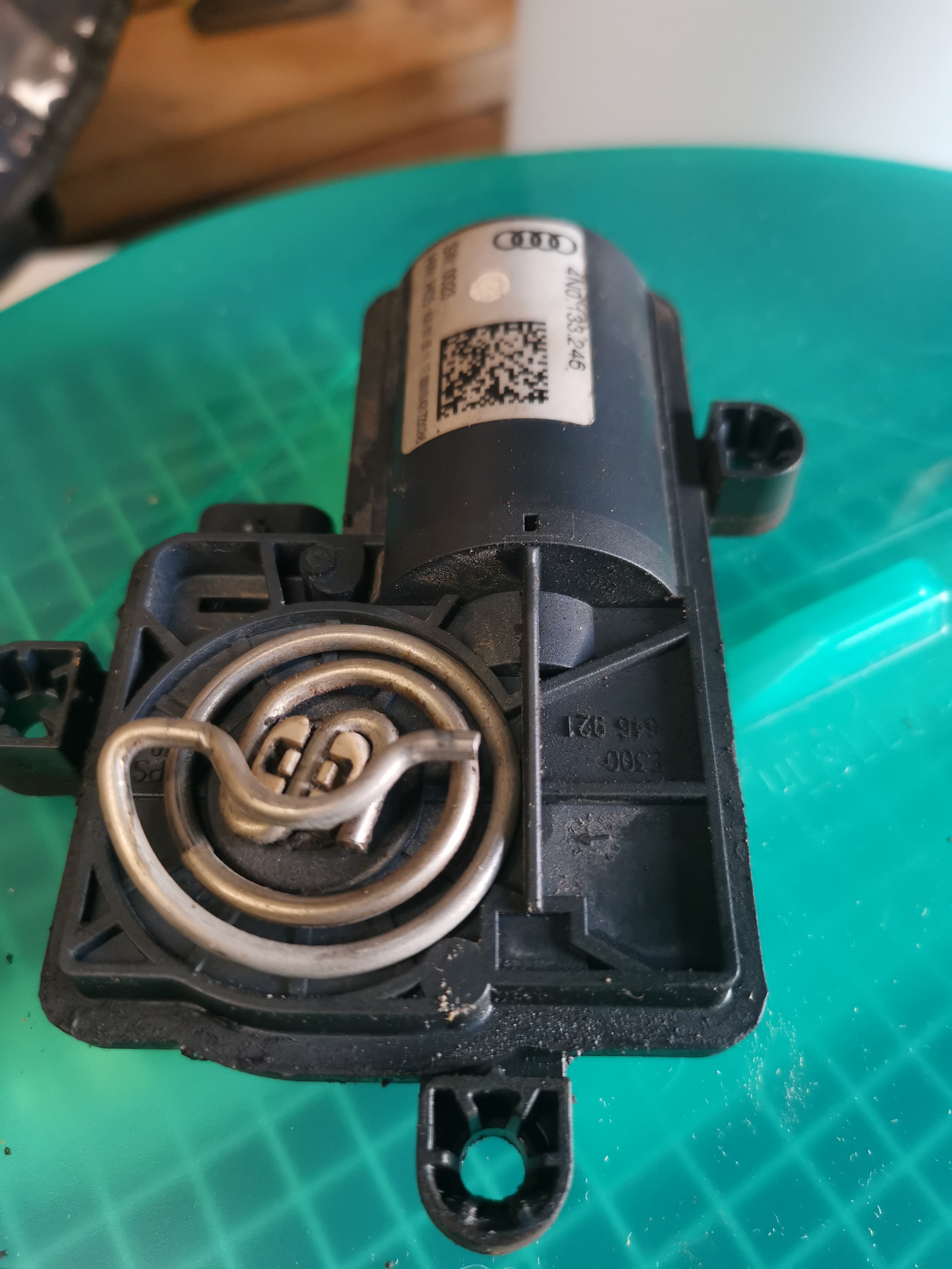

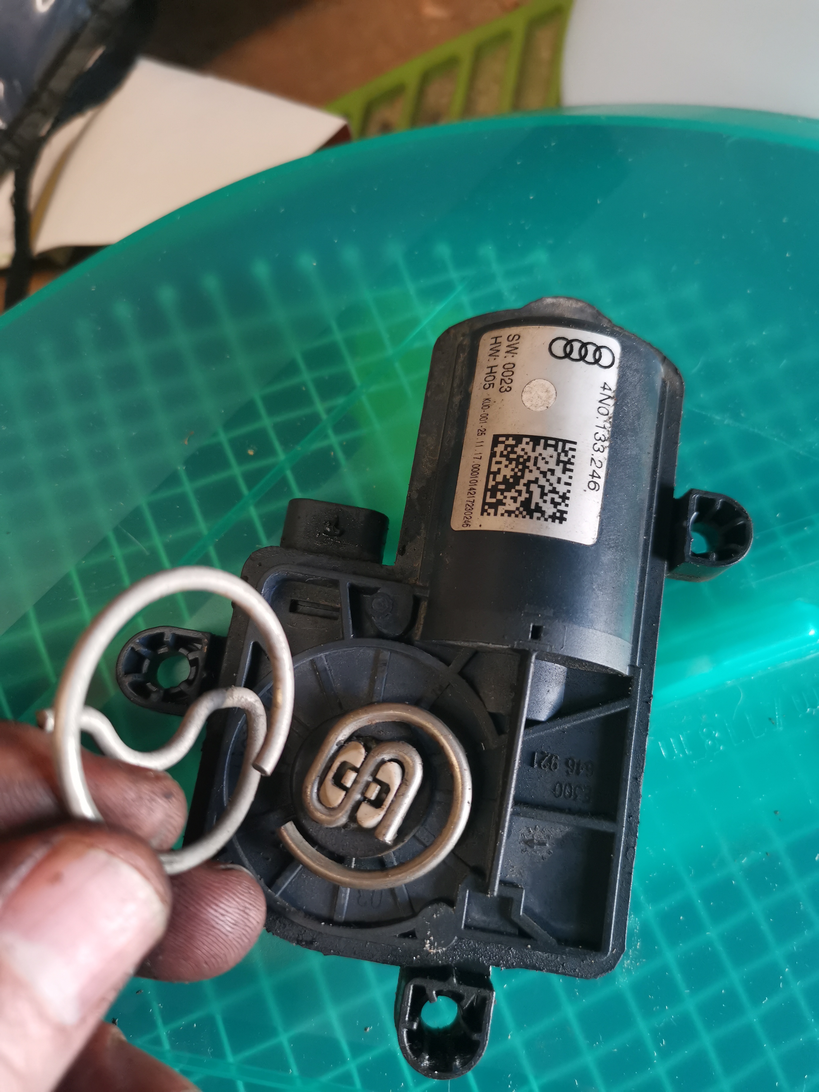

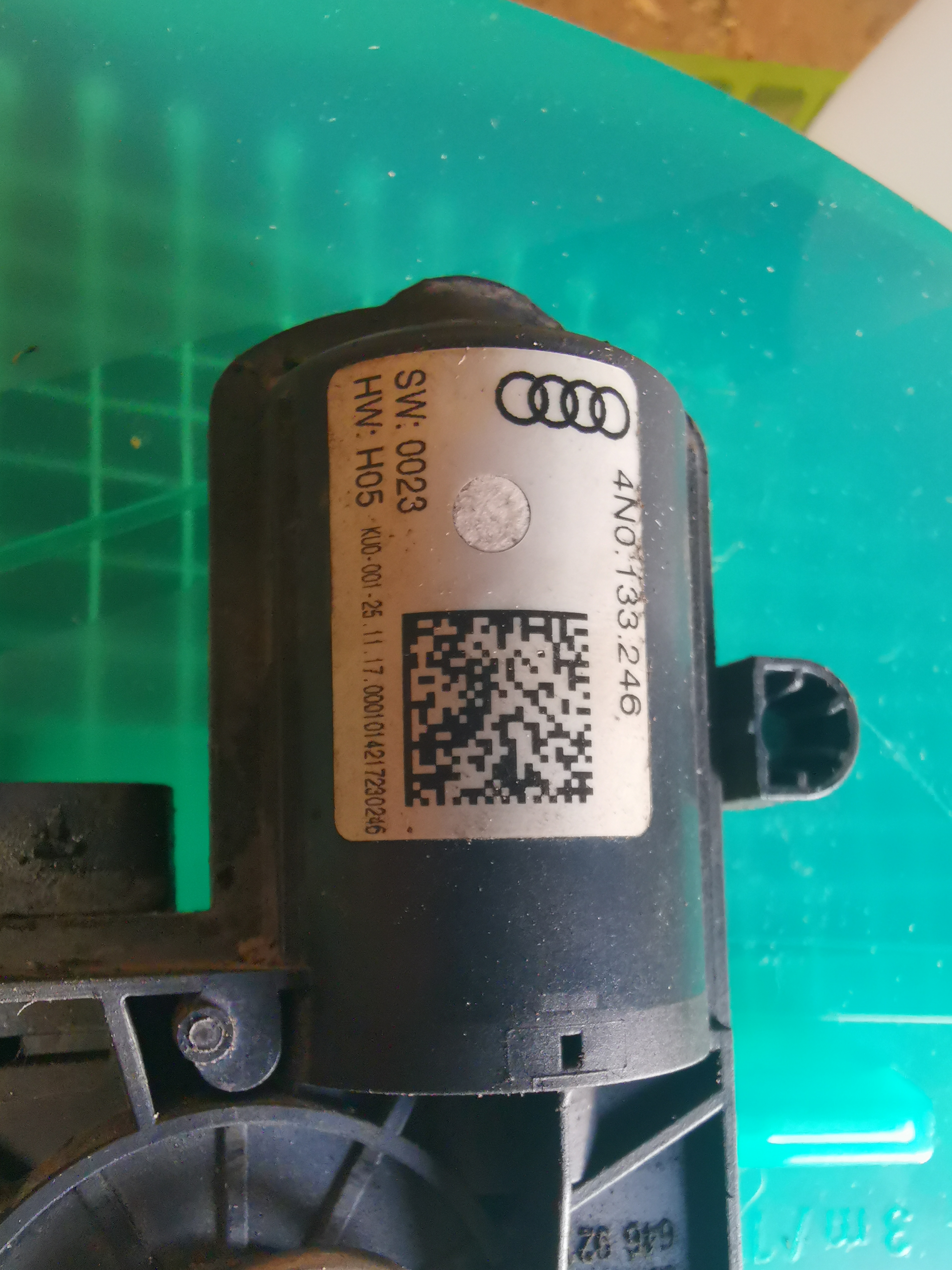

  11. So it's been a while. I managed to get a spring from the US, in that time the other side started making the same buzzing sound. Tonight I decided to take one off and have a look. I had to drop the rear exhaust off the hangers. The actuator is held on with 3 nylok nuts on welded studs that are part of the back box. All but one were badly corroded. 8mm socket got one off. Vice grips gots a another had to dremel the last one. Unplugged and took off. Sure enough spring is snapped inside. Checked the other side and one of the studs snapped. Had to drill it out. Same again, snapped. I'm in touch with someone who might be able to supply the spring so haven't fitted the new one yet. At least I know it definetly is the issue and how to do it. Problem I have now is trying to get the exhaust back on the rubber mounts. Any tips???????? , maybe a little tired now but cant get the bloody things in.

  13. In the last couple of weeks before I get in my car or wen i get out I have noticed that one of the exhaust valves is making a buzzing sound. It repeats this every 2-3 mins. Due to weather I haven't spent anytime on the ground watching the position of the valve. Has anyone experienced similar issues , what should I look out for? Should the valve be open or closed on cold start up and does its position change in sport mode when warm.
